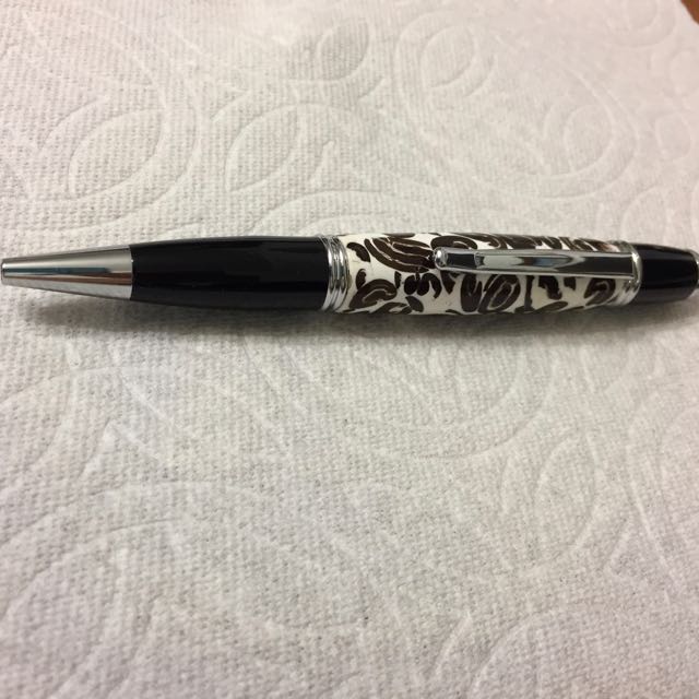

I am guessing it depends on how you "polish" it. If you just sand to a shiny surface on the resin, yes. The beans still have a coffee smell. They can also be scratched, nicked broken, etc. Been there, done that.
If you use any polishing aids as in creams, waxes, etc. I expect you will diminish the smell to some extent if not completely masking it with the compounds. I ended up finishing with CA and people swear they can still smell it. I can't.

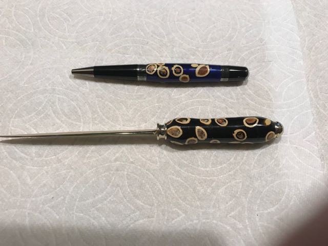

I have mae a lot of coffee bean pens - maybe 30. I make my own blanks. I sell them to help a missionary! All advice above is good. To preserve the beans in the pen - must put a finish on it. Use thin CA during turning to help keep beans in. You will still have chip out or fly outs. I keep a small container of ground coffee next to lathe - when I get a chip out I pack hole with ground coffee and then thin CA. Sharp tools are a must - I never use carbide on these - keep the skew sharp!
I wish there was a way to keep the coffee smell!
