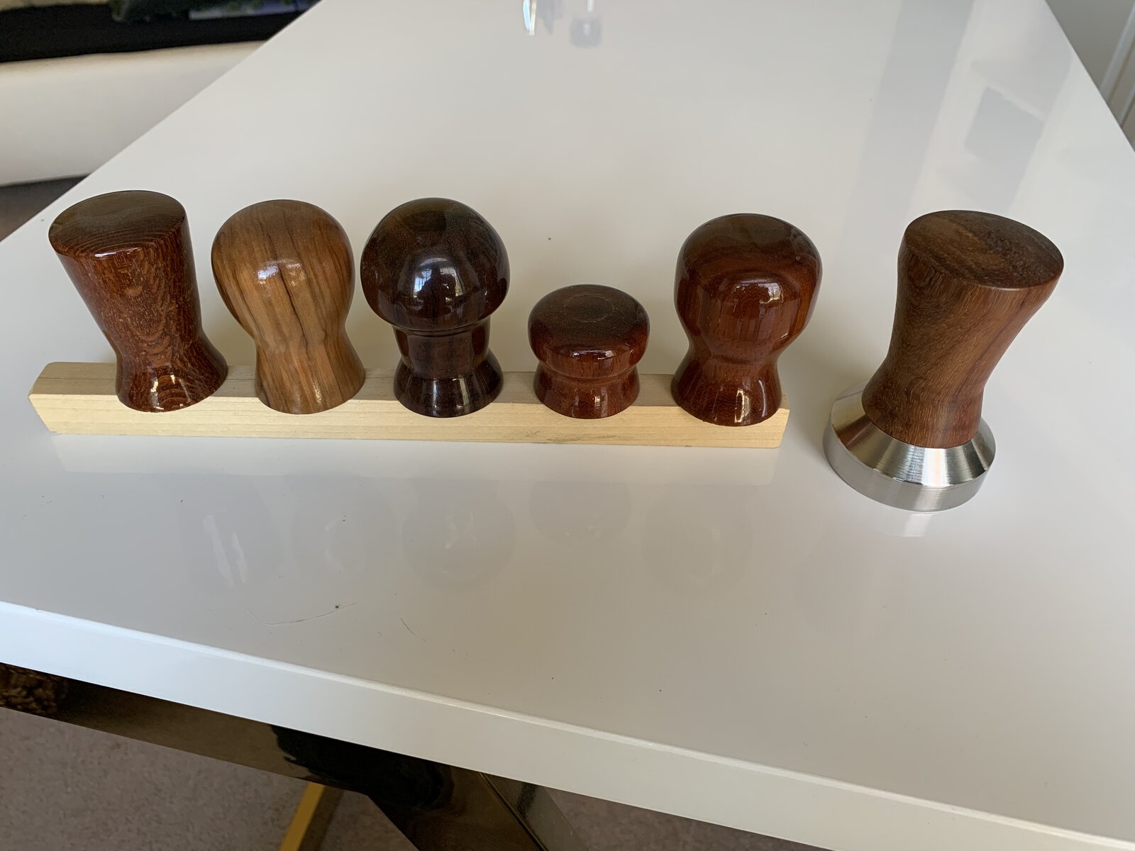

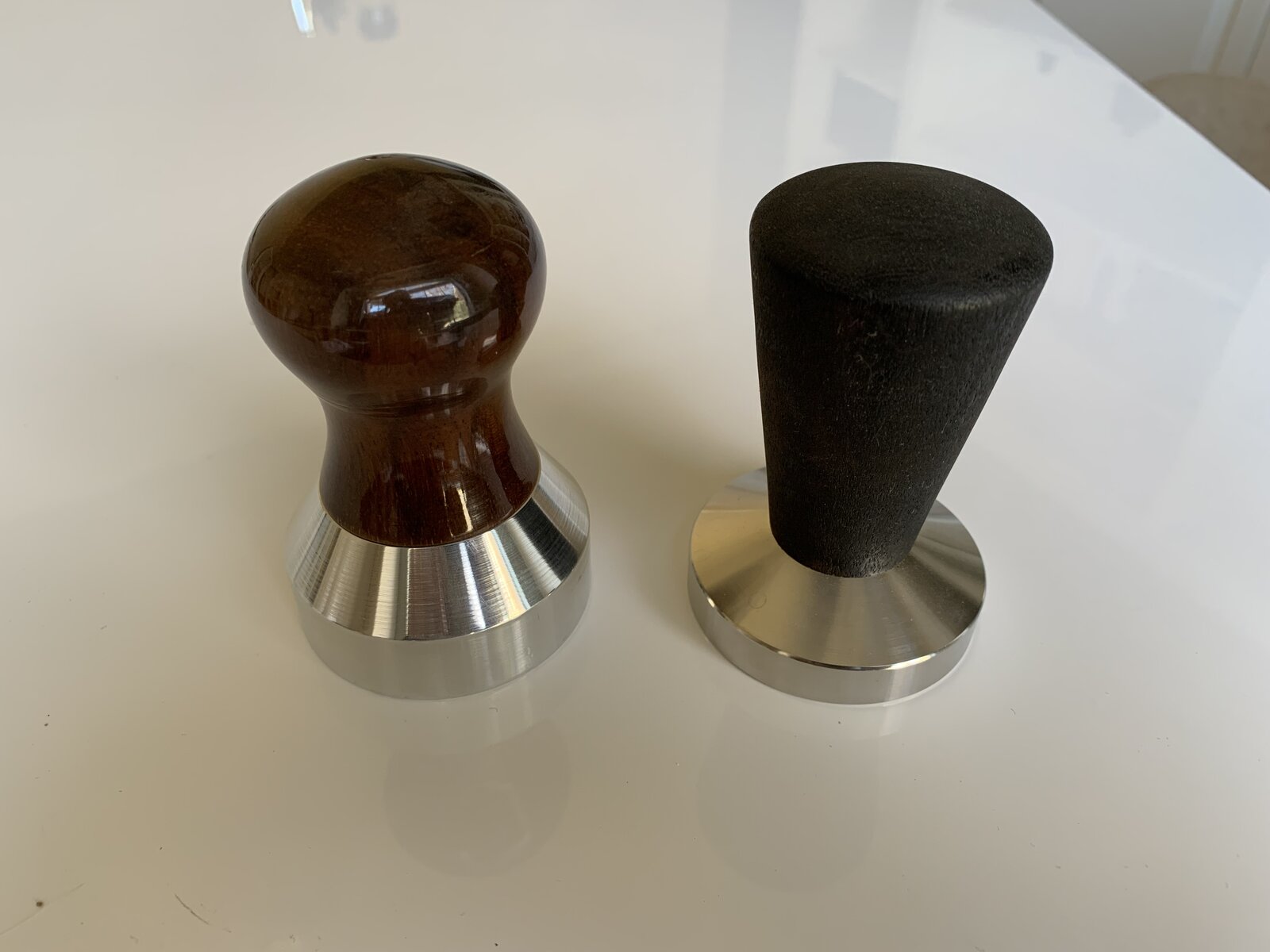

When I made tampers I used two techniques. First I got some stainless round stock and turned the tamper head on the metal lathe. This works, but stainless work hardens pretty easily and is a pain to deal with.
The simpler way is to just get a tamper off Amazon, throw away the handle and make your own. This is pretty cost effective and very simple.
