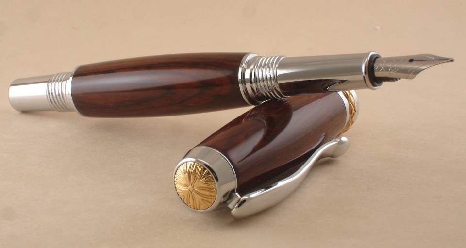

Ti/Gold and Chrome Triton dressed in Cocobolo with 5MM polished Bock nib. Finished using my OMWB poly dipping method.
Very nice!!!!
Would love to hear about your dipping method sometime. It produced a great finish!
Beautiful!....FRONT PAGE PEN!

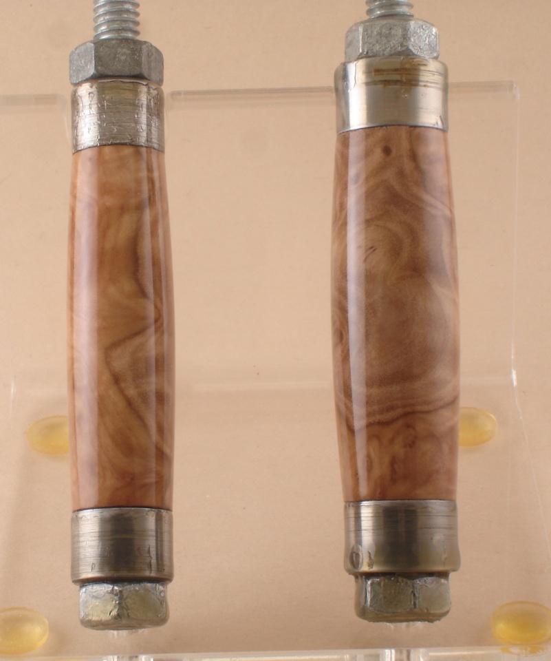

Thanks Mal, and thank you Charlie for the endorsement. I am not sure about the tutorial thing but if anyone has any questions about my finishing process just ask, I would be happy to help. In the meantime here is a photo of another pen, and the setup I use. Thanks again,

Thanks for the extra picture, Bill. Another nicely finished pair of blanks.
You say you didn't use Craft Coat. Can you tell us what you used, please, or is that proprietary :biggrin: ?
I don't know what OMWB means.
