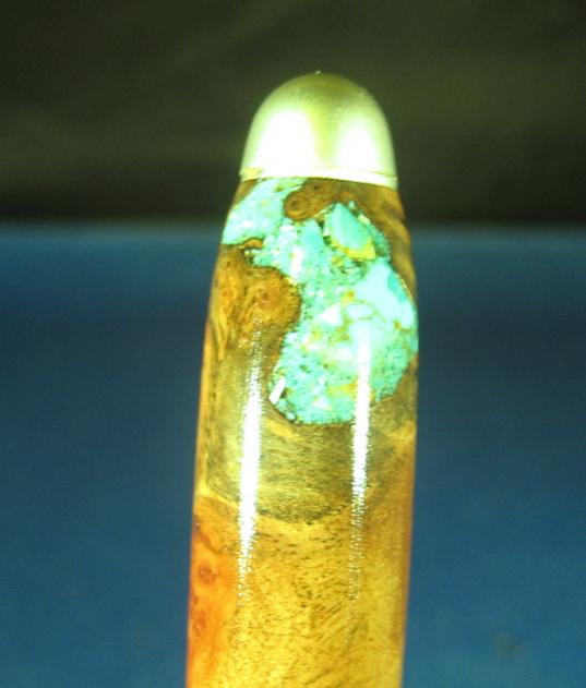

Try digging out the loose knot and then fill the hole with ground turquoise. Turn it down to size and polish it up. It will dress up a pen and save a lost blank. See the pic of a bad spot on an Afzalia blank that I filled with the stone. Just drizzle a little thin CA when you have the hole filled. Sorry the pic is not very good but you see what I mean.
