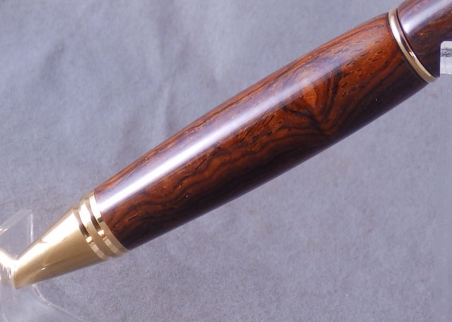

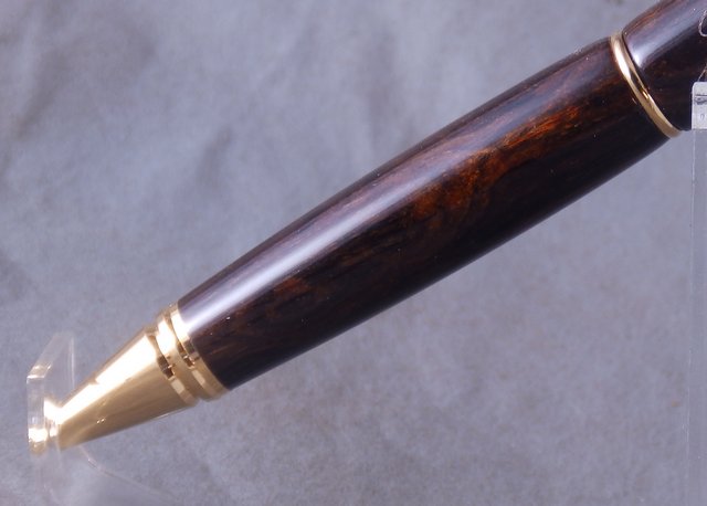

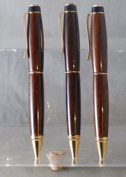

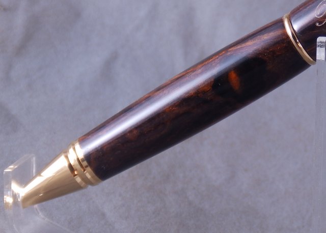

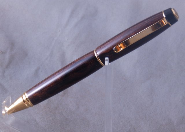

Three pens back from the engraver and assembled and ready to ship to the customer. The wood is nicely figured cocobolo - dark, but nicely figured. Pen is a modified cigar with titanium gold plating. CA finish on the wood.

Very Nice Work. Three to be very proud of.
Personally, I like the lightest one because I can see the 'grain' of the wood.
The funny thing is that these three pens came out of the same piece of wood. I cut the blanks myself from a smallish plank I bought a few years ago. They came out of the plank side-by-side with the same grain orientation in each pen. But, as you say, the color of the wood varies considerably between the pens.
