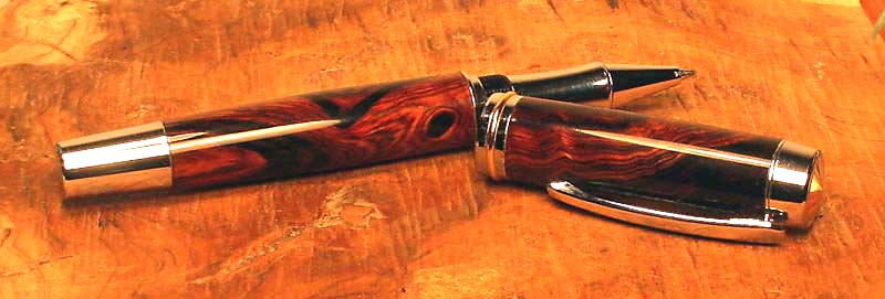

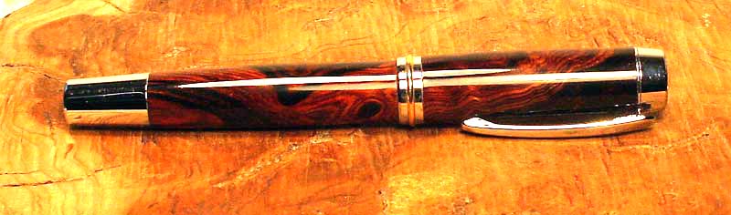

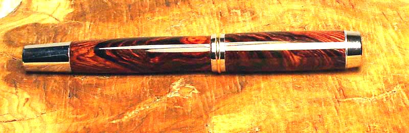

greenmtnguy Local Chapter Leader Joined Nov 18, 2007 Messages 1,689 Location Chester, Vermont, USA. Mar 10, 2013 #1 Some nice Cocobolo burl on a Gent. CA finish Attachments coco burl gent.jpg 61.9 KB · Views: 400 coco burl gent1.jpg 51.6 KB · Views: 362 coco burl gent2.jpg 51.3 KB · Views: 397
mikespenturningz Member Joined Feb 24, 2012 Messages 4,368 Location Claremont NH Mar 10, 2013 #2 Wow Alton that is just beautiful. That finish is spectacular. Look deep enough to dive into.
johncrane Member Joined Jan 17, 2006 Messages 9,850 Location Melbourne, Victoria, Australia. Mar 10, 2013 #3 Great looking pen well done
mmayo Member Joined Jan 12, 2013 Messages 3,374 Location Tehachapi, CA Mar 10, 2013 #4 That pen is M O N E Y - very fine work in every way.
seamus7227 Member Joined Mar 18, 2009 Messages 6,219 Location Wichita Falls, TX Mar 10, 2013 #5 That is just gorgeous!
Dan Masshardt Member Joined Jan 30, 2013 Messages 4,824 Location Mechanicsburg, PA Mar 10, 2013 #6 How many coats of ca is that??? Wow.
greenmtnguy Local Chapter Leader Joined Nov 18, 2007 Messages 1,689 Location Chester, Vermont, USA. Mar 10, 2013 #7 Dan Masshardt said: How many coats of ca is that??? Wow. Click to expand... 6 coats of medium. Sanded with 400 grit to kill shine, polished with 0000 steel wool, and buffed with white compound.
