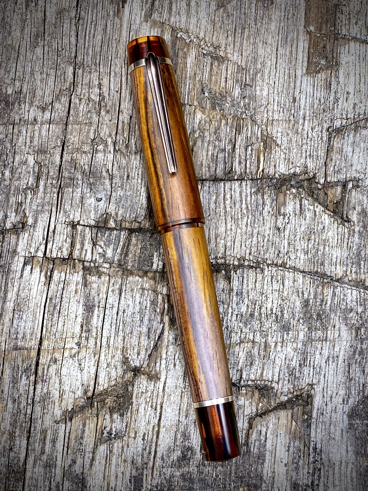

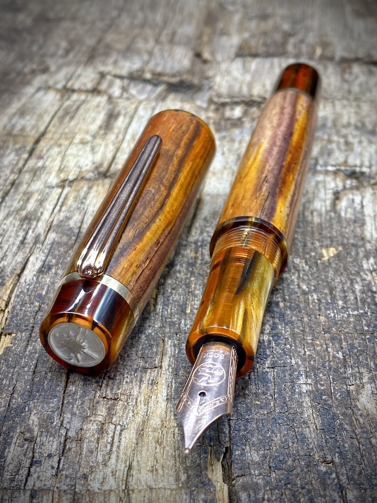

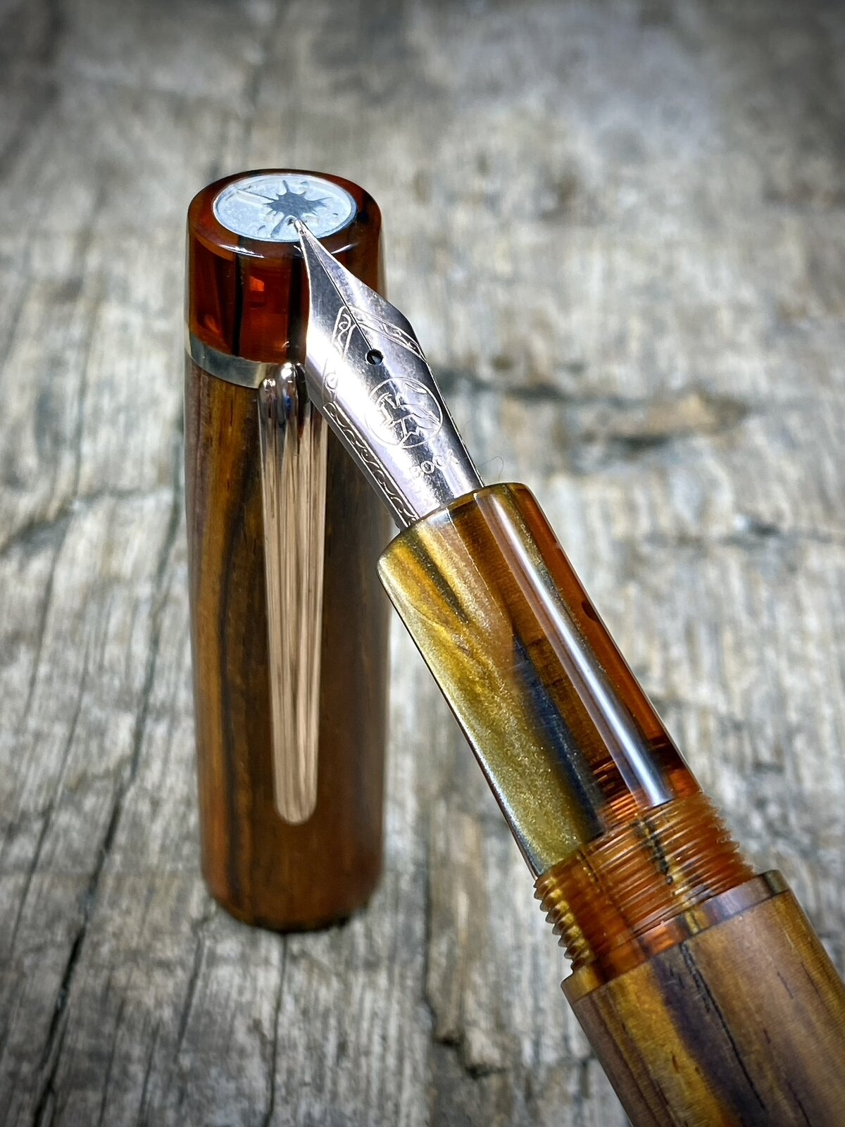

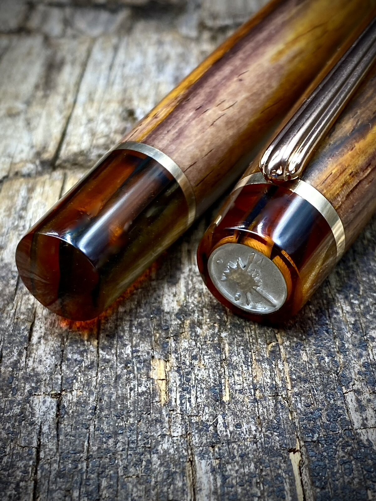

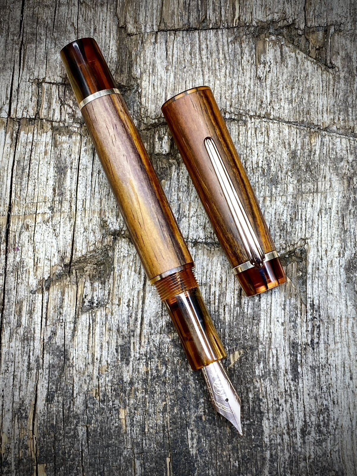

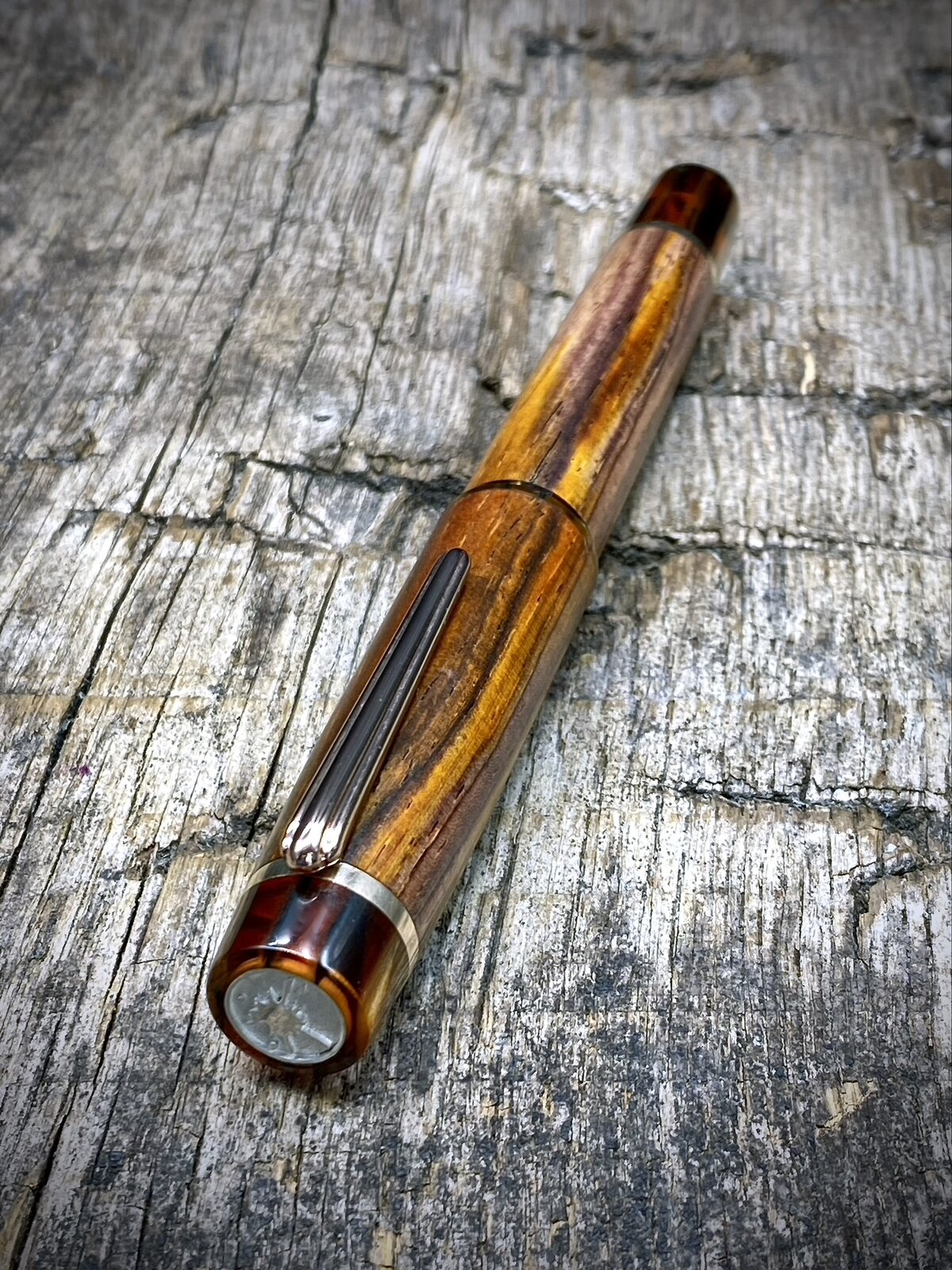

I've got a bit of a rose gold/bronze vibe going on at the moment. This is Cocobolo with acrylic accents. Both the barrel and cap are fully lined and tapered. The nib is a Bock no 6. It's rose gold plated, as is the pocket clip.
13mm cap threads, cap closes in 1.5 turns. The pen is around 149 mm closed.

Great pen, Ash, even if we are getting used to it!
I understand the purpose of a lined cap, the nib drying time is much longer. But what is the use of lining the barrel ?
Valleyboy
Jul 2, 2019
341
Wales
Thanks Pierre
1) The main reason is it helps with the making process for my finial attachment because I get a mechanical joint as well as a glue one. I screw the finial into the liner. I could thread the wood (and have done so in the past) but I have to screw the finial quite tight to make the bond between the wood - metal - plastic nice and tight and if I screw into wood then it *could" cross thread if I over-tighten.
2) somebody once asked if they could eye dropper the wooden pen so I made it like this to see how it went. I don't advertise this as a selling point but she went ahead under her own risk and it worked well for her.
3) In the unlikely event of an ink mishap inside the barrel it reduces the risk of it bleeding through and staining the wood.
