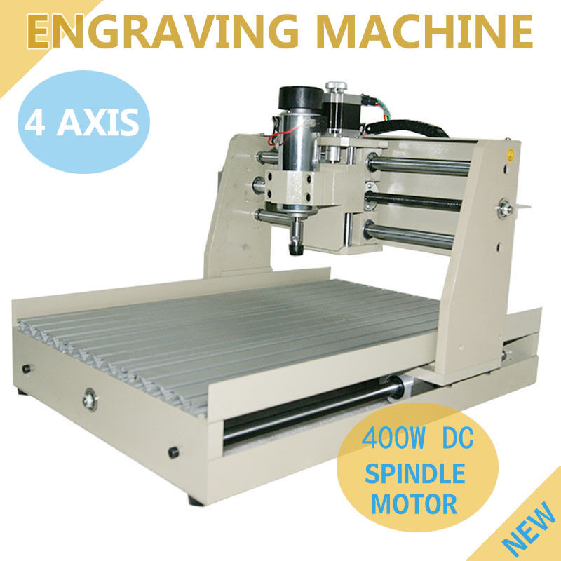

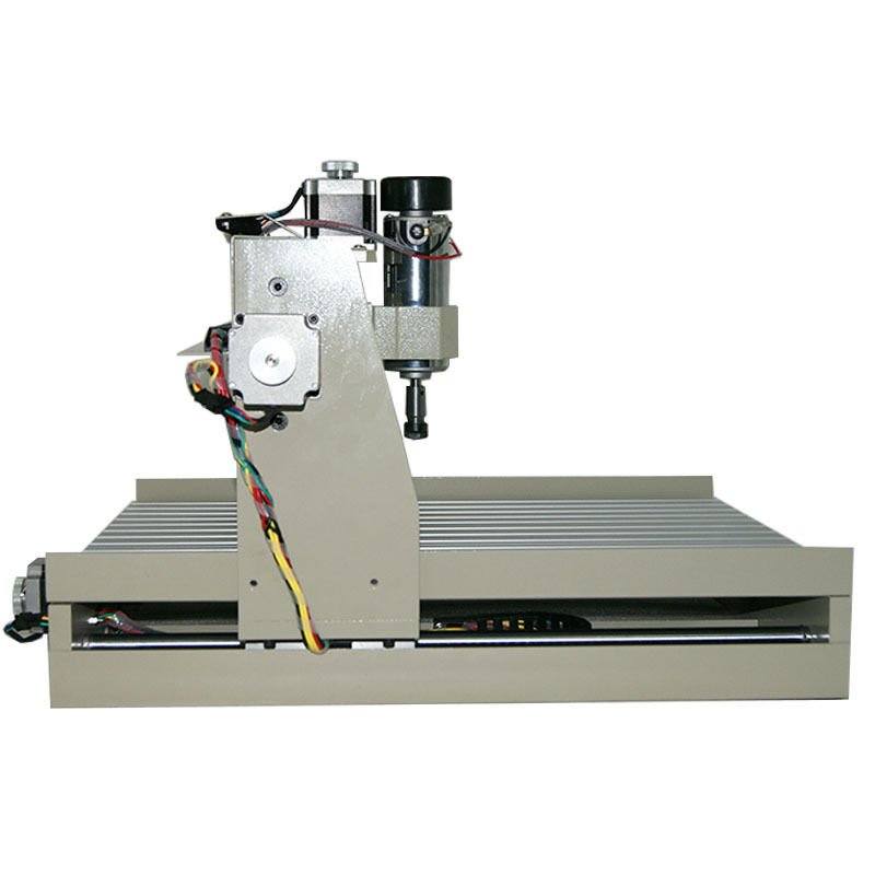

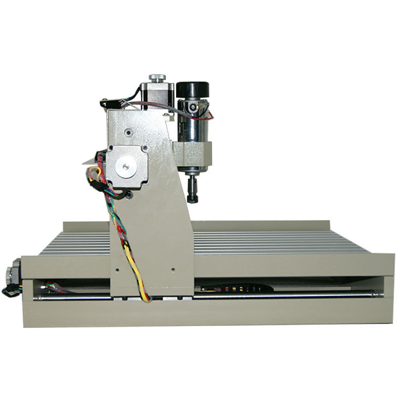

Has anybody ever used this CNC? If so. Is it worth $680.00? Says I can get either Mach3 or EMC2 software to run it. I'm looking for a way to get my names on my game calls.
Thanks for your help.

If you have never operated a CNC , nor written a CNC file then I wouldn't buy any CNC .
Mach 3 can be down loaded for free so a new to CNC people can actually operate the CAM side of a CNC .
There is allot videos you can watch , best is have your pc to watch the video and then the CNC set up and you are designing the product on another pc
You can buy Mach 3 Add ons which is a nice add on .
But actual computer aided design CAD software most in the cue business use BOB/CAD .
I am using CAM BAM , mach 3 and one CNC I haven't wired in yet is Master Cam..
CAD CAM isn't for everyone ...
Creating the files will be know problem. I do that on a daily bases. I own a vinyl cutting business. I was just checking to see if anyone has used this kind of CNC.
I have read a lot of negative reports on the Chinese machines.
What design software are you using now? You will need a cad program of some sort, and there are some that are free.
CNC is quite a bit different from a plotter.
If you use a post processor, you don't need to write code. It is helpful to know the code, just in case you would like to modify it and remove a lot of the unnecessary movements.
If you are inclined, there are a lot of plans available to build a cnc, but I suggest not using MDF or HDPE as a lot of them use. Use aluminum, it's much more ridged and is easy to cut and drill. There aren't any of the moisture issues with aluminum either.
Just remember... you will get what you pay for... cnc isn't cheap and if it is, you will spend much more down the road.

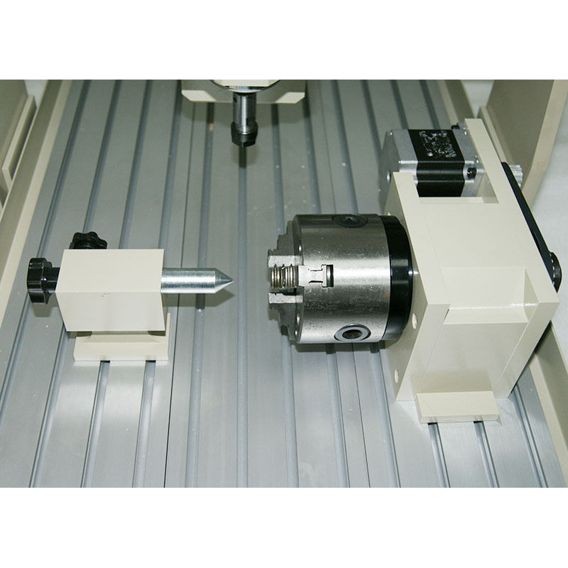

I've never used that machine so I can't tell you how good it is. It's designed for small flat items like PCB's and circuit boards. It most likely doesn't have the capability to do 3d because of the limited height and software so you'll be stuck with flat 2d work. And as one poster noted, tech support with these Chinese machines is not the greatest.

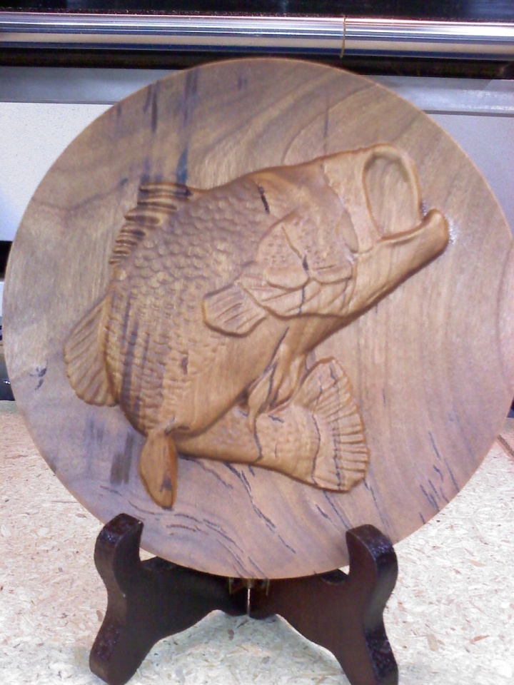

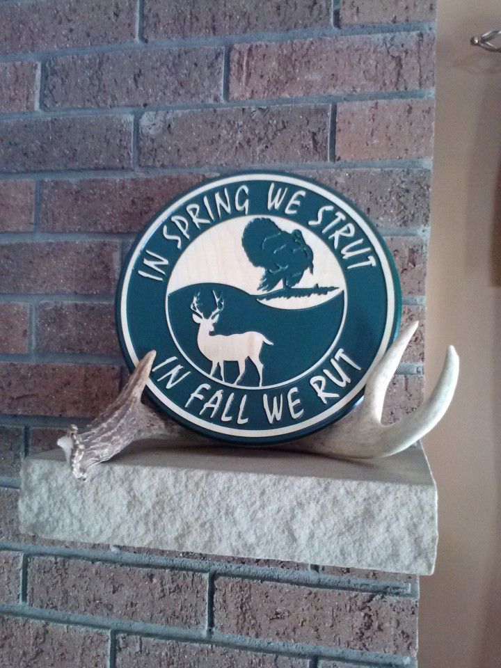

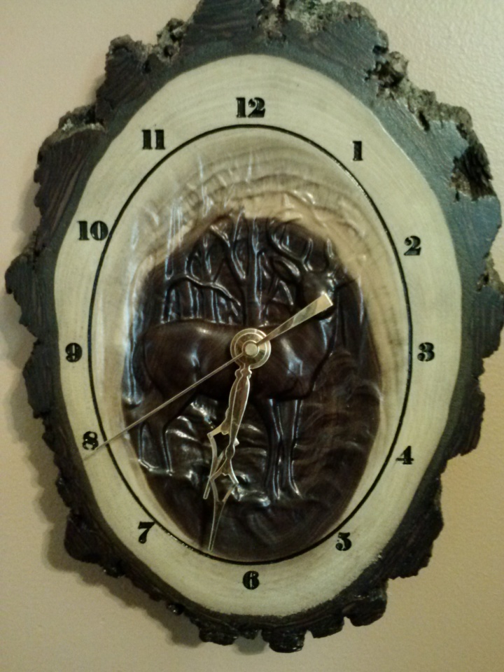

About 1 year after I got into pen making I got interested in cnc wood working so I bought a Shark Pro Plus HD. During the course of learning how they worked and what makes them work I learned my machine wasn't capable of doing what I wanted without making allowances because it flexed and the software was proprietary, among other flaws. So, I searched and studied for a year learning more about cnc work and built my current machine which will do exactly what I want with the accuracy and speed I wanted. No plastic or wood and it will carve 50"x50" or longer if I tile my work.
Learning cnc can be daunting but shouldn't be discouraging. You don't have to know how to write G-Code but you should have an understanding of how it operates, ie; basic commands. My entire career has been spent working in the industrial maintenance field and I literally knew nothing about cnc's but I learned. It takes persistence.
One thing to keep in mind is the z height of the machine you buy. Will it raise high enough to carve your calls? Don't forget the length of the bit when calculating this. Something else to keep in mind is the right size cnc with a 4th axis will literally be able to make your calls cutting down your fabricating time giving you greater precision.
My current machine runs on Mach3 and I use the current version of Aspire. Right now this is just a hobby for me but in a couple of years when I retire I will have everything necessary to open up my shop for business if I desire. If you want something right now, that small investment may be worth it if you're pumping out a lot of calls and need them engraved.
The only reason I post all of this is to give you some food for thought. You may be looking for a machine to just engrave your logo right now but I guarantee you once you use one and learn what they are capable of you'll want a larger machine. You will only be limited by your imagination.............. and pocketbook. :wink:
Any questions feel free to pm me.

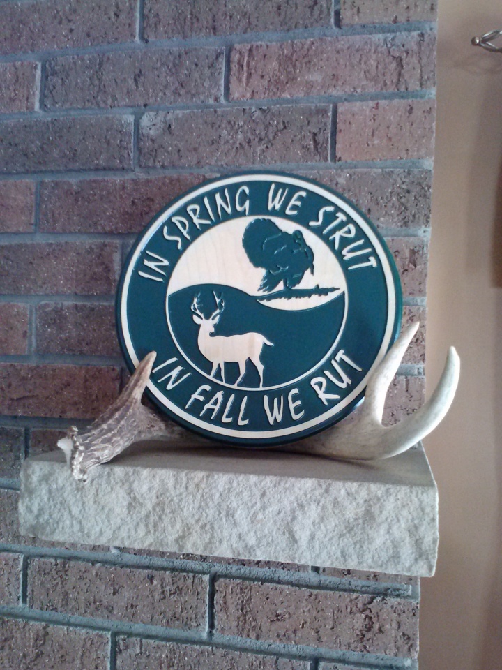

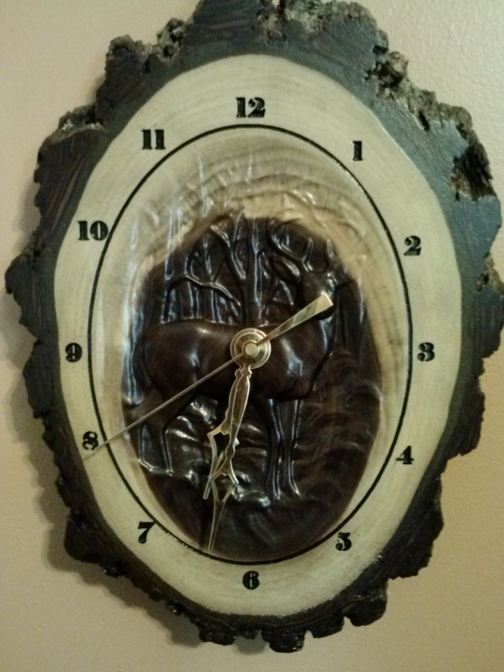

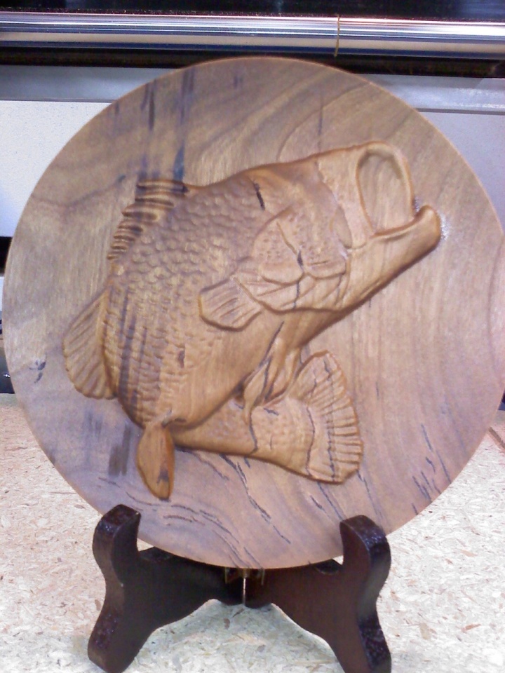

Here are a couple of examples.

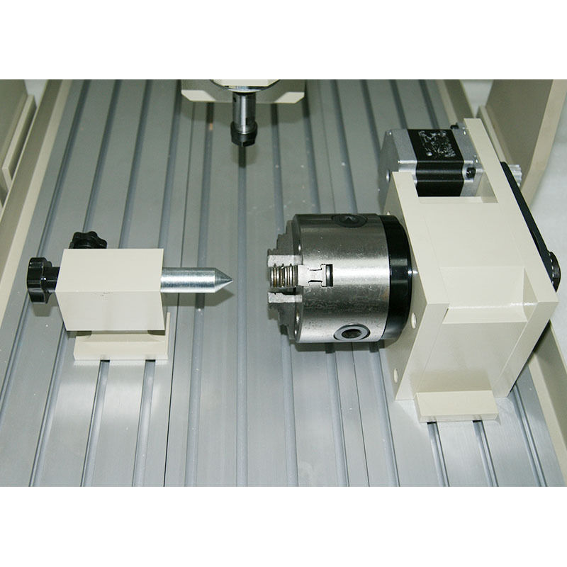

If it truly includes a 4th axis like the one picture shows, then it's probably pretty comparable to buying all the components and building your own, with a lot less headaches (disclaimer: I have not built one, but have looked into extensively.)

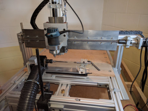

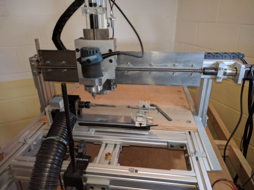

You can download their software for free and tryout its the easiest cad/cam software I have seen. My setup uses Colt router for spindle, its loud and was looking for a silent spindle. The spindle on this Chinese one looks similar to those sold on ebay. I read somewhere they clog with dust so held back. I piece mealed mine together to save some money but it's still not cheap by the time you add software and electronics. I added a Taig lathe and converted for 4th axis use and it works for me. Some of my other posts show some pen blanks I made with it. Fineline automation has plans for this model but if looking to do other work down the road I'd look at linear slides , ball screws.

We made several of these as inlays on cherry cabinet face frames.

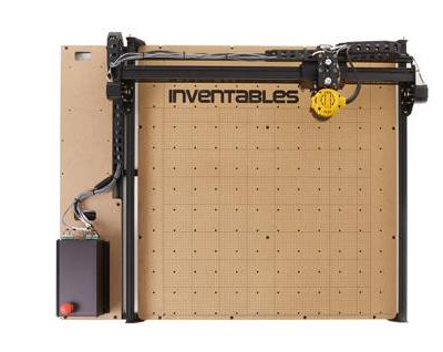

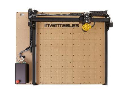

After all the help on this. I think I'm going to just keep saving my pennies and go with the X Carve (1000mm) from inventables.
Thanks for all the help and info on this.
JP
