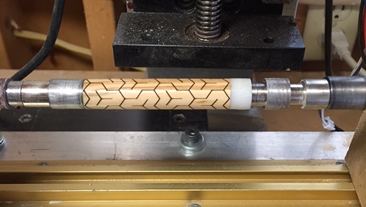

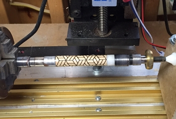

After having some fun with the 1w Chinese engraver from Gearbest, I decided to see if I could incorporate a laser onto my CNC - a project I have been thinking about for quite a while. I went with a 2w laser diode from ebay that came with a driver that could be controlled with the Mach3 software already on the machine. Using the spindle control to turn the laser on and off and the PWM capability to control the power, I now had complete control of both hardware and software and can make use of my radial axis.
Foe vector graphics, there is a free GCode generator for InkScape from Jtechphotonics (also has great info on conversion). The picture below uses that feature. Having control, also enables me to write my own GCode, even varying the power within a file which should enable shading. Also below are 2 of my favorite patterns. All code written in Excel. This is what I call fun.

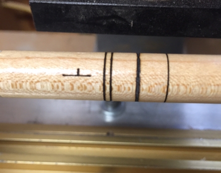

How's the transition at the start/stop point in the round?
Although I've only just begun to play with this, so far it looks pretty good. May need to run a test for that. I've been using M3 and M5 commands to turn the laser on and off and there's some discussion about using other commands such as M10/M11 to avoid a little delay. Since I have it hooked up for the power to respond to spindle speed commands, I may also try just setting that to 0 when I want the laser off. Also need some time to see how well I can use a raster path to do more complex drawings. Some say not so well with Mach3, but I think I may have a way.

Here's some tests I ran today. As requested, the first is the transition seam on a radial piece at 3 different powers. The start/stop position is at the horizontal line. The one on the far left is done by turning on and off the laser using M3/M5 codes. The next 3 are using an M3 code to turn on the laser at 0 power and then SXX to start the laser.

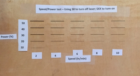

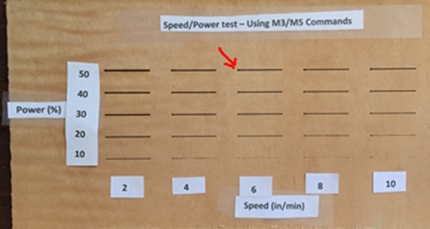

The next two pictures are a test of speed and power settings. One uses M3/M5 commands to turn off and on; the other uses the SXX commands. S0 to turn off and SXX to define the power in %. Note the extra little burn on the left of some of the lines when using M3 to turn laser on. Appears to be a little delay before starting to move. Pretty much gone when using SXX command.
