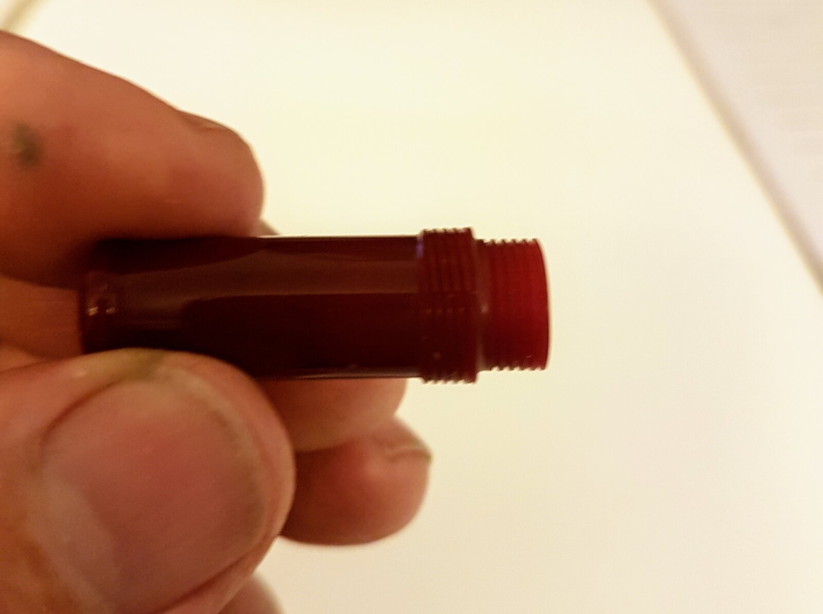

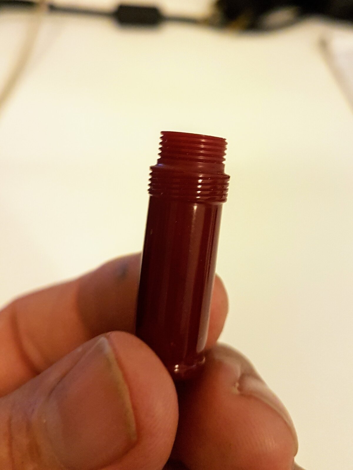

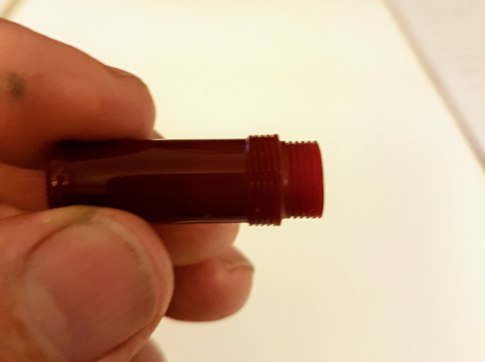

Good morning everyone. I received the thread tools last Thursday, made some experiments last days. I was extremely pleased with the results. With the same cutter I made three threads on this piece: M14 X 3 X 4 entries, M10 x 0.8 and an internal one for the M6.5 X 0.5 mm for nib. Material is acrylic. The total machining time was about 4 minutes, machining each thread in two steps. I recommend everyone who has a CNC router to dedicate some time in this option, thread milling.

I'm out for a few days but I can share some datails now. I have 4th axis but it is not used in this case. I use a collet block to fix acrylic piece on cnc table. The milling tool is a single teeth, 4mm, 60 degrees. Software used Solidworks/ Solidcam, we have several resources for thread milling, not difficult to learn. I know Autodesk is another good option. Even last version of Vectric Aspire offer this milling resources. My CNC is a kind of DIY machine, 24.000rpm max speed, generic Gcode controller. My suggestion is start learning about thread milling and how to use your software. Mechanical operation is relatively simple.
