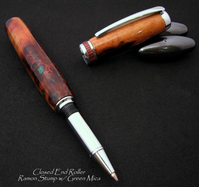

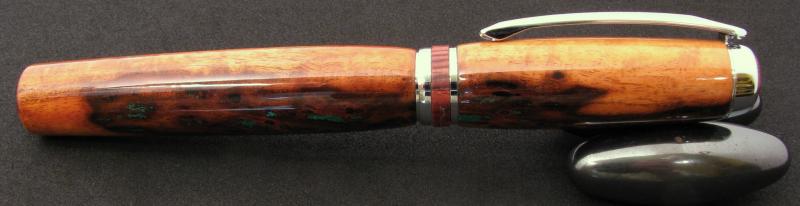

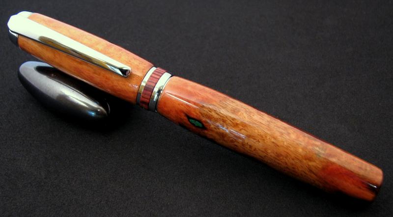

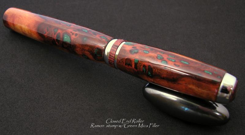

This pen was different to make seeing as I needed to fill the natural holes in this wood with something. I decided to use green mica instead of sawdust or straight glue. I put the powder in the holes and worked it in a little with my finger the did CA over the top and resurfaced it to the finished shape to get tall the access mica off. The final finish is 3 med CA and 5-6 thick CA then a lite sanding and all the pretty colored pads.
As always bad or good comments are appreciated.
