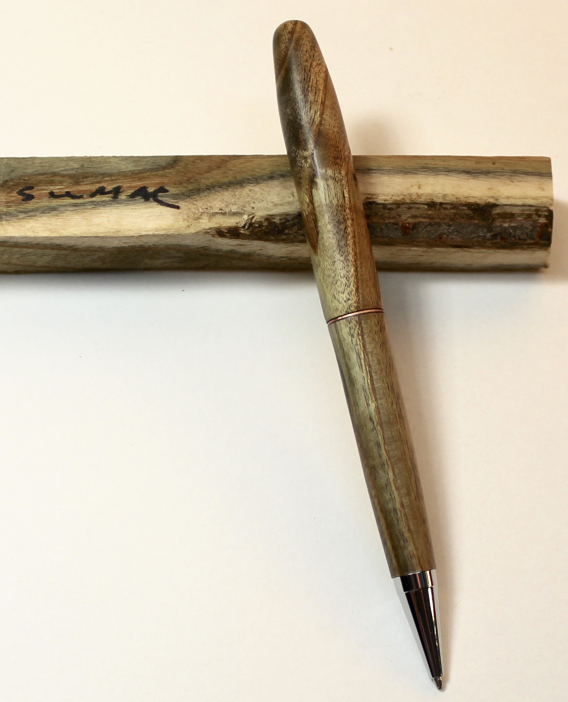

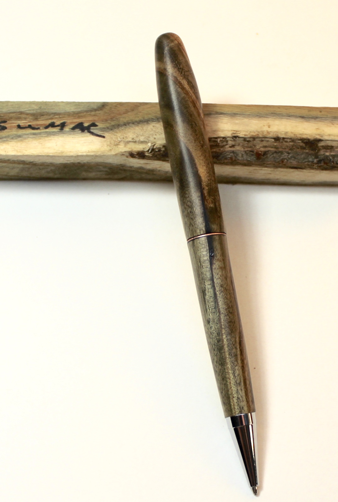

I ADDED THE PHOTOS ABOVE LATER.
This was a "test-pen" just to experiment with a few new things for me:
1. Closed end Slimline
2. Modified with the Brass center-band
3. Used a home-made pin chuck to turn both blanks at the same time to get the profile to match.
4. The Sumac was not stabilized, so I used two coats of thin CA, and sanded back to profile to get a matte finish
I really liked this with the grain patterns that matched fairly nicely... Wifey came home: "That's MINE!!!
I guess I'll just have to make another. :bananen_smilies022:

I really like that, Mark !!!! . Well done !!!!!
Does the one pin chuck go through both blanks ? . Must have a very long pin. . Hmmm ... or maybe two pins.

I have a set of Pin chucks, and I also use my Harbor Freight Punch Set and simply grind a flat slot for whatever tube size I need (Then grind down nails to fit). The punches are still perfectly fine as is.
Yes, for this modification, I ground the center punch to extend between both blanks. Very easy (5 min). I then turned the CENTERS of both blanks at the same time. I then finished both blanks ends separately.
It is more complicated to write this than to do it!
Give it a try!
