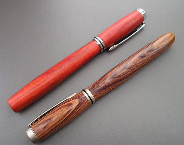

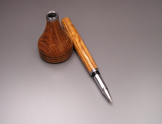

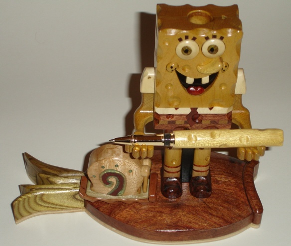

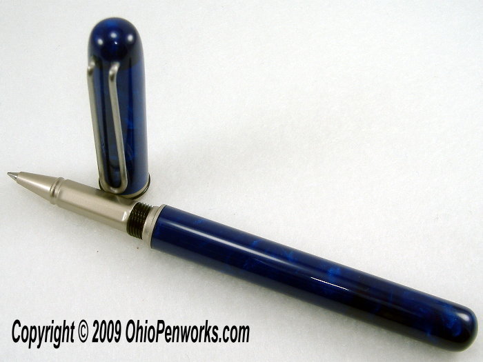

I've made plenty of closed end ROLLERBALLS. Here's some pics, so it must have happened.:wink:

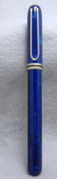

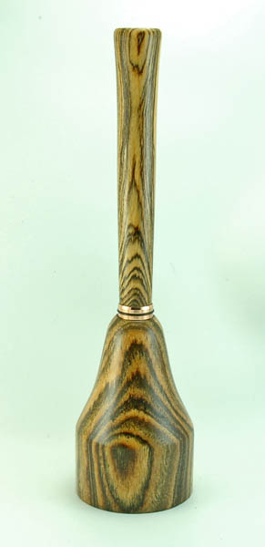

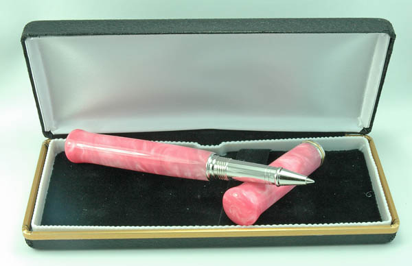

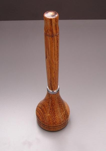

I have done quite a few closed end rollerballs. Here is one that I posted a couple days ago and a couple from last year.

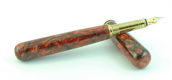

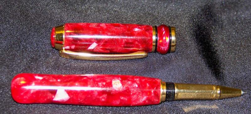

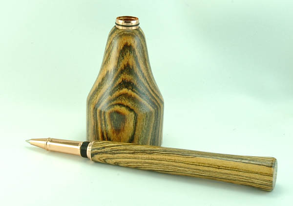

My contribution to the closed-end parade:biggrin:

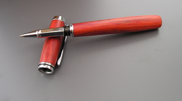

My contribution to the closed end barage! I drill a 7mm hole into the end past the larger diameter hole and glue in a peice of brass to keep my spring in place as well the refill.

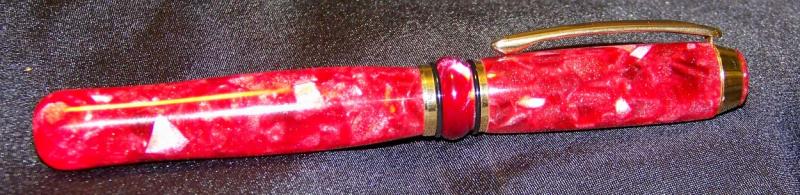

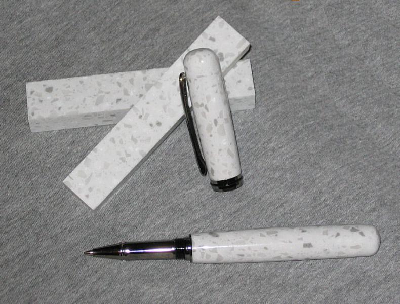

Here's mine. A closed end Baron with a hidden clip in corian.
I know the colour's not great, but the material was free!
