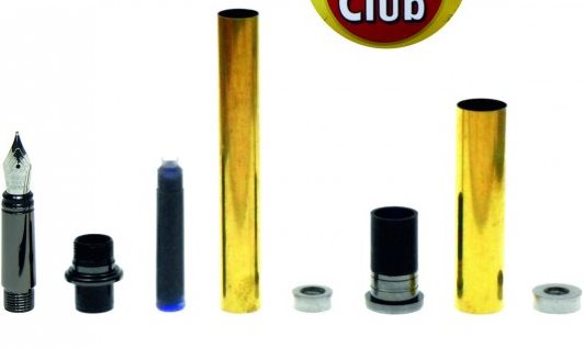

A Supplier here in Germany sells a version of the Panache as a Closed end.
He has added small caps to the kit, these are a press-fit int the tubes. A shoulder stops it going to far and it has a 5mm intern thread.
This means you can use one of the bushings and the thread of the mandrel to hold the blank.
