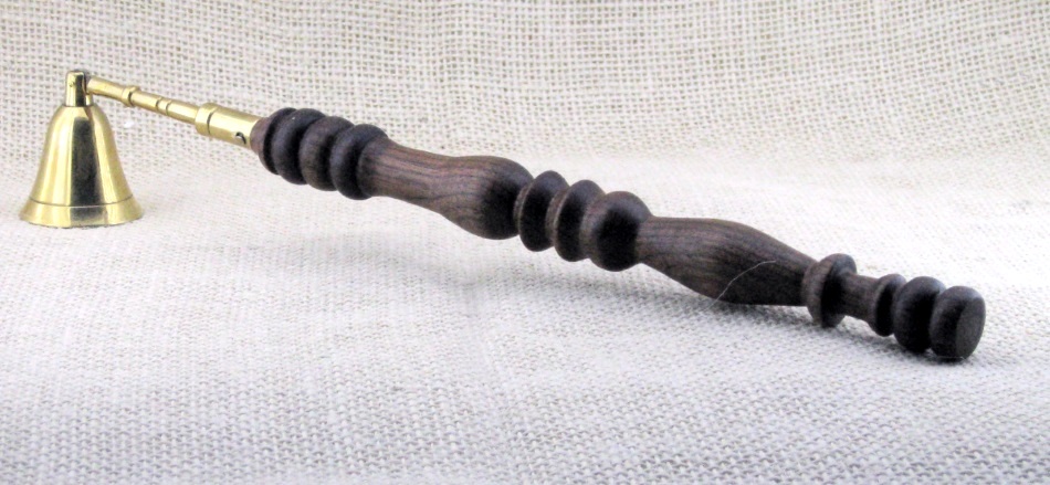

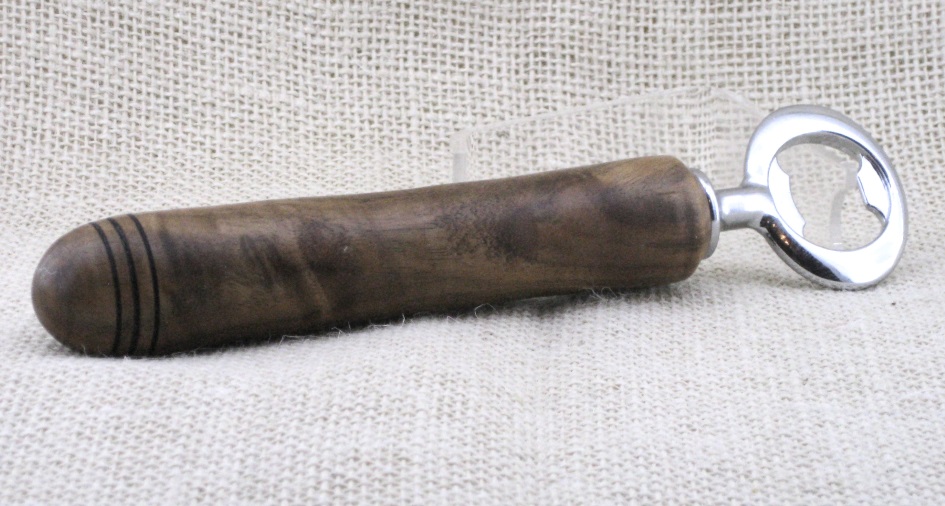

No photo of the back scratcher yet but I've attached pictures of 2 other items I've made with closed end handles.

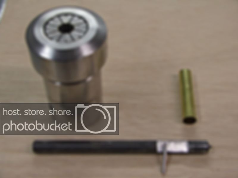

Good idea. I read on here a few days ago where someone mentioned using the same HF punch set to make various size pin chucks by grinding a flat spot and using a nail with the head cut off as the pin.
Works well. There are other uses for those punches too. Such as for sanding the ends of a blank on the lathe.
