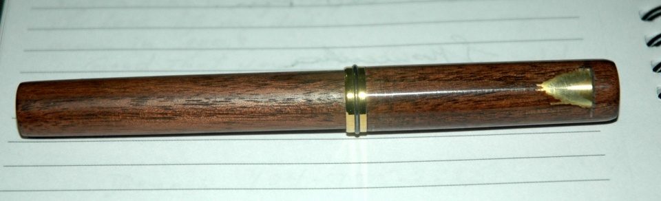

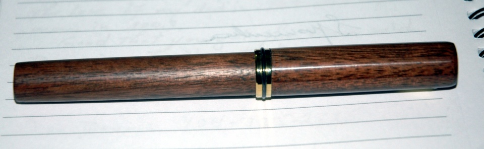

Not "kitless", but modified to be a closed-end pen - both barrel and cap. I used the center section and the nib from a Jr Gents II fountain pen, and some straight grained walnut from my scrap bin. The walnut has been following me around for about 40 years.

Oops! The cap was not quite aligned to the axis of the lathe and when I was sanding, the brass tube made an unwanted appearance.
However, I think the concept is good, but the execution was flawed. I think I know how to avoid this on the next attempt.
My wife says, "Gestalt calls for the presence of a clip." On this one I may attach a piece of maple to look like a clip and to cover the brass. That will also stop it from rolling around on the desk. On another, I will try to use a clip from a kit, and attach it to the cap with a tenoned tassie using a contrasting wood. Or maybe the same wood. The tenon will require the cap to be a bit longer.

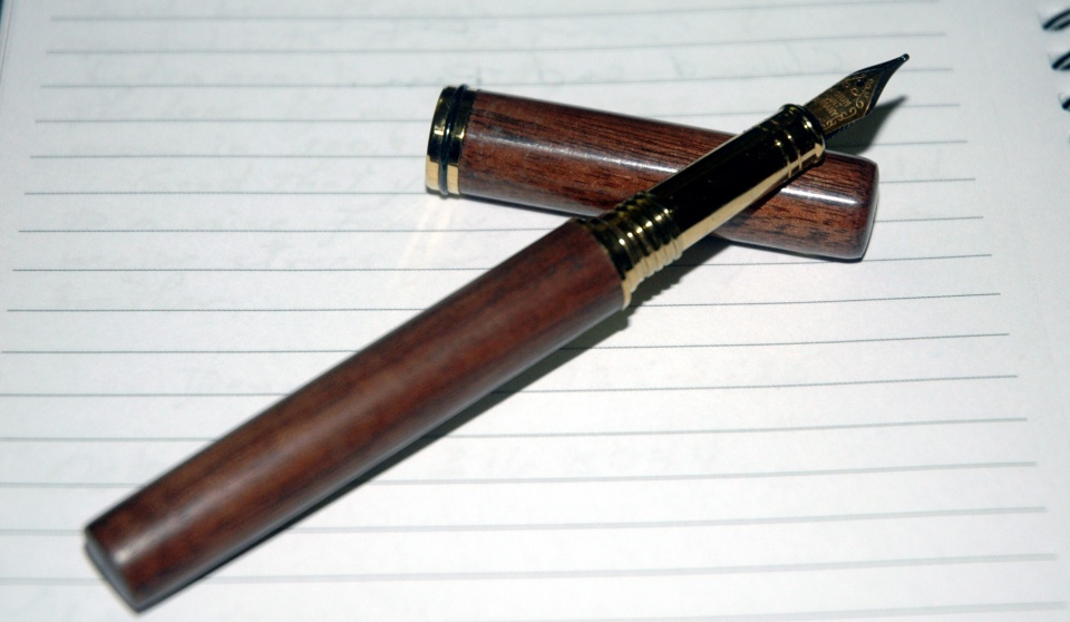

Good effort.
Some kits make it easier than others to add a cap finial in the material you use to make the pen -- for example, the Churchill kit has a domed finial that screws into a threaded insert (which you press-fit into the cap barrel).
It's not too hard to either turn away the brass that dome is made from, or find some matching threaded rod, which you can glue into a piece of wood and turn a replacement finial.

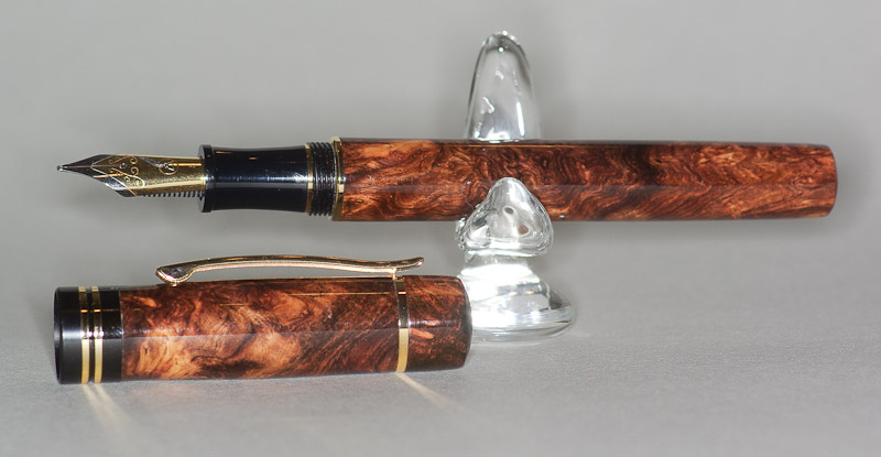

Here's an example I did a while ago ... Churchill pen kit, wrapped in cocobolo burl.

Bob, too bad about the flaw. . That pen looks otherwise pretty darn good to me !!!
And Duncan yours is lovely also also !!!

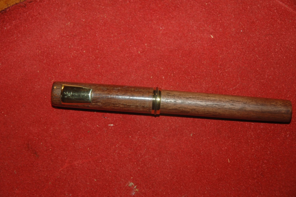

Here's the attempted fix. I used a piece of another cap tube.
