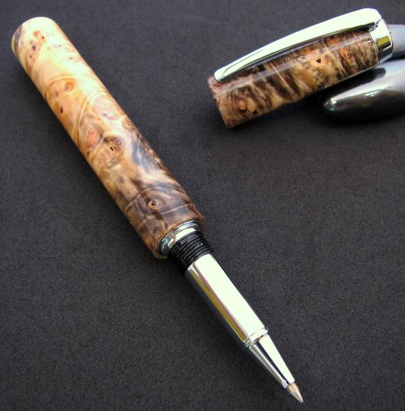

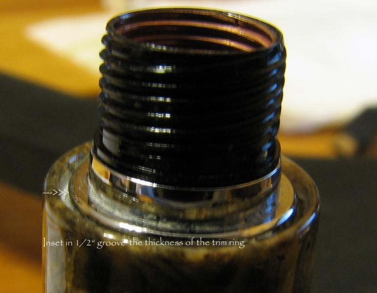

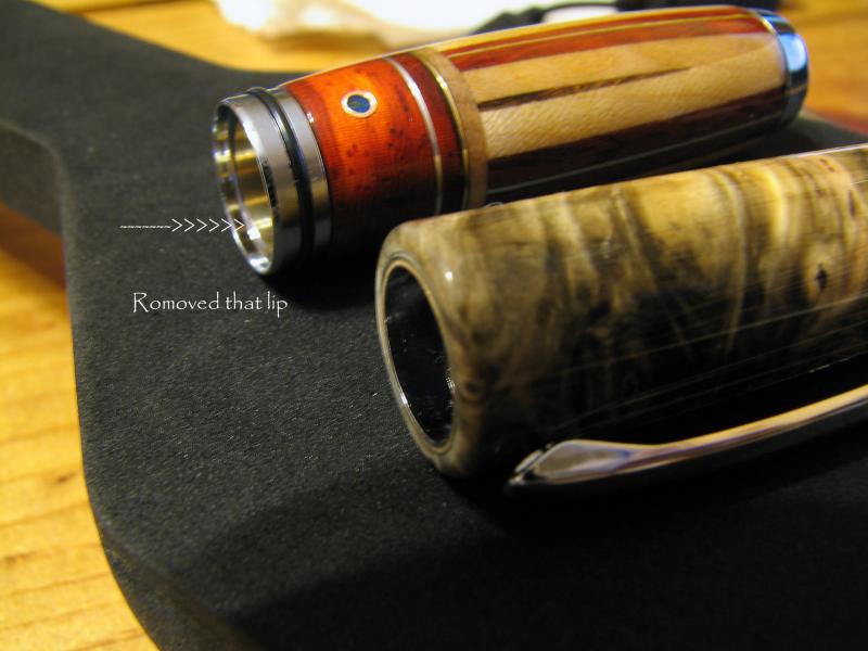

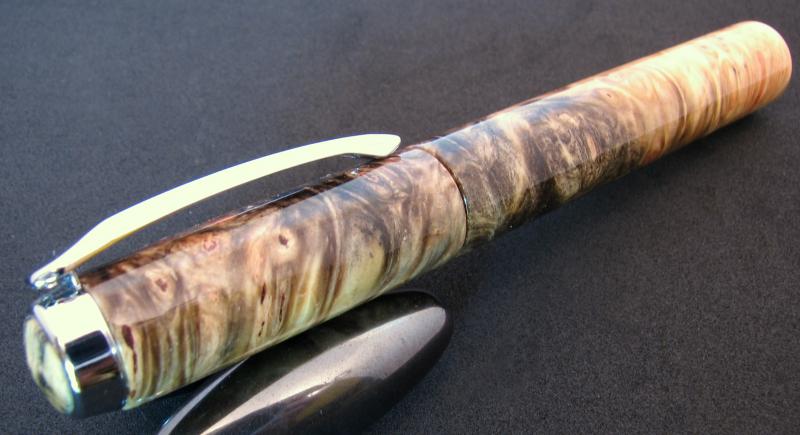

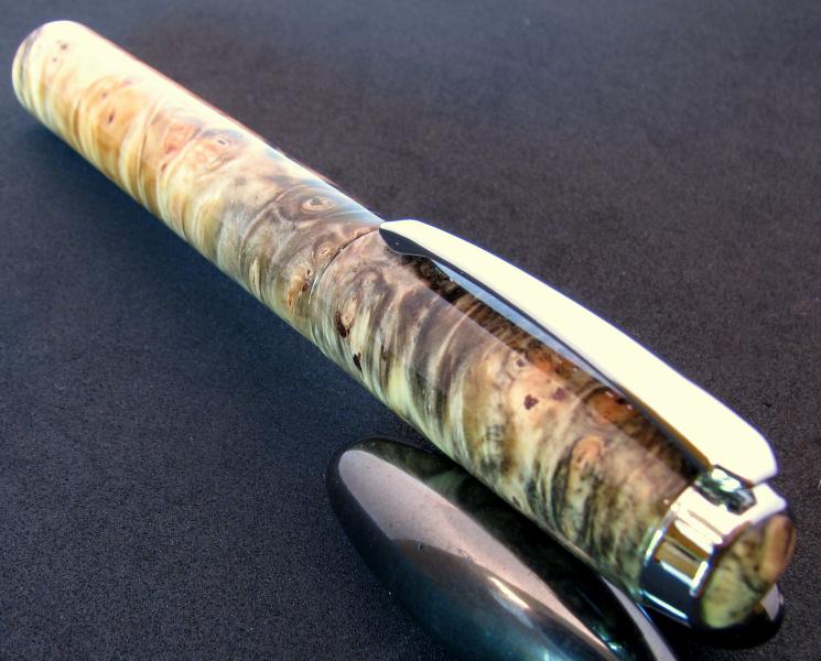

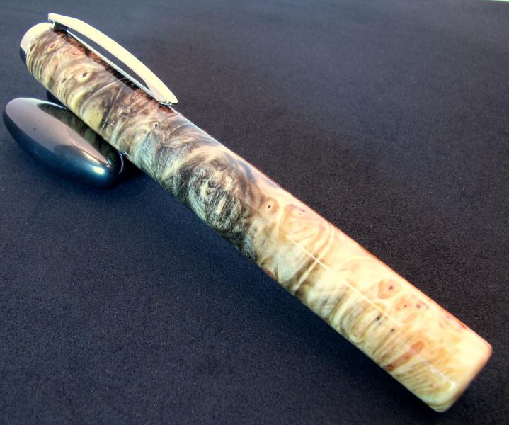

Several have done pens that they thread themselves but I do not have the threading taps to do this. So I took the threaded section for the cap and sanded off the lip that usually butts into the wood or resin and pressed it in. I took the nib end with the trim ring and countersunk it just the thickness of the trim ring. I really like some of the kit-less? pens that are just straight through with a slightly rounded tail edge so this is what I was going for with this pen.

I really like what you've accomplished. I'm generally not a big fan of "kitless" pens as I think they often look rather plain. You have just enough metal trim to compliment the really nice burl wood. It results in a pen that begs you to pick it up and unscrew it. Great job. Someday I'll be talented enough to give it a try.

Brian, I really like it!!!!. I wanted to ask a few questions. How did you countersink the trim ring? Did you underturn the end of cap and barrel facing the center of the pen to add thickness to the center area of the pen?
What pen kit is that? Thanks so much for showing and sharing! Doc

I drilled a shallow 1/2" inset for the trim ring to fit into and flush. The cap I sanded away the first lip and took off the black ring and the other chrome ring. after sanding there is still chrome showing. When ready you just press those cap threads flush with the brass tube. The hole for the inset trim ring rally needs to be smaller, but I aint got metric bits:rolleyes:
