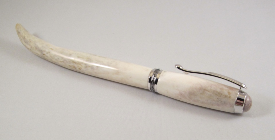

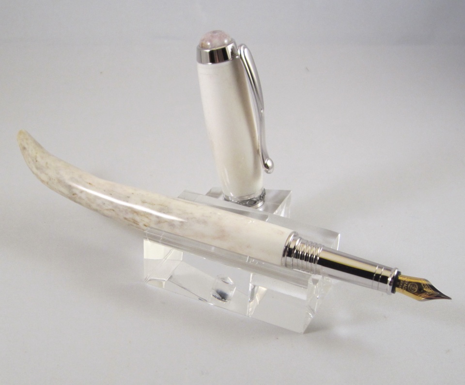

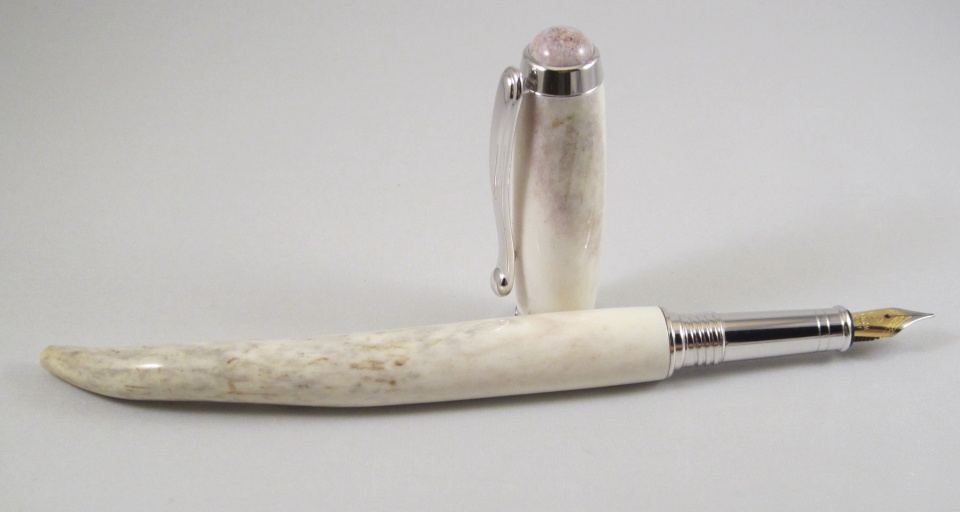

Here is a closed end White Tail Antler on a Statesman II Rhodium and Black Titanium FP. The curve on the end was a little tricky - especially to assemble!
Comments and Criticisms Welcome!

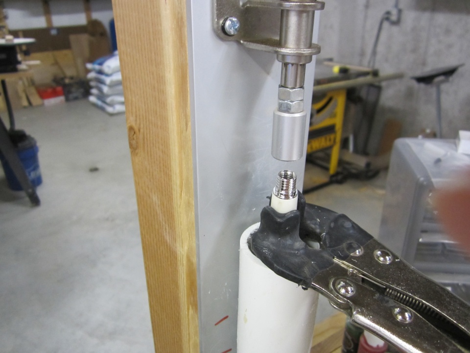

I will take a couple of pictures and show - lot easier than trying to describe it - was able to use the pen press - will do that tonight

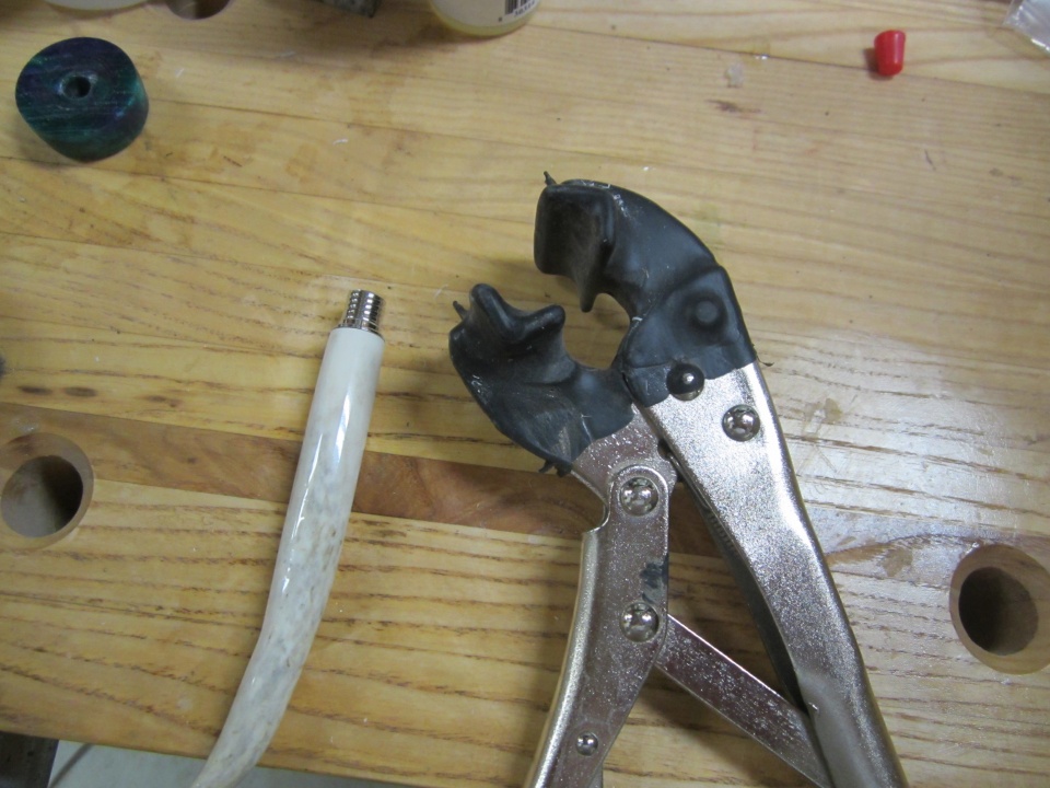

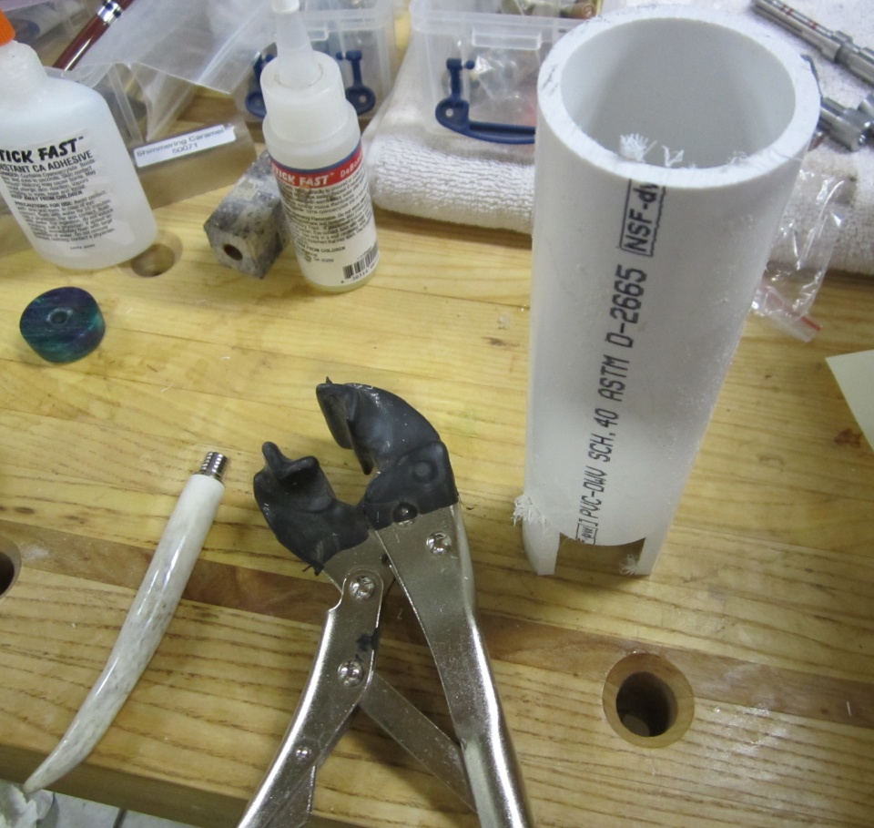

Here are a couple of Pics to show how I pressed the pieces in the curved tine:
Tried to rearrange pics ?? - Picture 3 shows the tools - piece of PVC pipe (big enough to insert the tine and allow some movement - this is 1 1/2 ) cut out to fit over bottom of pen press, Pic 2 shows the pliers used to hold the pen and pic 3 shows the pen ready to press.
