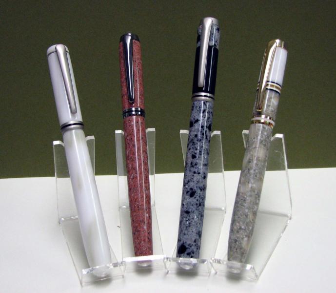

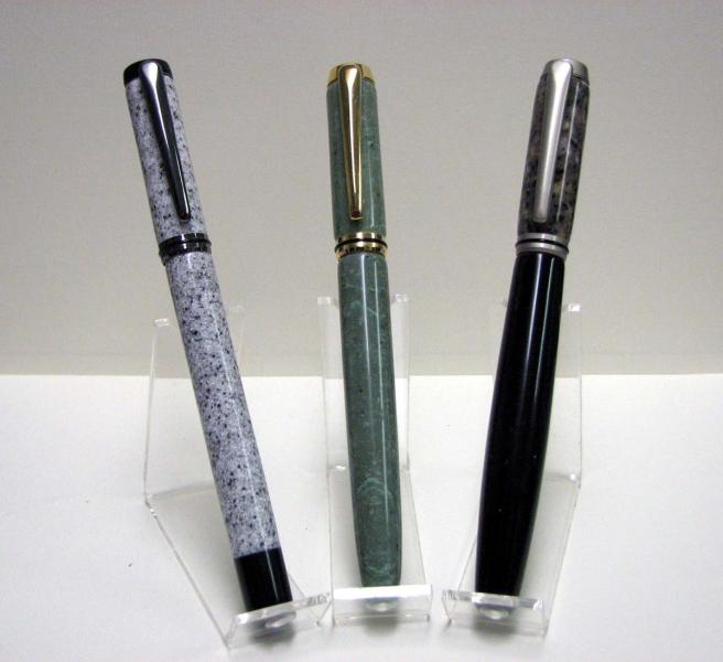

I got on a kick a couple of weeks ago and turned some closed ended Barrons
They are all done with some sort of solid surface.
Alice
Hi Alice,
you did a good job. The pens look well done. But I personally don't like the proportions. The most are too long. You should try something close to Golden Section. Maybe try to also make a closed cap end on the longer versions.
Paddy
Alice:
I like how the cap turned out on the forth one on the right. nice job on all.
Steve
Are you talking about the white marbled one? I just turned the cap to look like the one that comes with the kit and then used epoxy to glue it in.
Alice
I agree with you. I have been debating on taking a couple of them apart and remake the bottoms.
Because you have to glue a piece of wood to the bottom of the blanks I did the glueing all at once and wasn't really paying attention. I cut the blanks on some too long to begin with.
I was in too much of a zone and did not notice the length until later.
Duh!!!
Thanks for your input. I way actually kind of expecting someone to mention the length.
Alice

I like the last one on the right the best (2nd pic). I like the replaced CB. And the transition on the cap.
It is really pretty easy.I just use med. CA
There is a step by step process one needs to take.
1.cut 2 blanks the same size 2.smooth sides up, do NOT sand
3. use denatured alcohol and a paper towel to clean all the lint off of the blanks. the alcohol also acts as an accelerator so have several spring clamps ready
4.Wear gloves,place blanks on waxed paper, apply med. CA glue liberally
5.Quickly rub the sides together making sure all surfaces are covered
6.Place spring clamps covering the entire blanks and there you have it! About 5 clamps for a regular blank. they begin to bond fairly quickly
Just let it dry for a couple of hours or over night
cut to square up on the table saw.
In very busy patterns sometimes you can see where they are glued. This is because of patterns not matching.
If done right and with most patterns no seam shows.
Alice
Is that corian? If so, how did you bond it so it doesn't show a seam?
