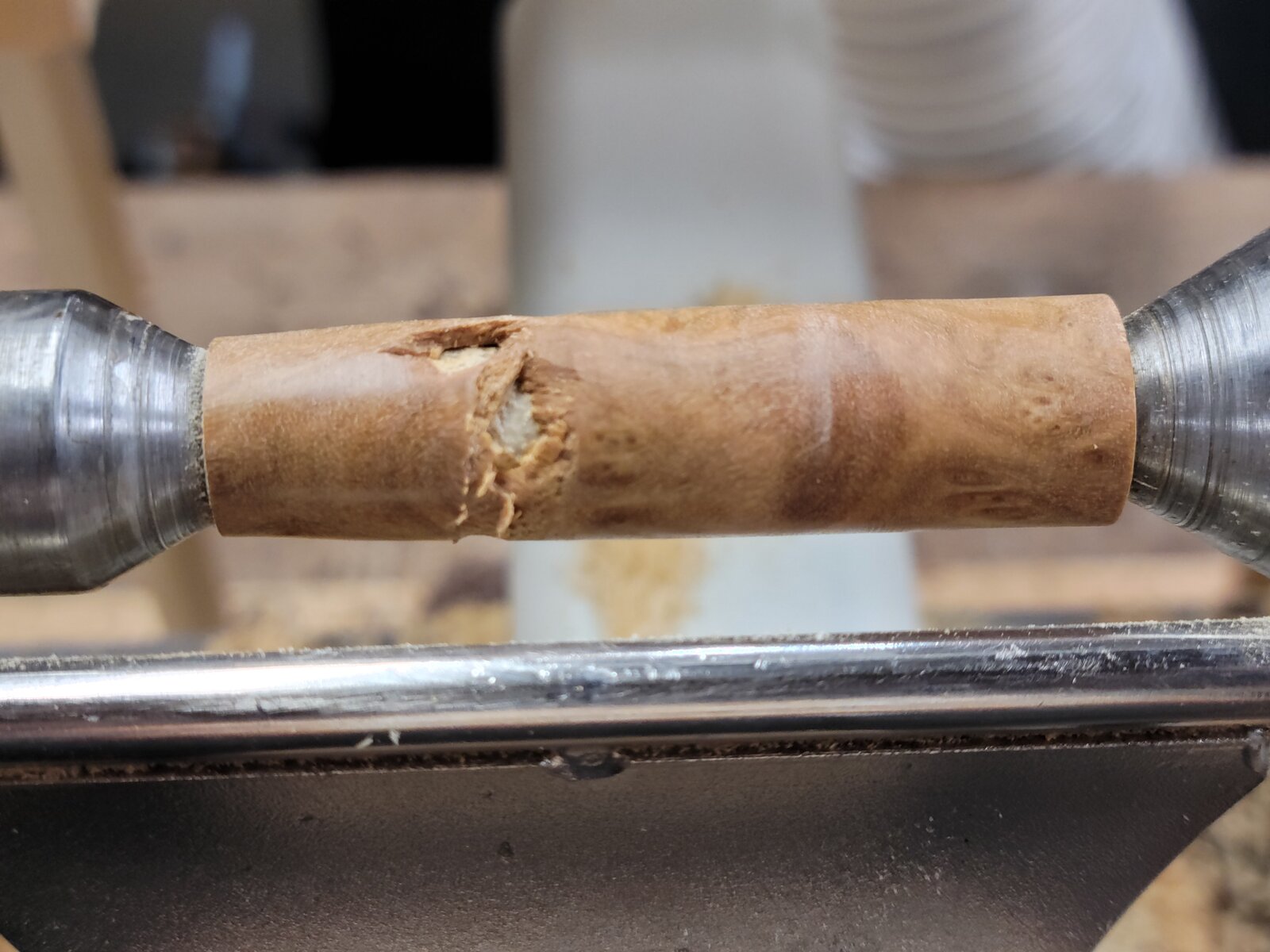

I'm bummed. The brown Mallee on this cigar barrel went from beautifully figured to grossly disfigured in milliseconds. I was taking thin little shavings off dang it! I'm sure we've all been there. Ah well, back to the grinding wheel (to sharpen the patience that is, and maybe the skew.)
Hi Todd,
What a bummer. However, it looks like it could be a perfect opportunity to turn off the damaged end and glue on another kind of wood to make a segmented blank. Maybe with another piece of Australian or New Zealand timber to keep in with the brown Mallee theme?
Regards,
Dave
Coffee grounds and CA glue to the rescue?? No need to discard a mostly good blank.
Coffee grounds would be too dark against the mallee for my taste. I tried with shavings/dust from this same piece and was very unimpressed with the results. I thought about a complete contrast with some crushed apetite, but there is a gouge that goes around the barrel and needs to be built up, too. I have more of this wood, but it's just a shame to waste it like this. Maybe I'll use the top half for a cap on a classic rollerball since they're both 10mm. No need to waste it all.
Todd, did you stabilize this first?
I have some brown mallee burl on the shelf waiting for my attention.
I've been debating whether or not to stabilize it. Your photo is a shove in that direction.
I did not. I don't have a vacuum pot for stabilizing, but have done so with ultra thin CA on a few blanks when I thought they were too fragile. I have turned some other pieces of this of this without doing so. There weren't any punky spots or holes that needed to be filled. It was probably just a very slight (bad) motion that caused the catch. I definitely don't blame the wood.
