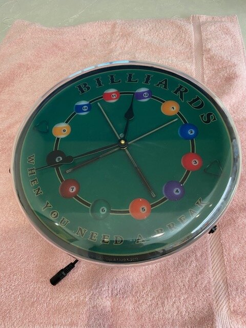

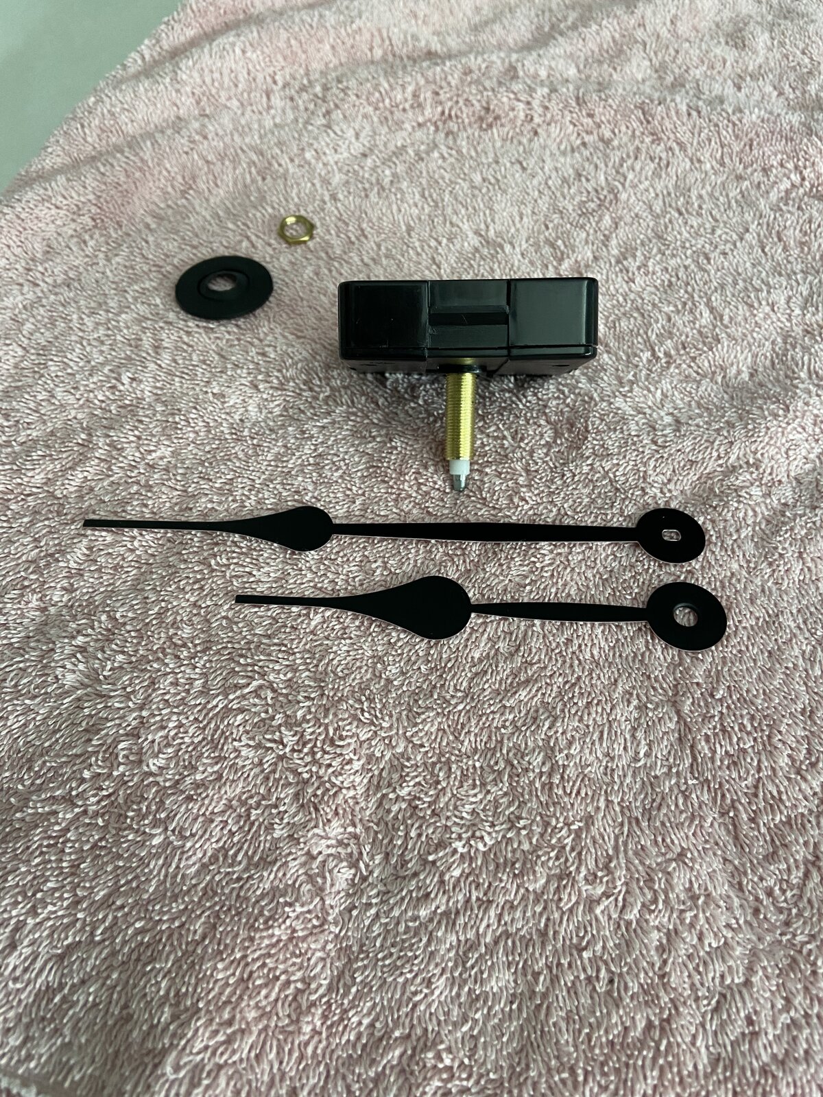

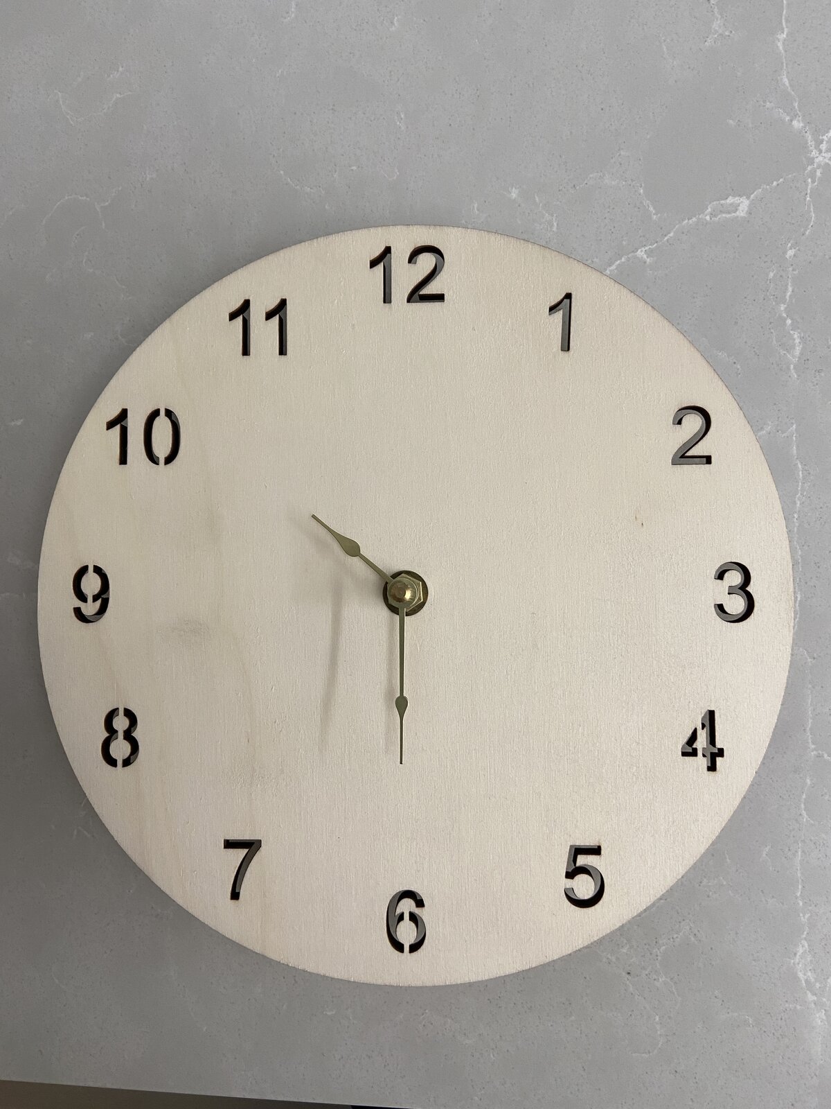

Where to buy this. I have a clock (gift) that sat for a year. Put a battery in today and it does not work. Getting replaced.

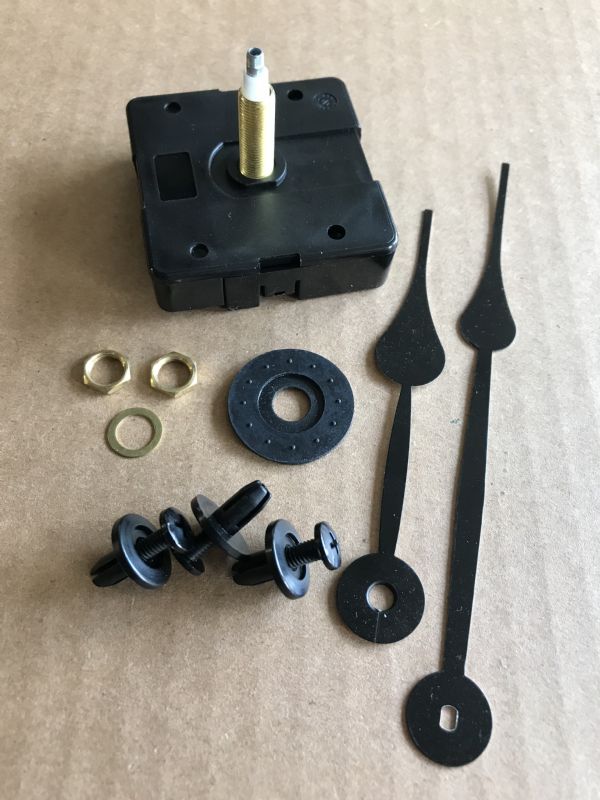

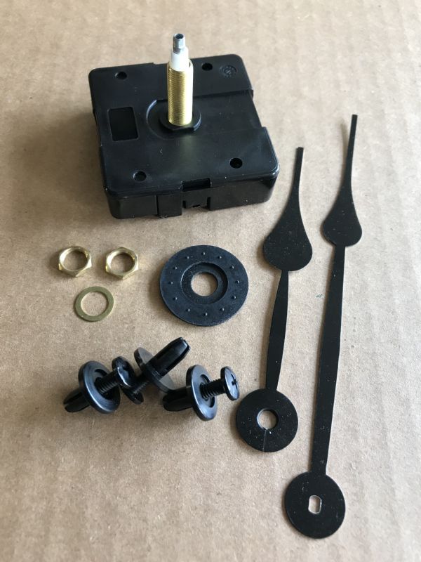

Seiko is probably your best these days. It looks like those are large hands so I would go with a high torque motor. Cost a little more but will be worth it.
I can buy the replacement motor from the company that sells this clock. It's overpriced at $25 shipped but it'll fit and it's done. The shaft length is correct and it comes with new hands. Thanks for the replies.... very helpful

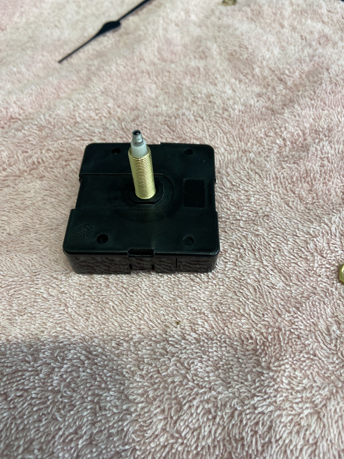

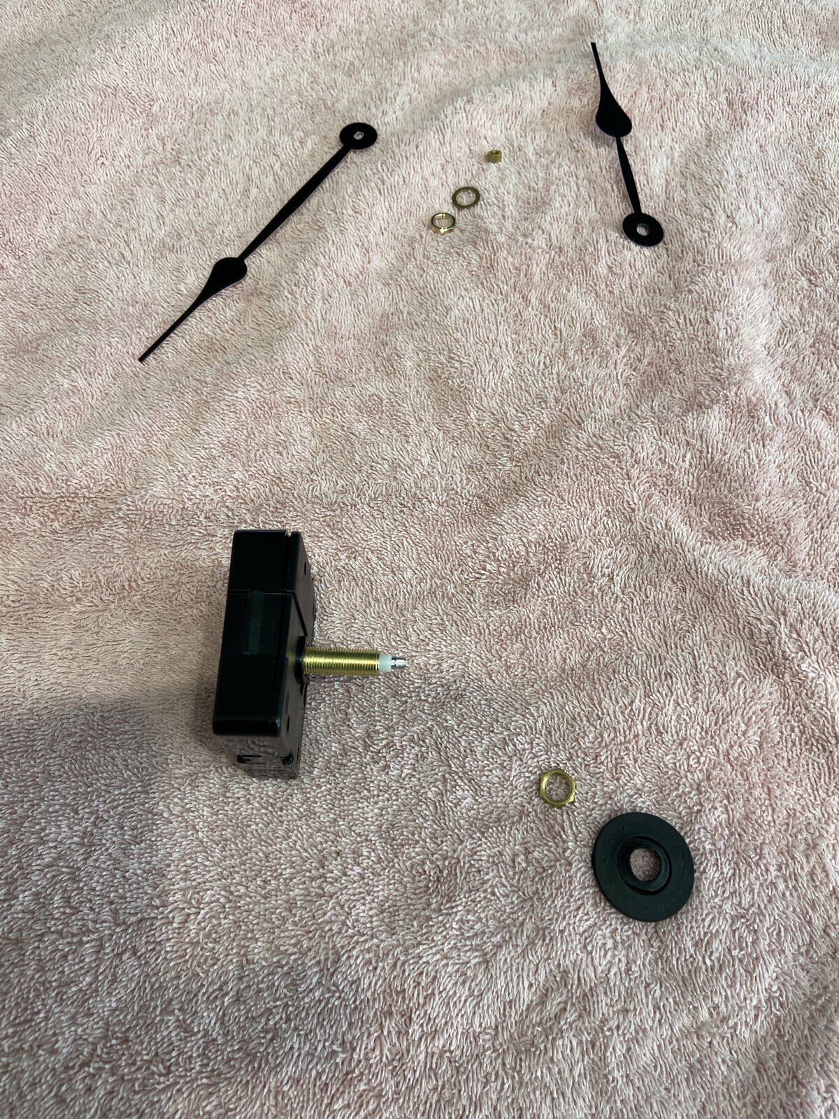

As we have seen above, you can find clock mechanisms from many sources. The basic clock mechanisms like the one in your photo come in a common size, but the stems do not. They vary considerably in stem length, to match the various thicknesses of clock faces.
-> The important point is to buy a clock mechanism whose stem length is the same as the stem length of the broken clock mechanism.

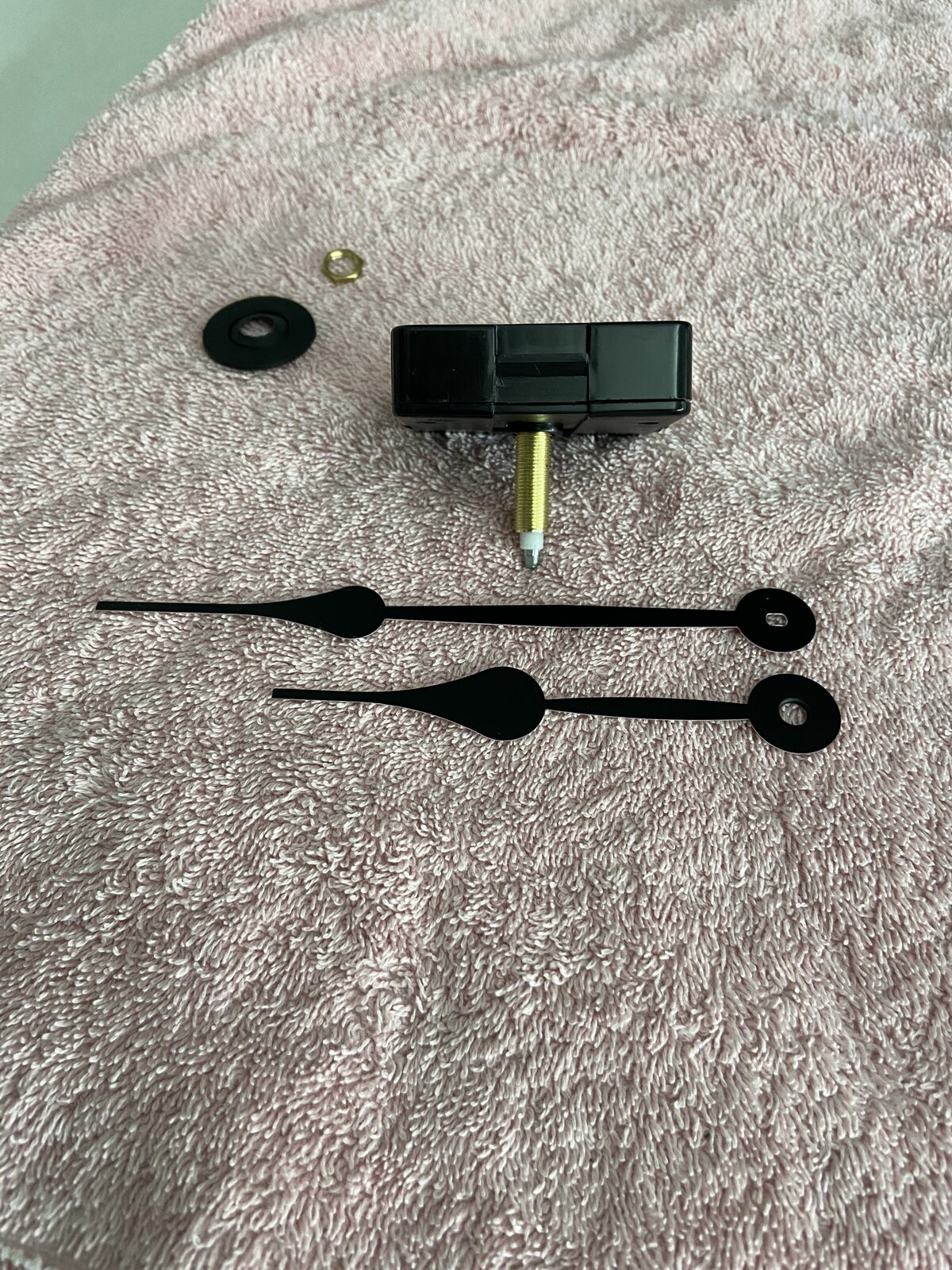

I did purchase the original motor replacement from the company the clock came from. For a few bucks more I know it'll fit. Regardless I'm having fun and learning something new. If I want to make a clock I now have some experience.

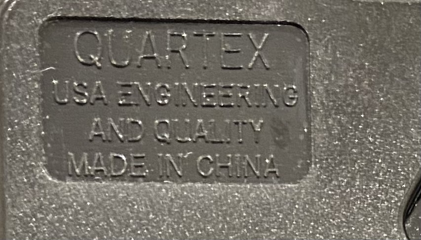

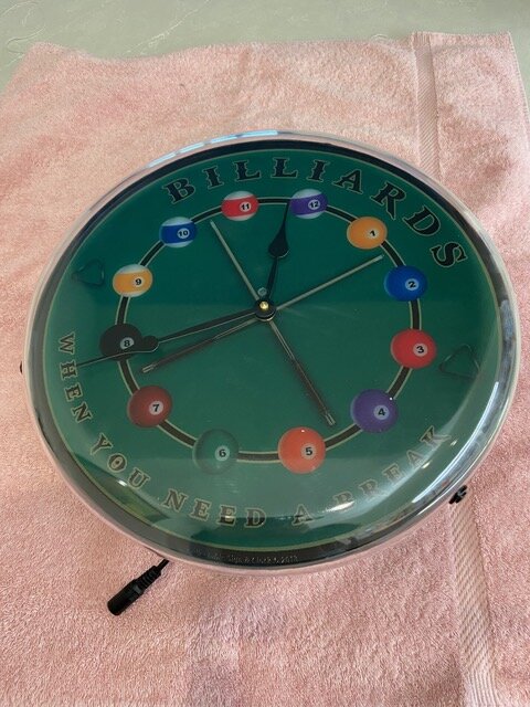

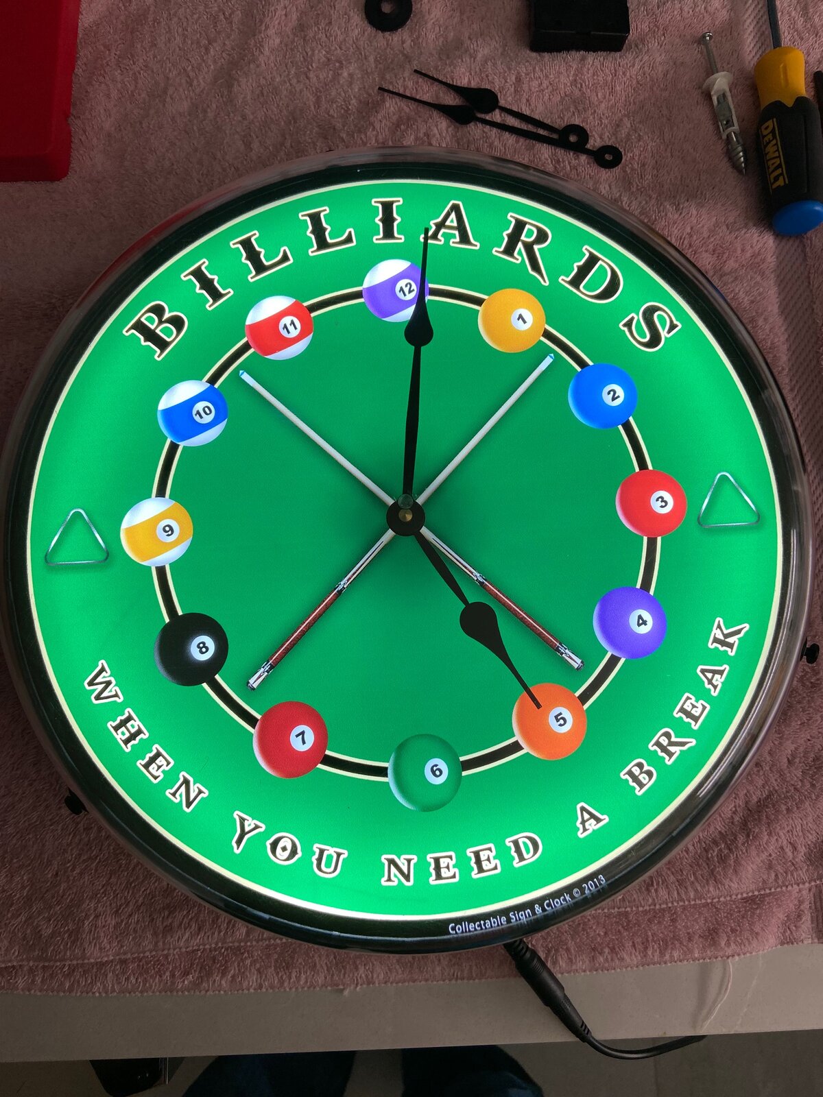

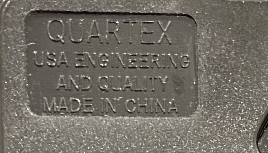

What is the name on the motor?
I got the motor today and back in business. It is cheap junk however I'll order a better one and use the one I just got for a small project

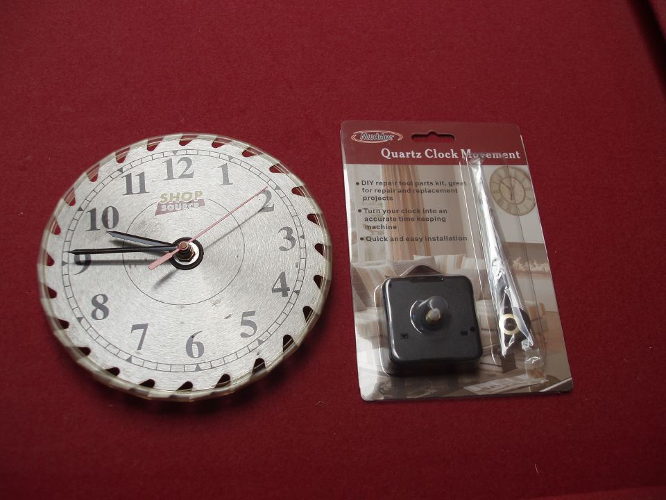

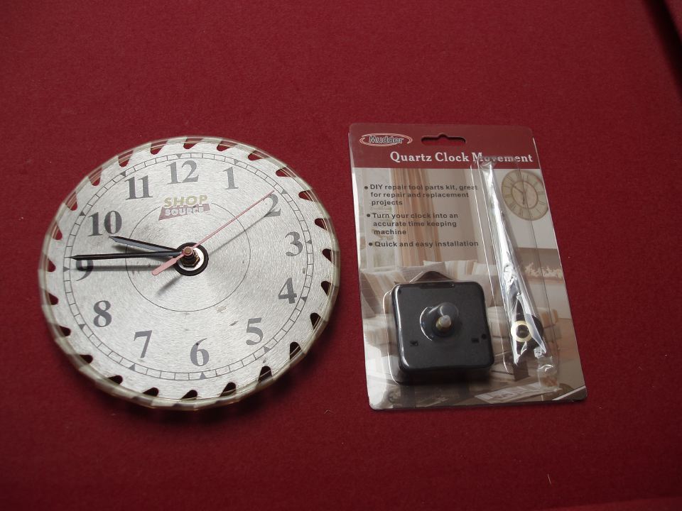

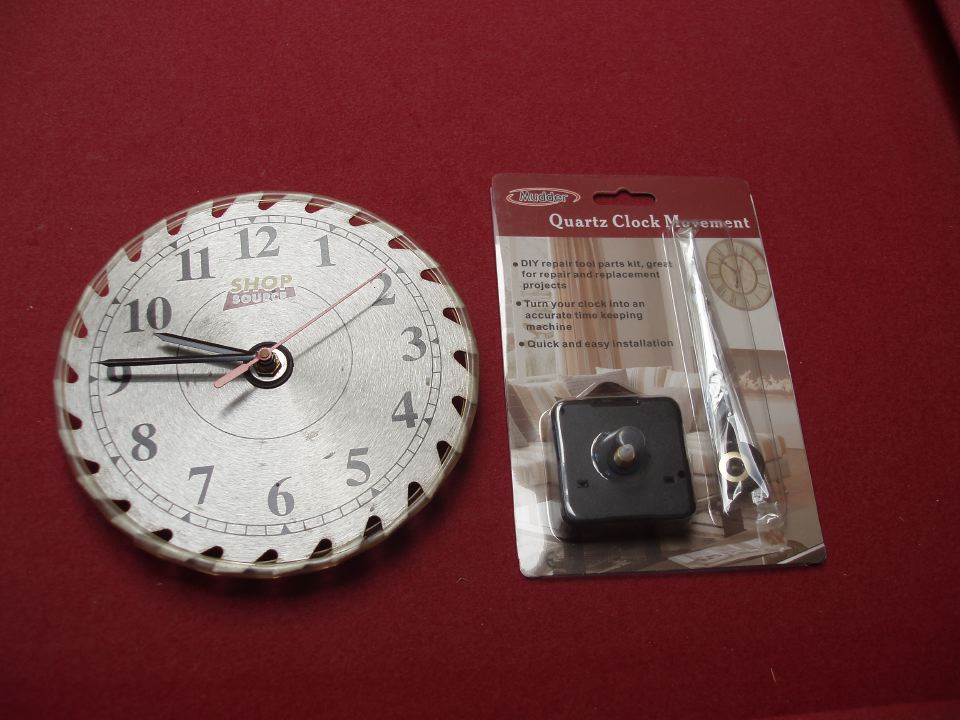

We have had a "saw blade" clock in our garage for many many years. The face is an ordinary 7-1/4 inch circular saw blade with a painted face. We have had it for a long time, but the mechanism is no longer reliable. I ordered a replacement mechanism which arrived yesterday. The mechanism I ordered is not the exact same mechanism, but it is comparable. The important requirement is that it has a hanger loop on the mechanism itself to hold the clock. Most clock mechanisms do not have the built-in hanger loop. You can buy a separate hanger for those other mechanisms if you wish.
Try this search:
https://www.google.com/search?q=saw+blade+clock&tbm=isch
Here is our clock. I added the protective strip around the teeth to make handling and mechanism replacement easier. Notice the "hanger loop" at the top of the mechanism. When I replaced the mechanism with the one in the photo, I discovered that the 7-1/4 inch saw blade has a small arbor hole. I didn't measure it, but it is close to the clock shaft size - maybe 1/4 or 3/8 inch. The clock shaft is "sloppy" in the hole, but close. I held the clock shaft "centered" as I tightened the nut, and that worked fine. It is now back in the garage and working well. If I had a 7-1/4 inch blade with a 5/8 inch arbor, I would find or make a washer to keep the clock shaft centered in the arbor hole.
