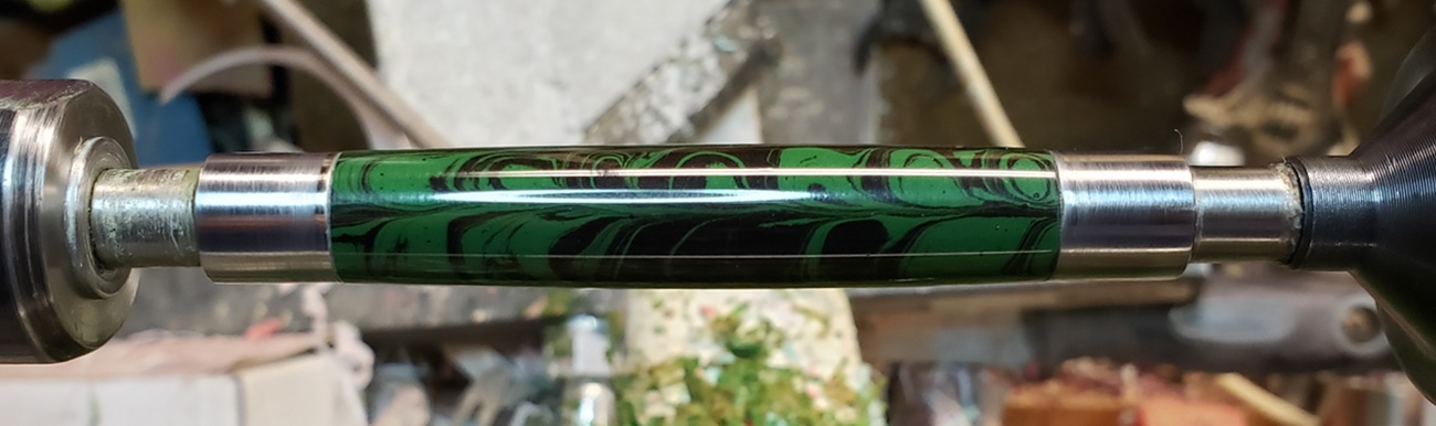

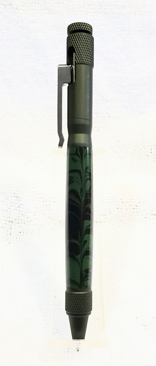

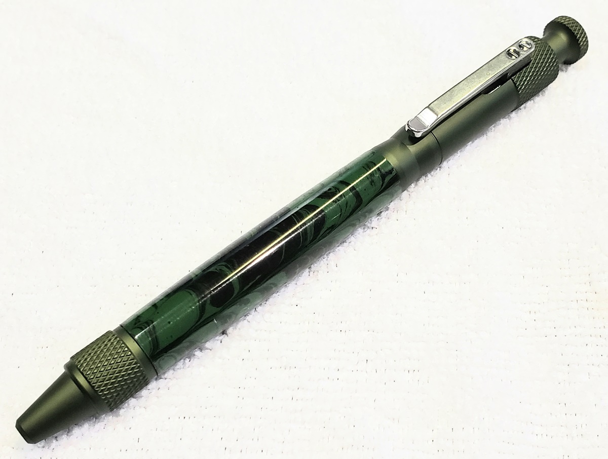

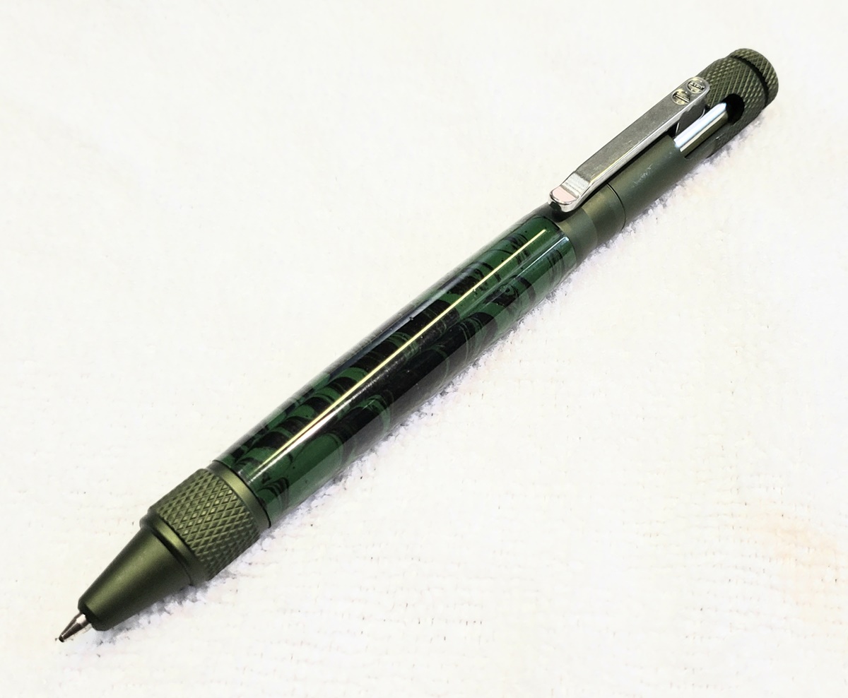

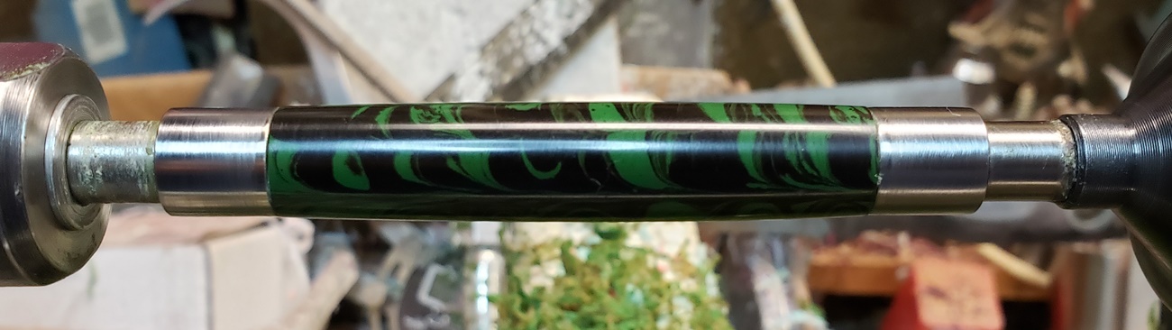

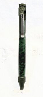

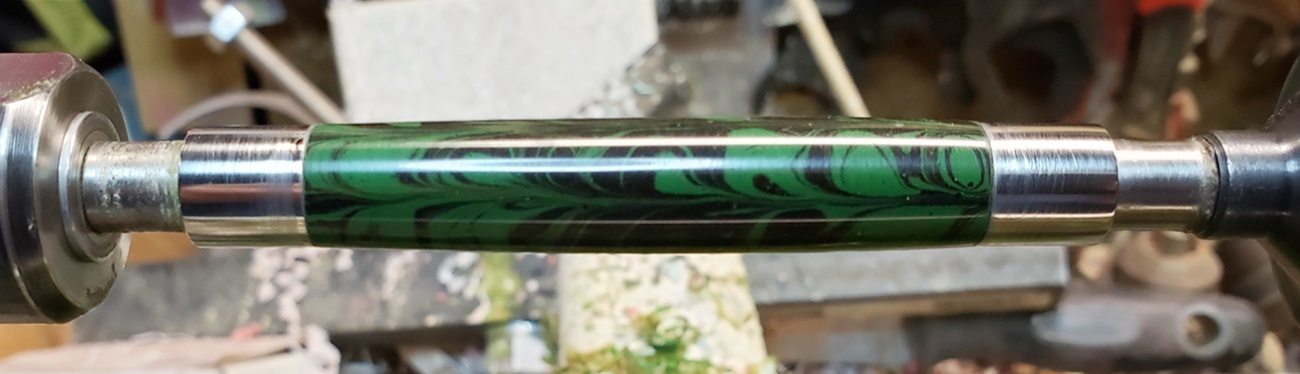

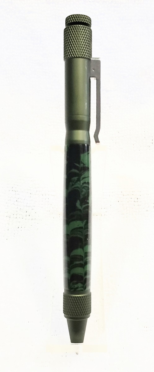

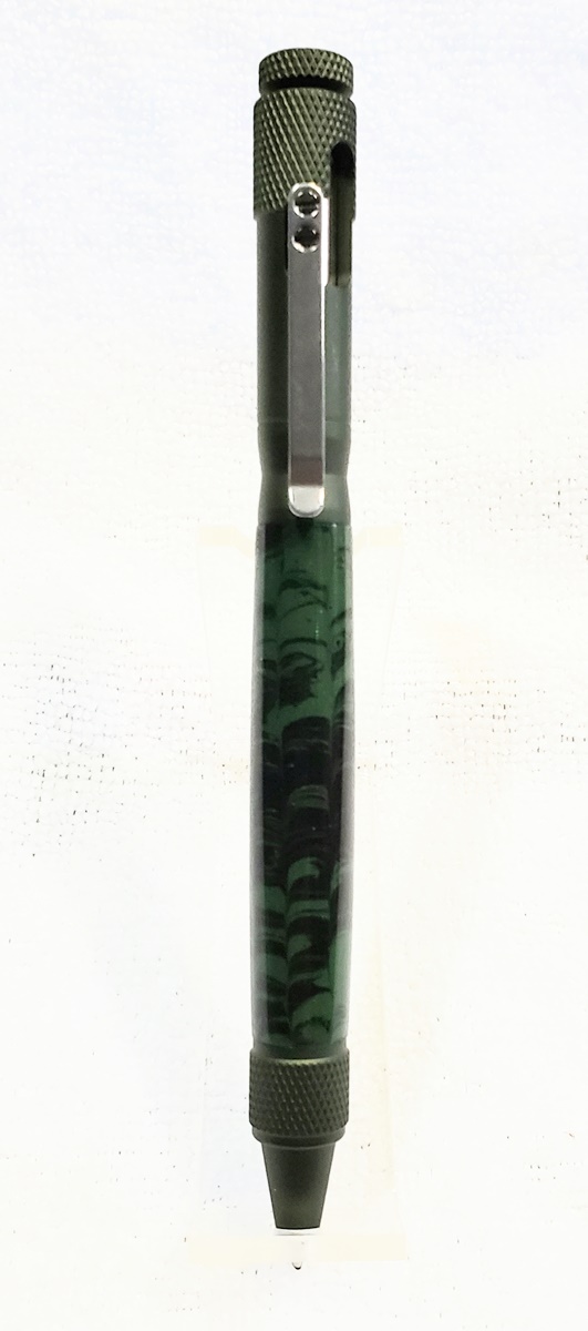

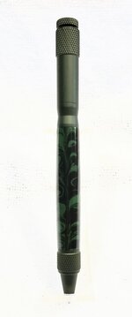

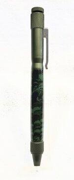

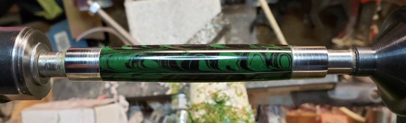

This is a new kit for me, the Clip Bolt Action from PSI. The finish is anodized green. The blank is also new for me, a black and green Ebonite. I wasn't sure how well the Ebonite would polish, but it didn't turn out too bad. Several members here recommended buffing wheels, but I don't have any, so I used my normal method. Wet sand with 100 grit, then 220-600 grits. Then the three Dr. Kirk's Micro Magic, and finally PlastX plastic polish. I must say I didn't like the blank very much as I was turning it, but I like it better as a pen.

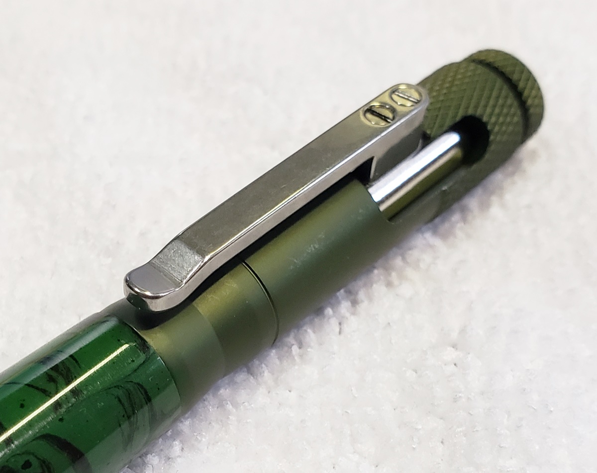

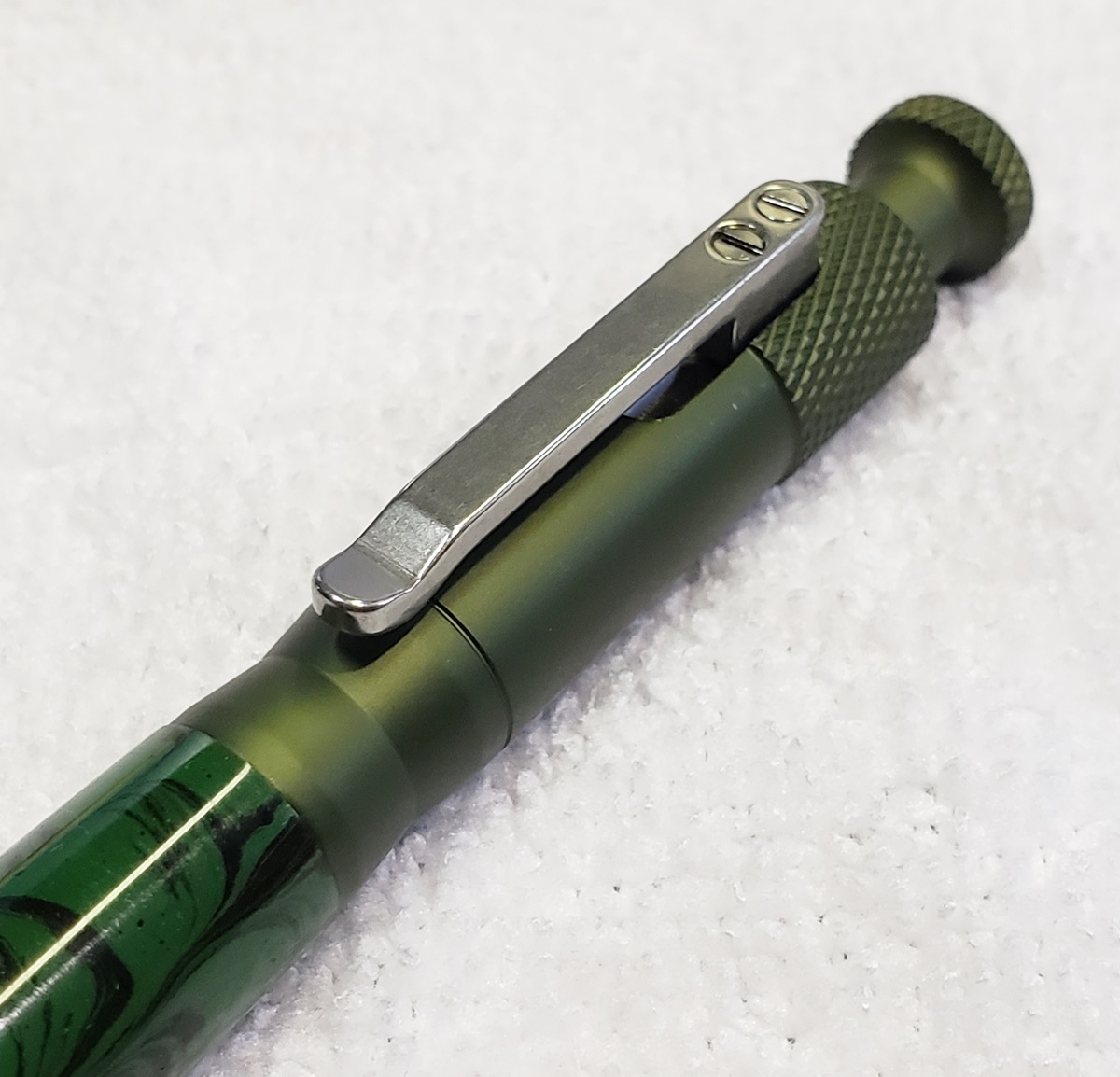

The kit is unusual in that you push the clip down and turn it slightly to extend the refill. I like that feature.

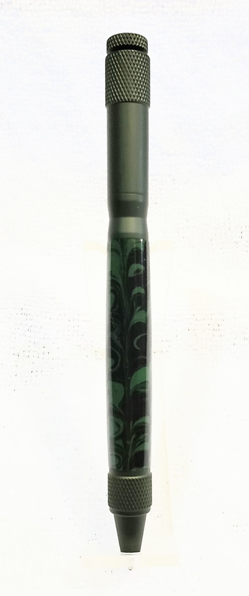

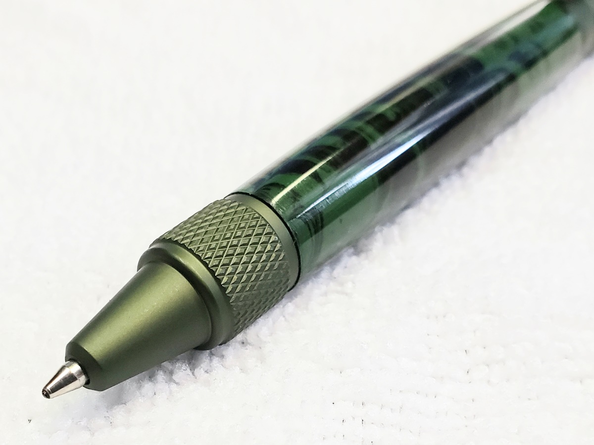

After I had initially polished it, I went back and ran through all nine grades of Micro Mesh followed by PlastX, to see if there was a difference. I can't see any.

I actually think that your pictures do show some improved shine from the final micro-meshing.

Can you also extend the refill by a push-and-twist on the finial ?

I like the green too. As for weird, I agree, but I still like it. It's the quick-draw pen!
Well, I'll be darned. You can extend it with the finial. I didn't think to try that.

Well, if you don't understand the "crypticity" of "additional functionality", here is another line from the instructions ....
• Refill can also be advanced by pushing down and twisting the top button. A quick twist in the opposite direction retracts the refill.

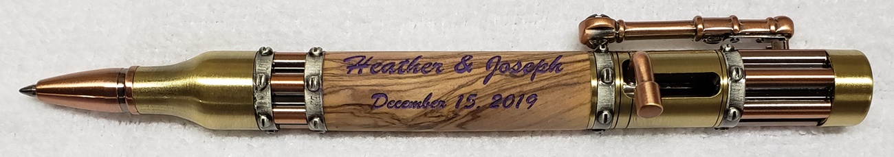

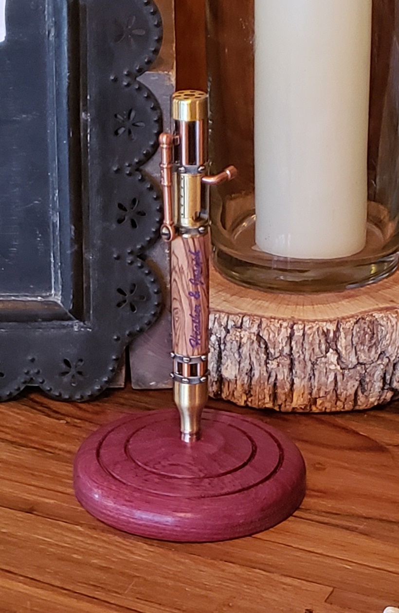

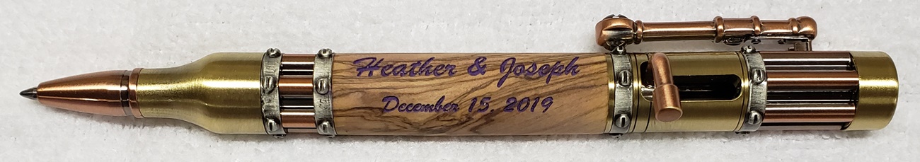

I've heard a lot of disparaging comments about PSI, but I like them overall. They have some cool kits. I made a Steampunk pen for my son and daughter-in-law's wedding pen. It fits her personality perfectly.
