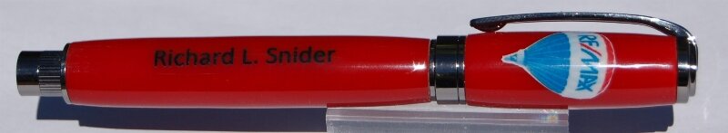

Job I did for a client being delivered next week. Name was laser engraved and filled with epoxy black paint. Logo is a water slide decal.

are you putting a coat of CA over the water slide decal Alan? Your pen looks great! Im getting ready to make a couple of pens using these components as well!
Dude, no offense, I promise, but zoom in on the photo and you will notice that the decal and the fit to bushings don't work at all. I love the concept........the execution is lacking. Jack up the fit and craftsmanship (and price).
Do us proud, get rid of the "fuzzies" (decal), and trim to the bushings. Then put a 250$ price tag on it.
And notice that in the side view that the decal is not centered in the space between the bottom of the pen and the clip?
At 250$ (or more), these guys will pull a loupe out on you, Be pepared (offer them a loupe). Go big,or stay home, but nice attempt. (and good photography).
(attention to details will net a 1,000$ pen,)
