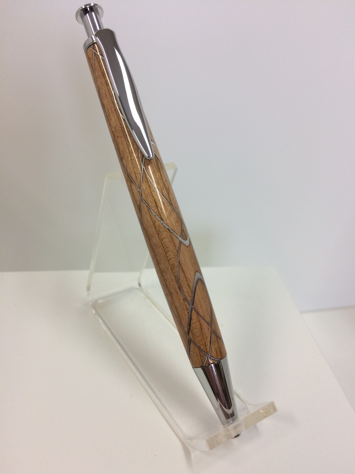

Haven't posted anything recently. Not because I haven't been making anything. More because most of what I've been working on was for shows, etc. They're done and I've been experimenting with aluminum cans. This is my first try. It's a CSUSA Clicker. Oak with Coke can swirls.
attachment.php
I like the results but have a question for those of you who have done this type of work: if you zoom in, you can see what appears as a "ragged" edge to the aluminum. Is this normal or is there a way to avoid/correct this?
Thanks in advance,
Thanks in advance,
I have used cans, and have seen the same issues. I ended up using thicker/sturdier metals, but then you have the issues of the thickness that gets too pronounced when turned on the curve (my terminology is not quite correct, but you know what I mean).
Maybe the very thin aluminum in the cans nowadays (which have gotten very thin) tear rather than accept cutting and sanding? Hopefully others will chime in.

I have had the same problem with Drink Cans, I even tried combining and backing up the Can Aluminium with some of my Wife's Fractured or Burnt Out Credit Cards (Plentiful Supply of them). :biggrin:
But I had the same problem of the Random Ragged Edge. :eek:
So I think Mark's comments may well be the answer. :rolleyes:

Ted, count me in with the group that has had issues with thin sheet aluminum "tearing". I minimized....but not eliminated the issue the last time by turning the blank 180 degrees between sharpenings as I turned it. Not totally satisfactory, but once you're in the pool, ya swim the best you can. Keep em turnin' brother.

I suspect that the aluminium is getting smeared for a couple of reasons. It appears that the kerf is a tad wider than the thickness of the can. If the glue is softer than the ali, then it will squash the glue or perhaps your tool needs to be a bit sharper.
I like using CA for inlays like this as it is harder than the metal.
What glue did you use?
Great effort though.:good:

You MAY be able to avoid that type of tearout by stopping your turning short of that point and sanding the rest of the way, but I would only try it in stabilized woods or in acrylics, as the aluminum dust is black and would get all over the wood pores to discolor the wood! :(

Brian - yes, with 4 passes on the band saw there will be some (minor) misalignment. Those darn, pesky kerfs! I tried to minimize it by doubling up the aluminum. I was actually quite surprised at how thin those container walls are.
Skiprat - I used CA. It's a StickFast formulated (they say) for dissimilar materials. No issues with that. Tools were sharp - I'm a bit of a nut that way. I usually sharpen everything used. Sometimes during but always at the end of a session.
Brian (bp) - never thought about rotating. Think I may try it.
I'm thinking that a good piece of the issue is the kerf being wider than a double layer of soda can aluminum. I'll either try 3 layers next time or look into using something thicker. I may have some flashing left over from a roofing project.
