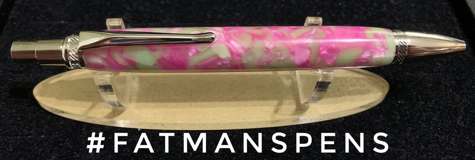

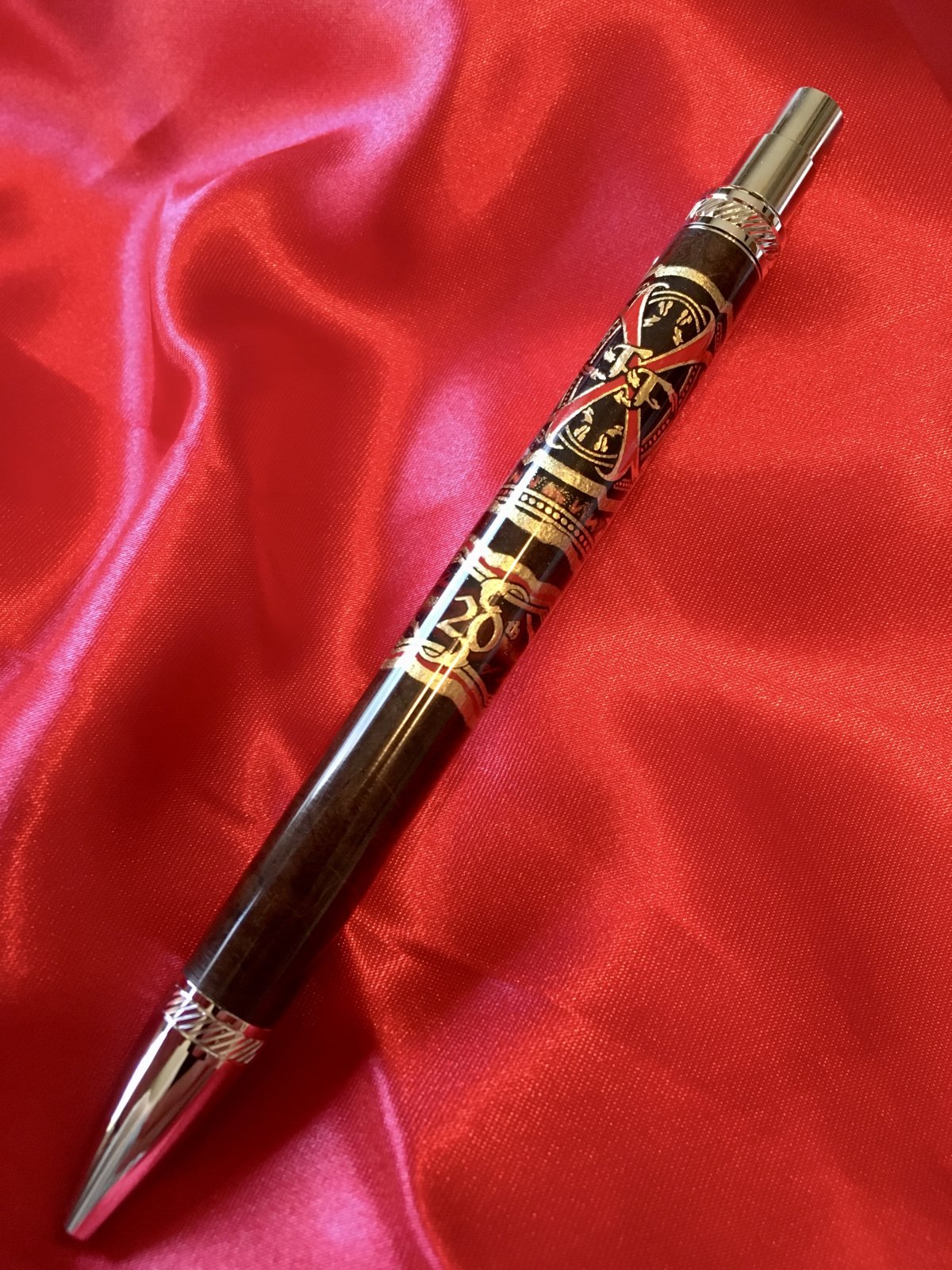

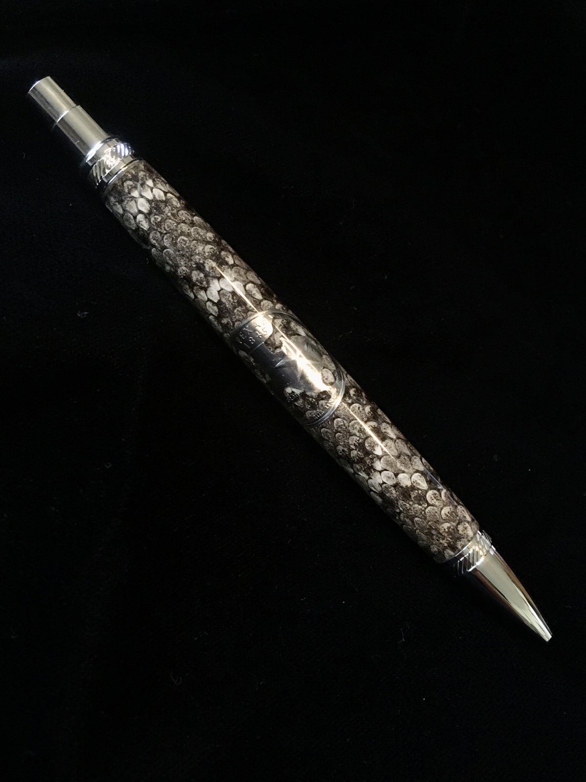

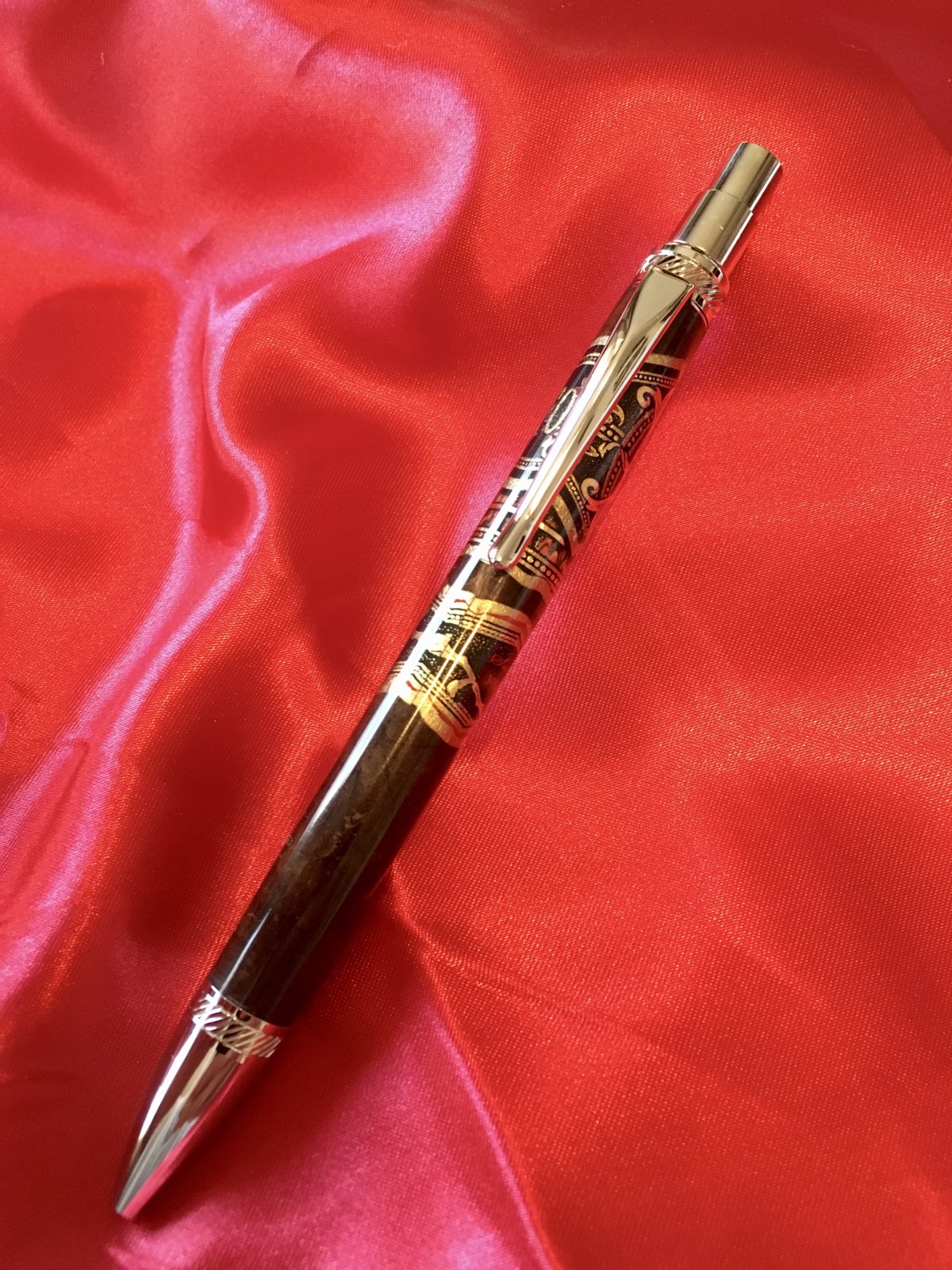

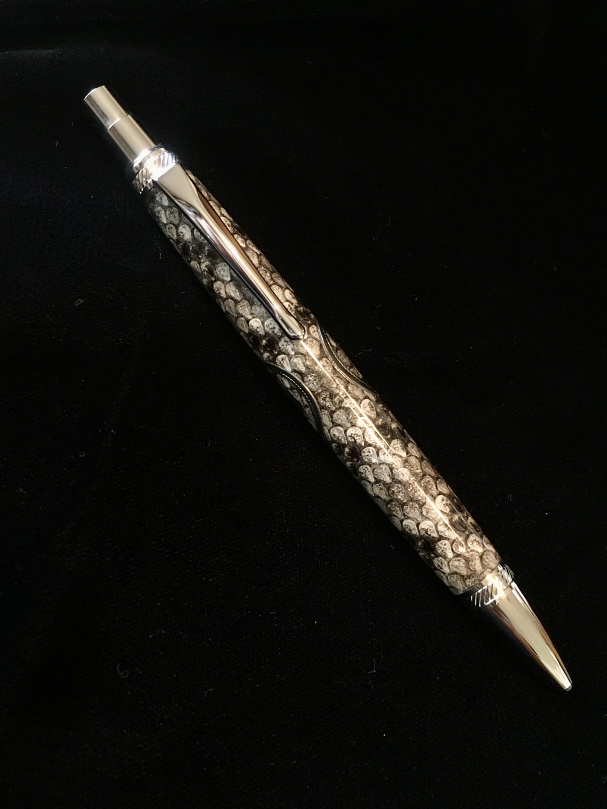

I asked for one that showed a lot of the blank for my cigar pens. The Blade or Tenacious, same kit different suppliers, is what I settled on. It has a great solid feel with a smooth click operation. It's a very nice kit and pen.
Sorry I hit the wrong button trying to upload the pictures.

Kenny I am liking that for a few reasons, the barrel looks beefy enough to support some segmenting work and also long enough to show off some nice blanks. Does it have that little plastic piece that people talk about and where did you get those??
I just checked a few vendors out and found them. The 2 I like are chrome and gunmetal. Lets see what others think but this is a good start.
Those are both nickel plated. Berea and Woodcraft is where I bought these. The click is a Schmidt or something like that. I can get out of this site to check the name and I don't want to start over typing.

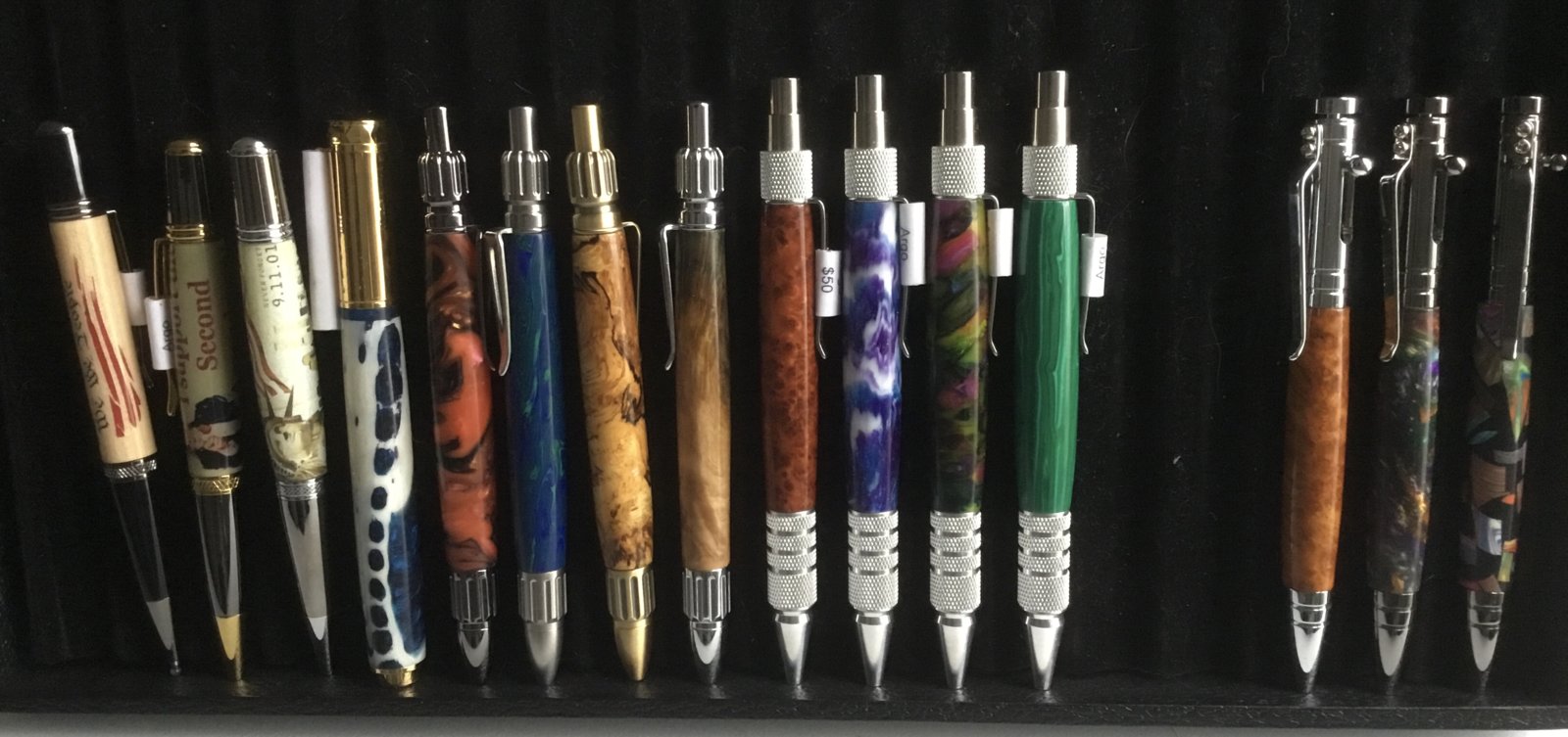

The two I've made so far are Duraclick EDC and the.Classic the Dura click are on the right. Classics on the left
