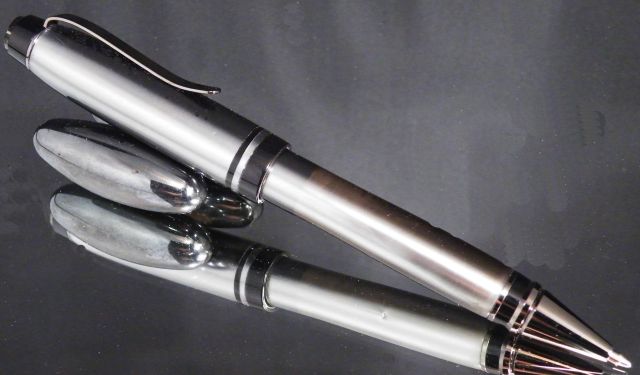

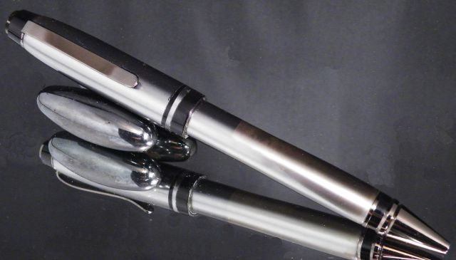

This is a modified cigar pen . It is a Cap actuated click cigar pen . The blank is one of Ed and Dawns imported metallic silver acrylic blanks and the click mechanism is from Richard Greenwald . I used a Black Ti cigar kit to match the blank and the CB is some homebrew Black PR
As always , comments are welcome .

Thanks guys . I got the inspiration when I was making the Green finial operated long cigar pen for my son last week . I've never seen one before either , maybe I should Patent or Copyright it ? :devil::wink::biggrin:
I had to turn the lower barrel almost totally bushing to bushing (but I didn't use any bushings :biggrin:) so the upper barrel slides smoothly over the bottom barrel . I used the cap click mechanism from Richard Greenwald http://richardlgreenwald.com/ .
Both parts of the pen are drilled half way with two different sized holes , 10mm for the tubes that hold the nib and finial/clip/actuator tube and 9/32" for the tube I threaded for the click mechanism in the lower barrel and 1/2" for a Ligero upper tube that slides over the body and holds the CB together .

Thanks for the kind words everyone . This one was another fun one to design . I blew up the first try at it when I got a little aggressive while turning it down to final size .
I get more of a kick out of making modified or kitless ballpoints then kitless fountain pens because there are many more problems to work around with these .
The mechanisms I've been buying from Richard are good , high quality mechanisms and are adaptable for many different designs but keep in mind that they DO NOT come with any instructions so to use them successfully you have to design your concepts around them . Here's the link to the one I used for this pen http://richardlgreenwald.com/mechanisms-p-28.html .
I'm working on a design for another different modified cigar pen using this mechanism .
