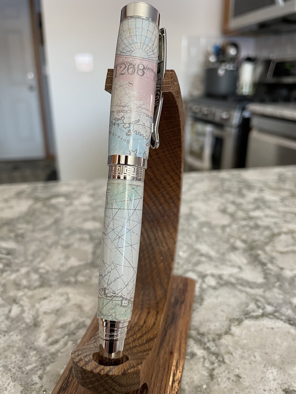

I did this one a few weeks ago. Map is cricut vinyl. Casted with Aluminite clear slow. I'm very new to casting but I had no troubles with this one.

Your double tube chart looks great.
I haven't tried Aluminite slow- but then I thought you likely needed a pressure pot to get bubble free castings with that .
But maybe I'm wrong & just haven't thrown enough money at the problem :-O

I did put it in a pressure pot, forgot to mention that.

That's beautiful! Where did you get the map?
At Hobby Lobby, where they sell Cricut vinyl, I think this is their Paper Studio brand, but don't hold me to that. It said us was removable, which I wasn't sure would stay stuck down, but there were no issues.
