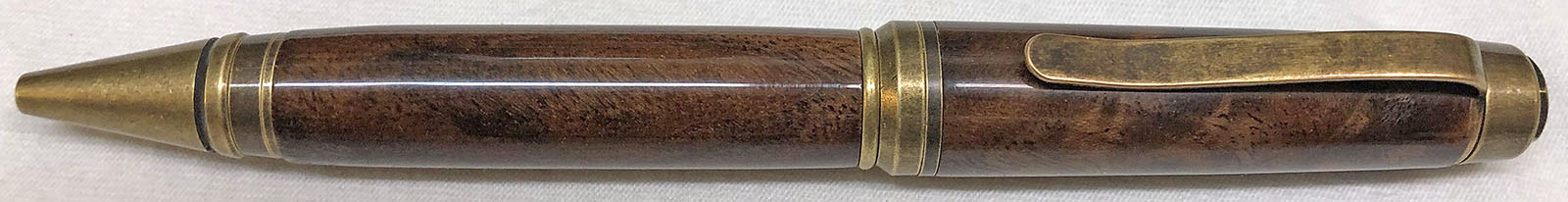

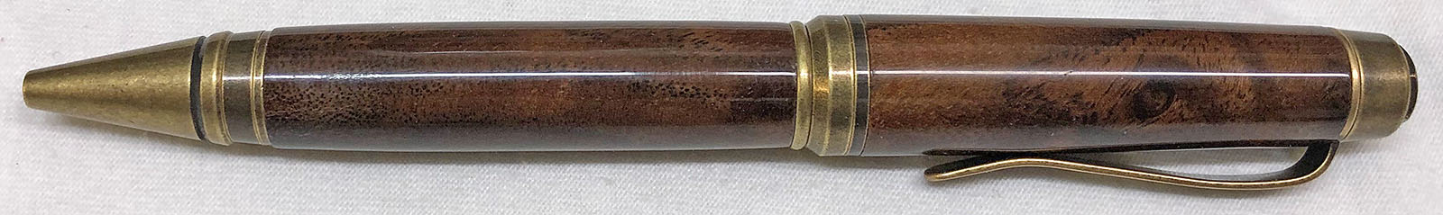

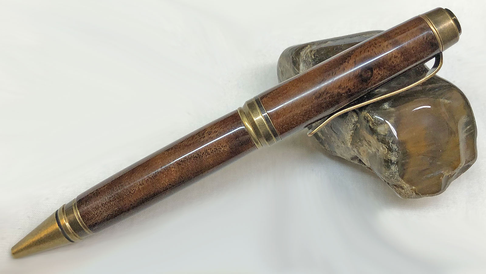

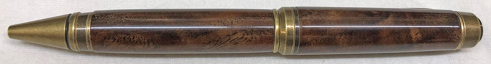

Greetings all:
I finally finished the pen I mentioned in my earlier thread about having spare tubes on hand. It is a Brass Cigar kit from Exotic Blanks and a Claro Walnut blank that was cut from a block I got at WoodCraft. I think the combination gives it a very rustic look.
I overturned the first set of blanks, but this set on the spare tubes turned OK. In addition I really struggled with getting the finish on this one. I had to repair and re-finish the blanks before I was done. The CA "lifted" on the ends of the blanks leaving that dreaded grey-ish appearance near the ends after wet sanding with MicroMesh even though I used a blotter of thin CA to seal the ends up before MicroMesh. I haven't had this kind of thing happen for several years, ever since I started making sure the ends were sealed up before wet sanding. Anyhow, here are a few pictures of the completed pen.
Regards,
Dave
PS I always use Ed's Improved Fit Bushing Set (11A) when I turn Cigar Pens. They make a much nicer fit between the center band and the lower blank than the standard Berea Cigar bushings.
