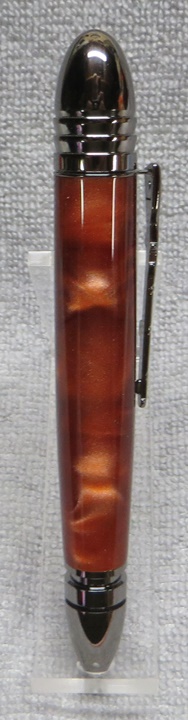

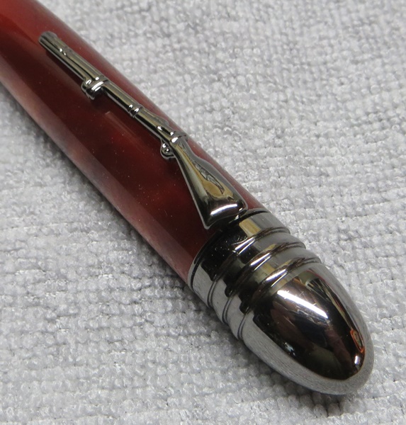

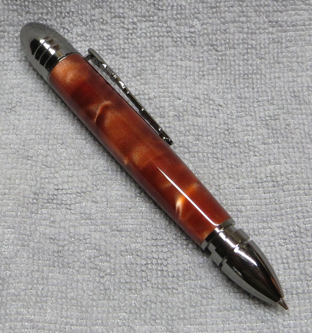

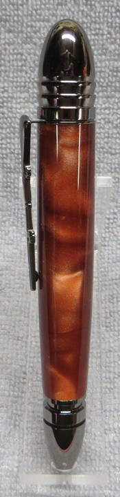

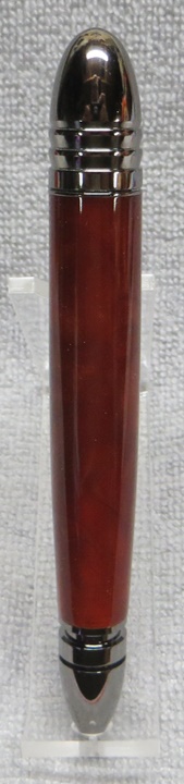

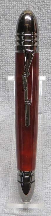

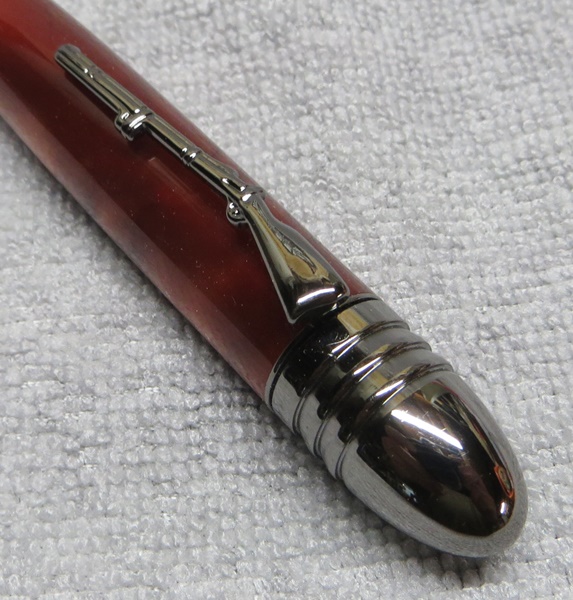

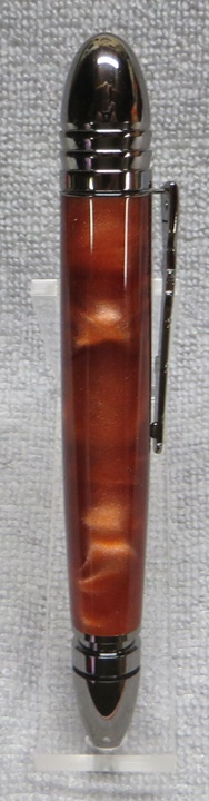

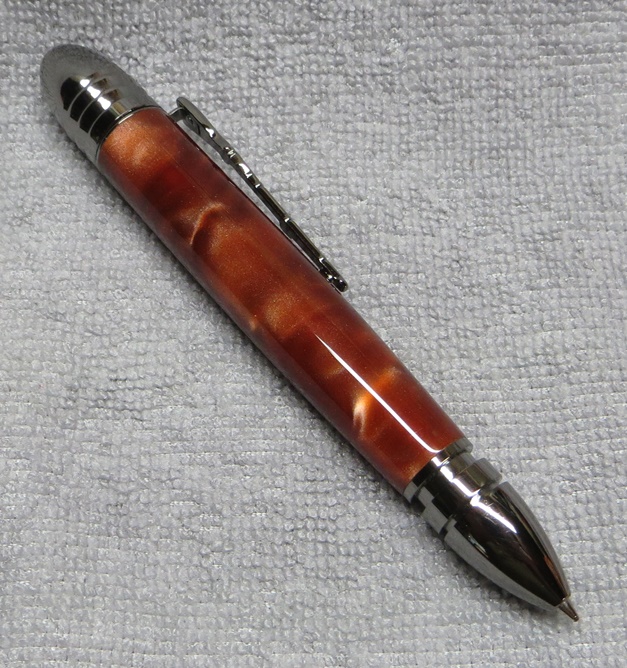

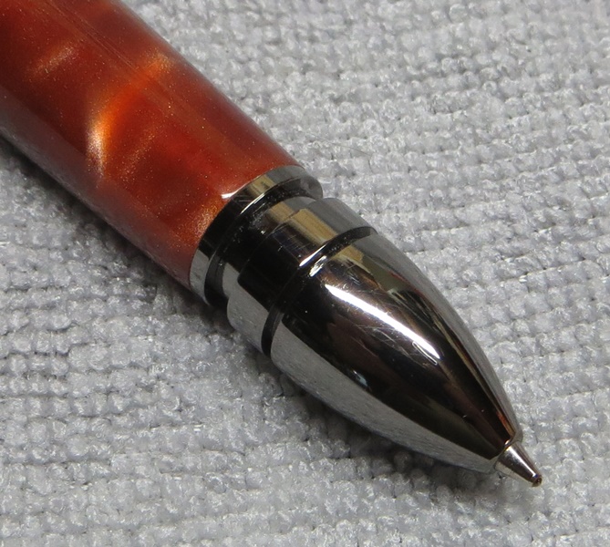

This is a Civil War pen from PSI, in gunmetal. The blank is called Cosmic Copper, also from PSI. The blank isn't as stunning as I'd hoped, it's more muted. But a good looking blank, nonetheless.

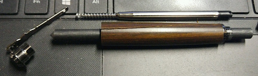

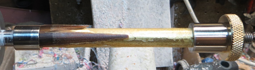

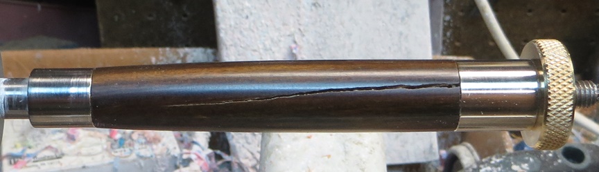

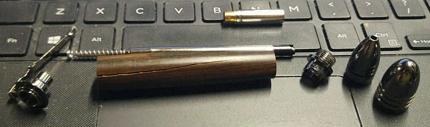

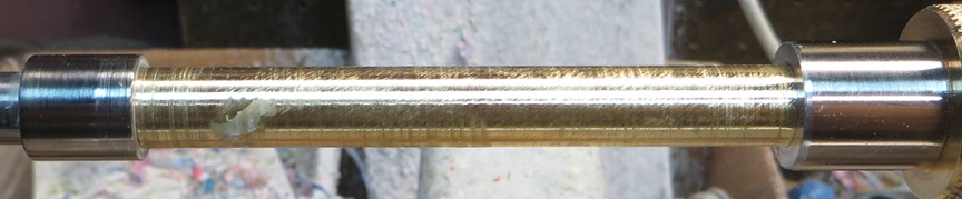

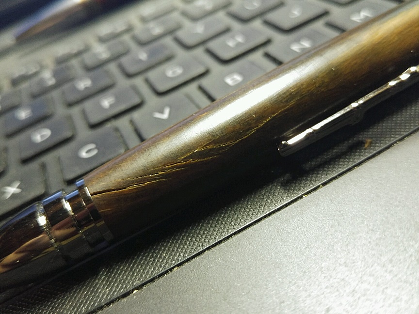

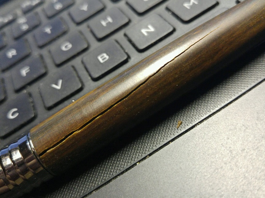

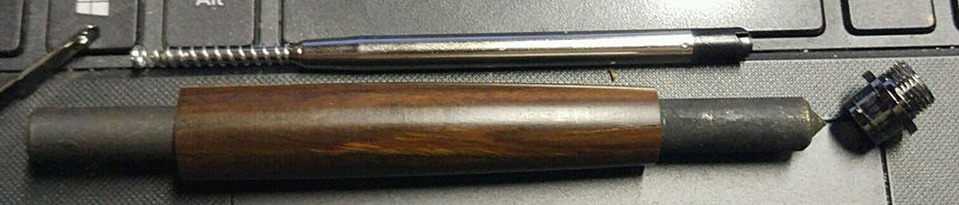

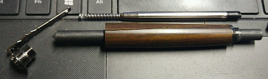

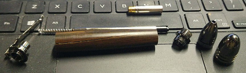

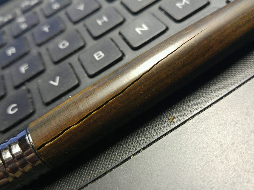

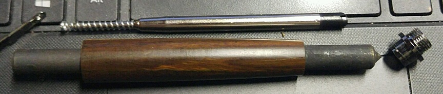

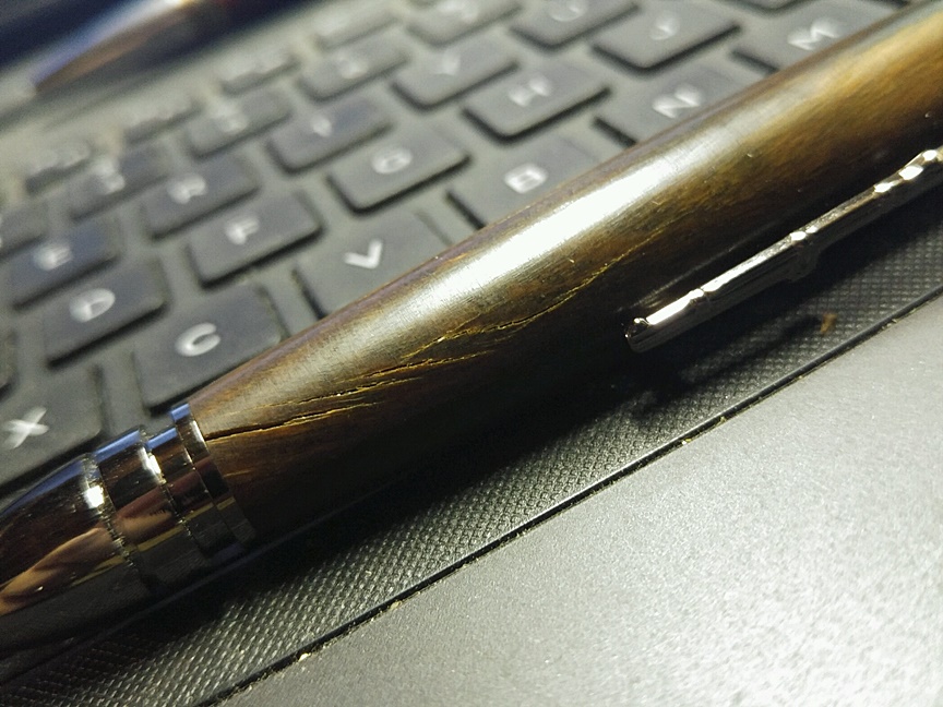

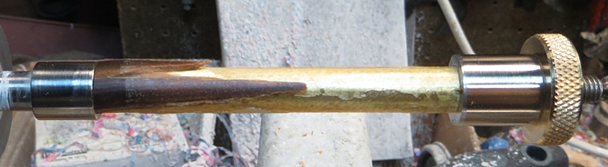

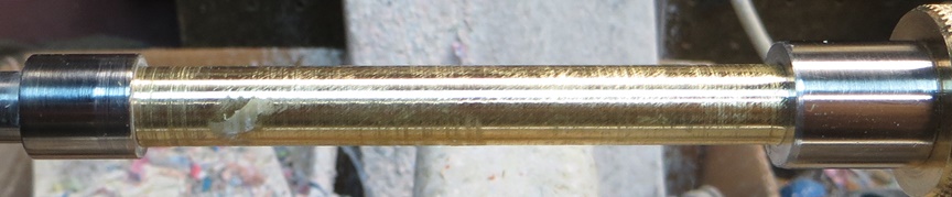

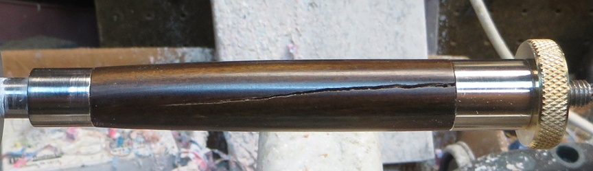

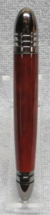

This pen is actually a do over. I originally made it a few months ago with lignum vitae. It developed some bad cracks, so I decided to redo it with acrylic. I was able to disassemble it with transfer punches, and turned the wood off the tube.

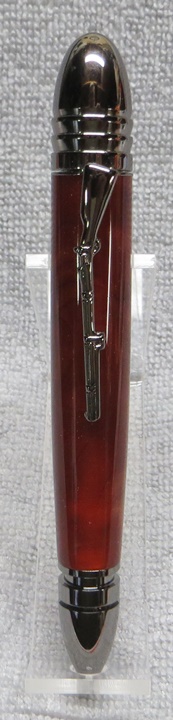

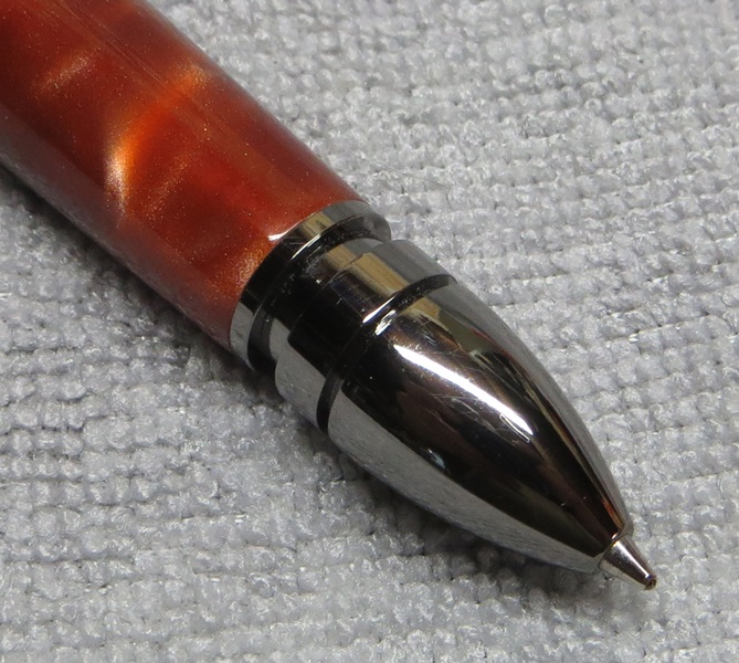

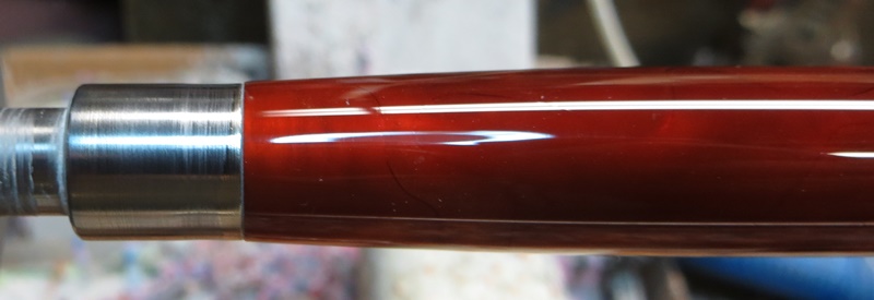

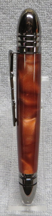

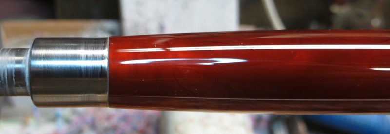

I didn't paint the tube or color the epoxy, and you can just *barely* see the tube at the narrow end of the blank. But it's not bad enough to worry about. If you didn't know to look for it, you wouldn't notice it.
