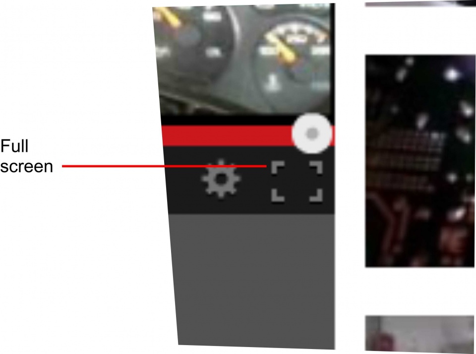

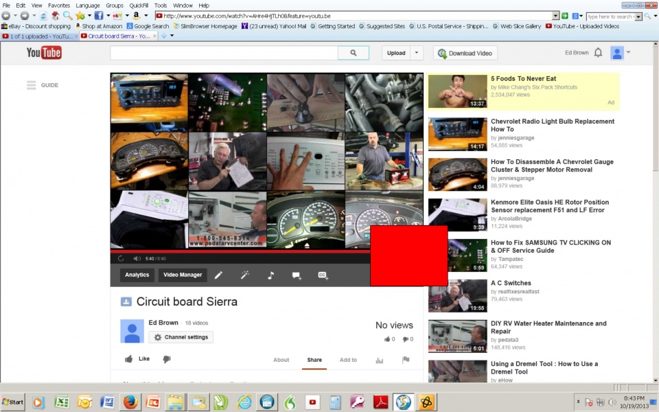

Something you all may NOT know, you can watch YouTubes on full screen on your computer. Here is a picture of the screen as you normally see it, along with a blow up of the full screen control. Once you have the full screen image, you press escape to return to normal size.
