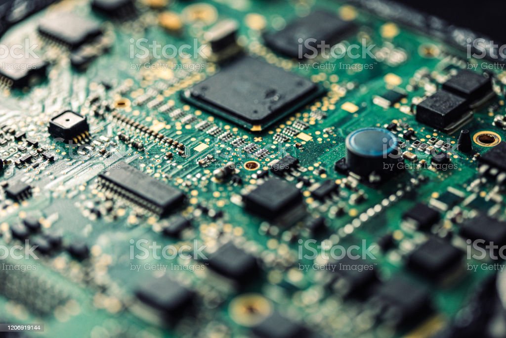

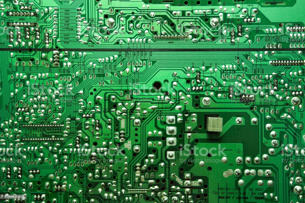

Start with an image like the one here obtained from the hundreds of photo sources on line . This one came from istock photo

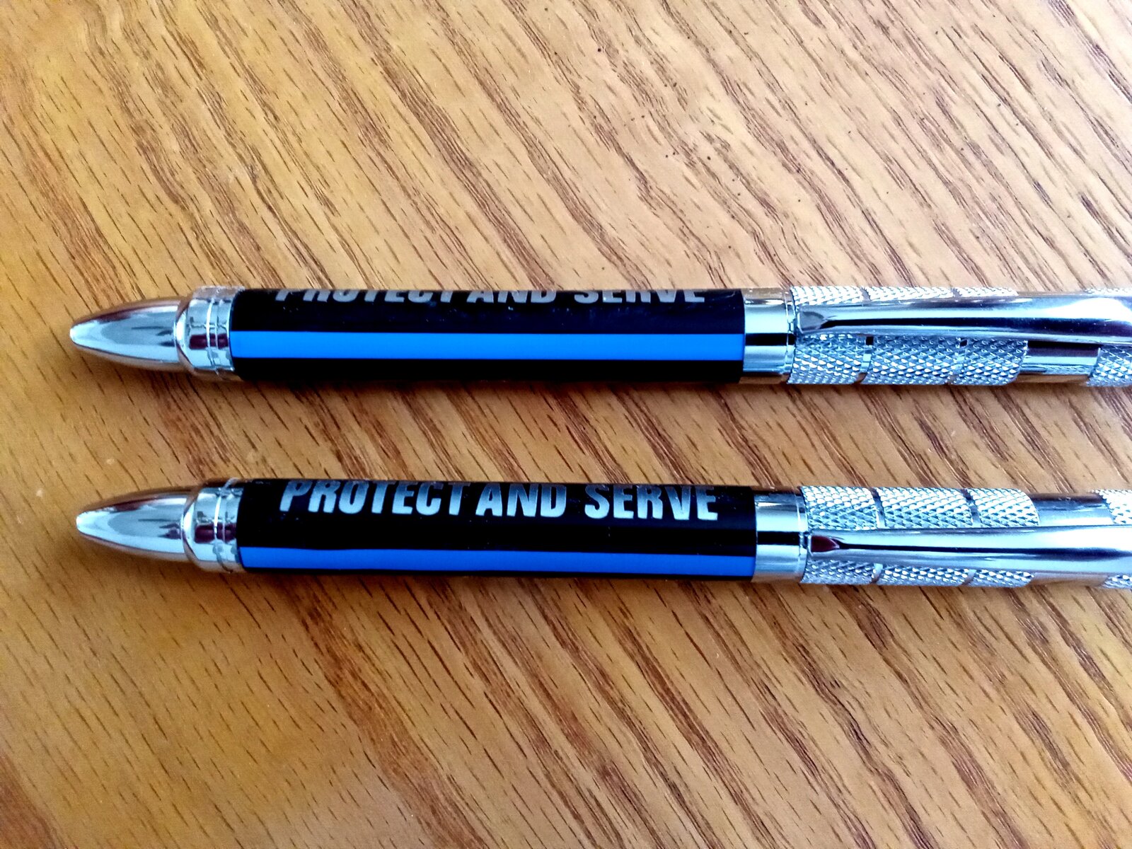

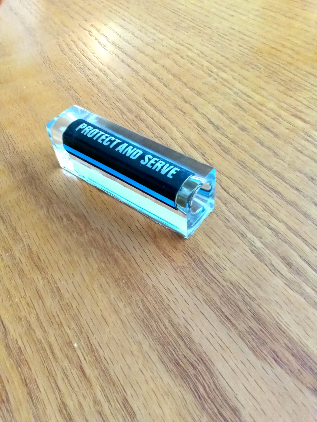

I have not done this with the water slide decales yet but I have done it with cut vinyl transfer the picture here is a police pen made with the cut vinyl method. The water slide decal would be no different and actually better as you can have unlimited colors from a printer.
