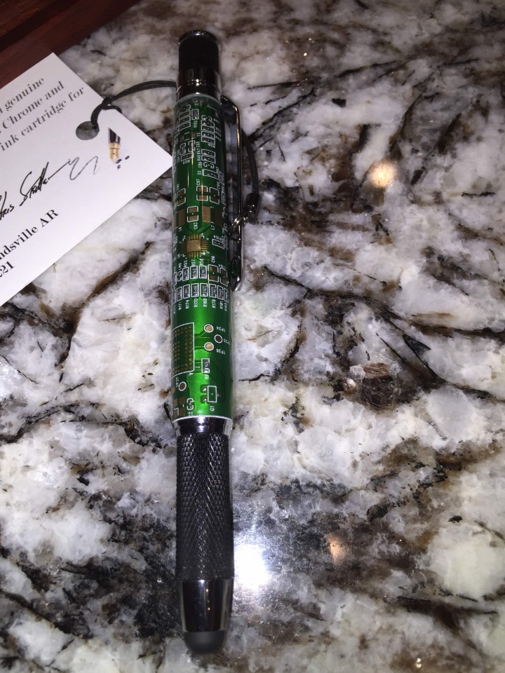

I'll throw my two-cents worth opinion in on this discussion. I have turned several CB pens and have used the traditional green, black, white, and red. In my opinion, the red looks great with a brass or gold pen. I have turned several red CBs with brass raw pens and they looked really nice. however, when I am turning for tech folks they like the traditional green - with all of that being said I have had great response with the green cb and a chrome Knurl Twist with a stylus tip.
http://www.penturners.org/forum/attachment.php?attachmentid=173383&stc=1&d=1519226484

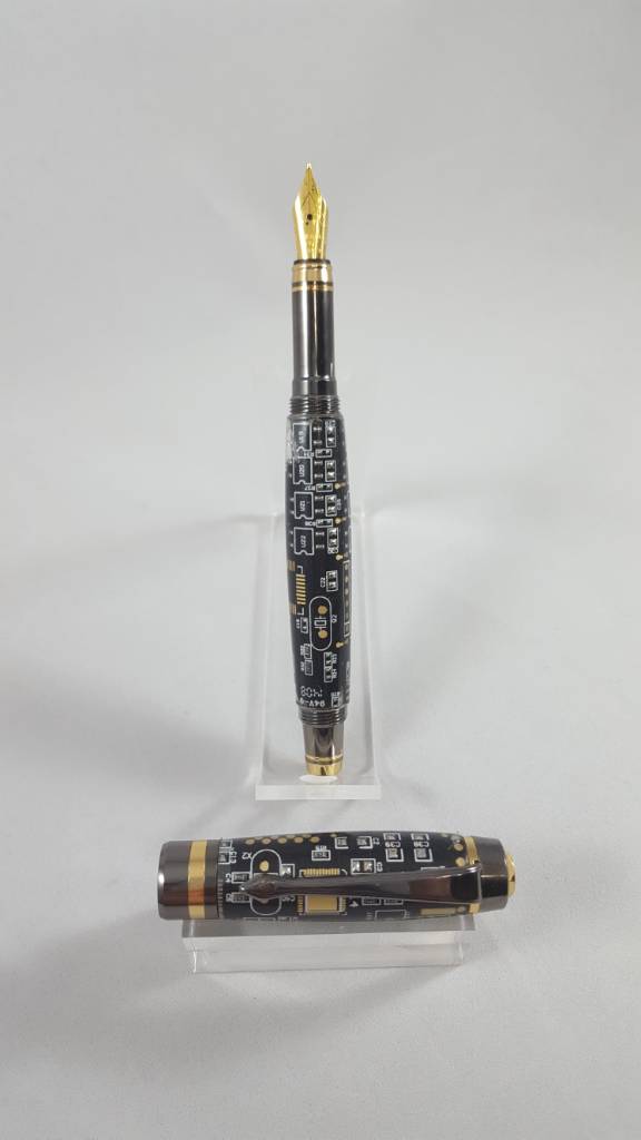

Here is the Classic Elite. We are struggling with getting the 3/8" blank to work with the V sized bushings. Any tips to get it to work would be appreciated.
Unfortunately, Rebecca hasnt learned to turn using the calipers yet.
Sent from my SAMSUNG-SM-G890A using Tapatalk
V-size drill diameter = 0.377"; 3/8" = 0.375". . The brass tube outside diameter will be something like 0.365"; inside about 0.348" ...
... just close estimates.
You don't need calipers for this job, really, although calipers are always useful, and, in my opinion a must-have.
The Classic Elite kit pen parts are slightly over-sized for the 3/8" tube inside diameter, but only very slightly ... about 0.002" approx.
You can enlarge the inside diameter of the brass tube slightly using sandpaper wrapped on a rod.
If you end up enlarging too much, a little bit of glue (epoxy, I would say) will take care of that.
Let us know if you need any more advice. That includes Math and Science homework !!
