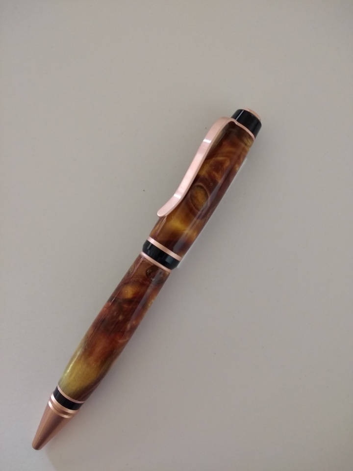

Especially on a pen. I was fortunate to win a box of blanks from Phil Weiss (PKweiss) in the Losers Train drawing. This was one of the blanks he cast. Cinnamon sticks! :wink: They really made the shed smell better:biggrin:
We have here a Satin Copper Cigar from Beartoothwoods. I went ahead and put some CA around it, and polished it up some.
Thanks Phill! And watch for a couple more. Thanks all for looking!

I've got a few of Phil's cinnamon sticks in the shop--don't know if I can give them the justice that you did, very nice pen!!

Thanks Earl! Give one a try. I got some bronze model paint for the inside of the tube. Other than that, just turn as normal. Light cuts. :wink:

Well--long after I should have been in bed last night, I tubed a cinnamon blank for a Caballero...just so the epoxy would be dry for a morning turn. What a great way to start a Saturday morning, but stopped twice to make some cinnamon toast!! Finish is drying now--should be able to assemble later today. Thanks for the inspiration!!
