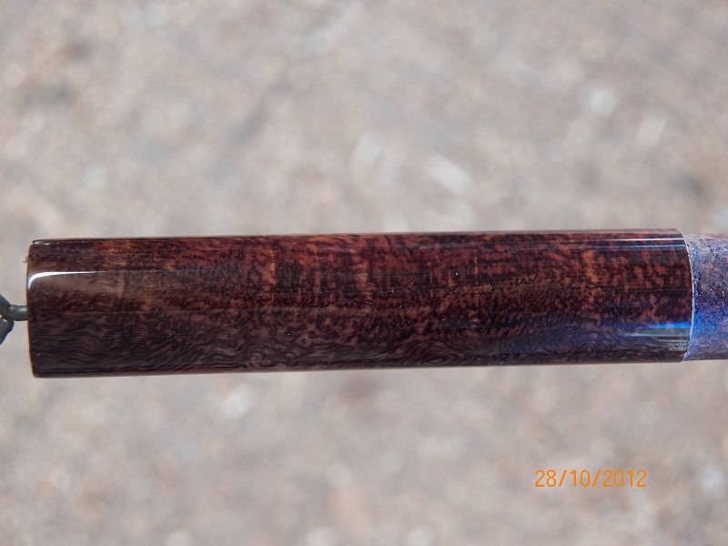

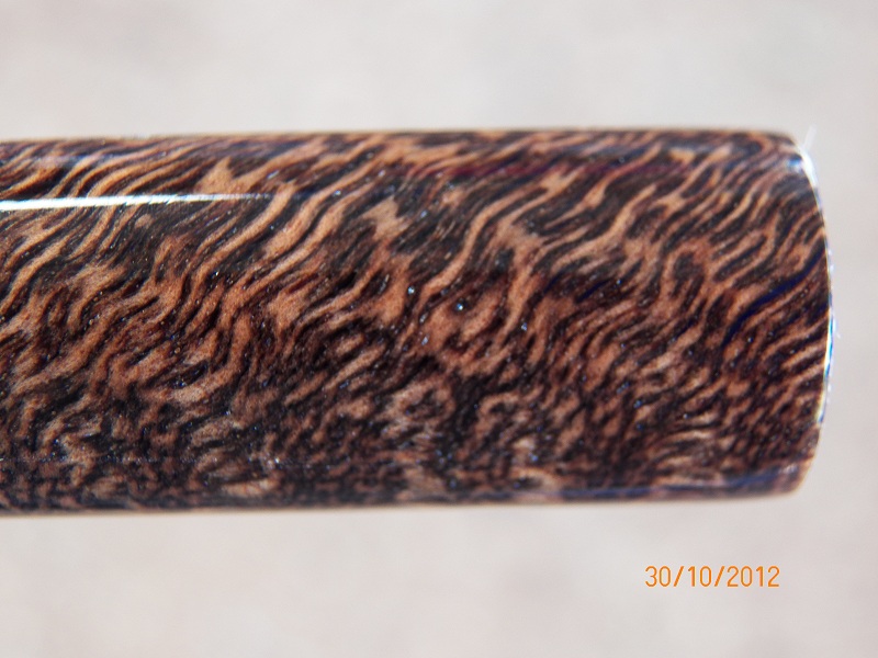

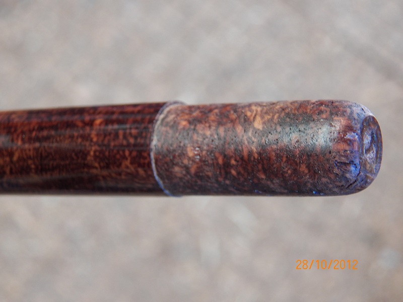

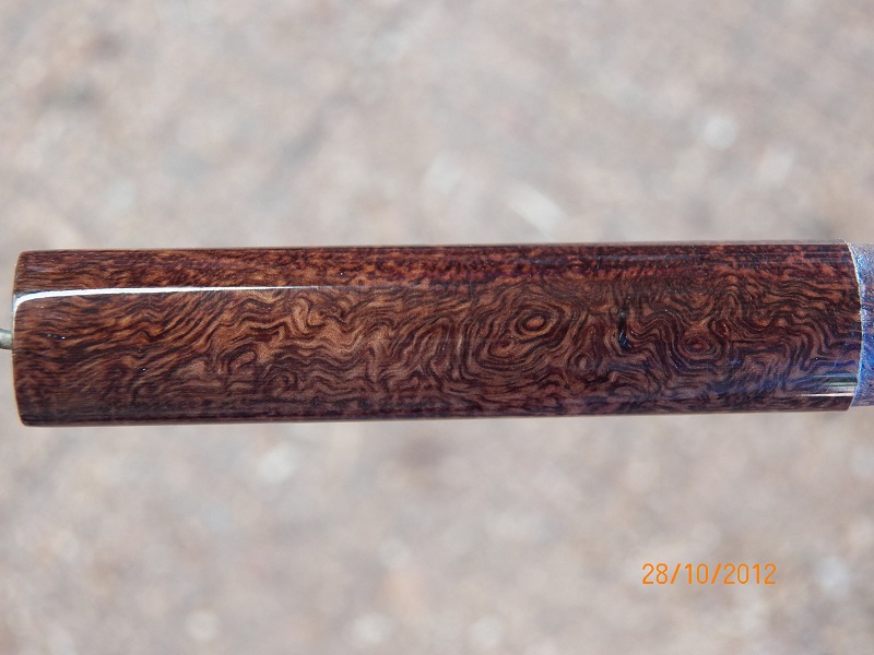

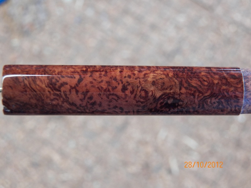

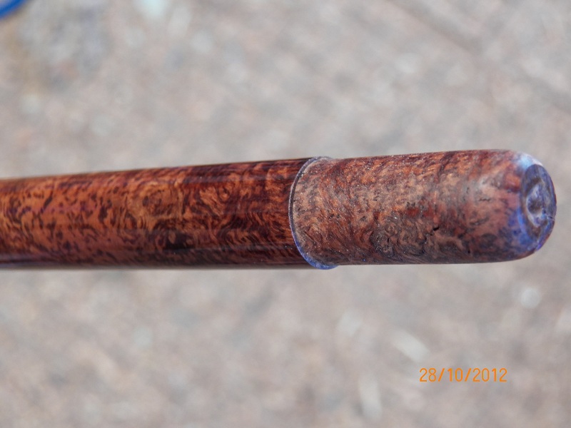

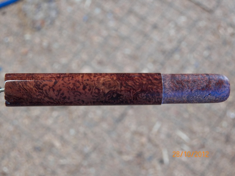

That day has come, with the introduction of the stabilisation system and the Juice from Curtis (Cactus Juice). I have done some others first, and with so many to try stabilising, I got to these Curly Gum root blanks, a few days ago. Filled the vacuum chamber half full with them and, there it went a full gallon of juice to cover them up by 1" or so...!
I had no doubt that, if I had blanks that would drink this juice like is no tomorrow, these would to the bunch, I was correct, after they were done, wasn't much juice in the bottom of the chamber...!:eek::mad:
Got them "cooked" and yesterday I decided to take one for a spin in the lathe and see how they come out.
I couldn't see much from the dry juice crust all over so, sanded both ends and put it in between centres and gave it a good "shave". Well, soft they were once, no more, they are as tough as nuts and cut like butter so after some 240grit sandpaper, I gave it my normal CA finish and the colour and grain popped out quick smart.
The very first though I had when I turned it down, and even before I touched it with the sandpaper was, "CIGAR" it looked like a damn cigar, closest thing ever so, gave it the gloss finish and admired the result outside in the sunshine, stunning stuff that was...!
Keep thinking of a cigar, I though that, the CA gloss finish may be not so suitable to make it look like a cigar, even tough it had the toughest coating/protection so, I put it back in the lathe and decided to remove the CA at one end and expose the raw wood. The only thing I done after was to, soak that end with some drops of very thin CA and wipe it out before the CA dried, this is the result...!
I don't know about you but, anyone that makes cigar pens not pens with cigar kits, I'm yet to see anything better that resembles the true cigar tabaco look...!

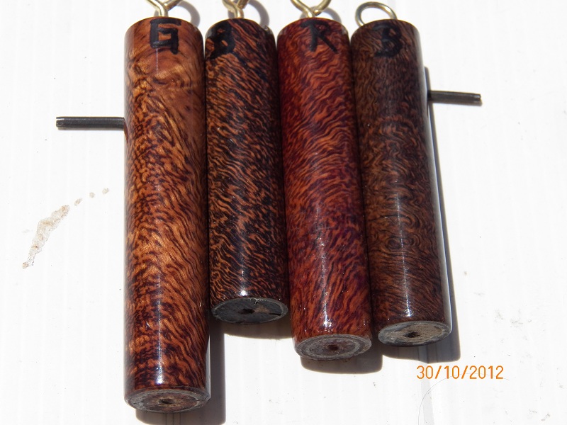

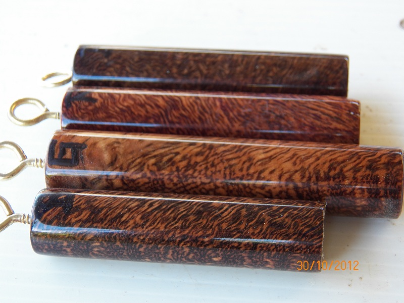

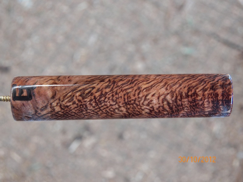

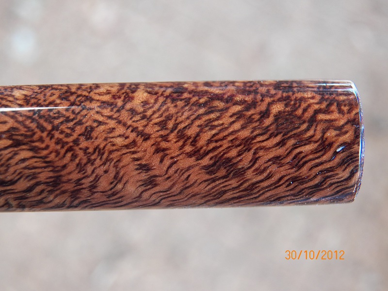

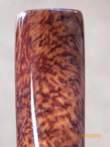

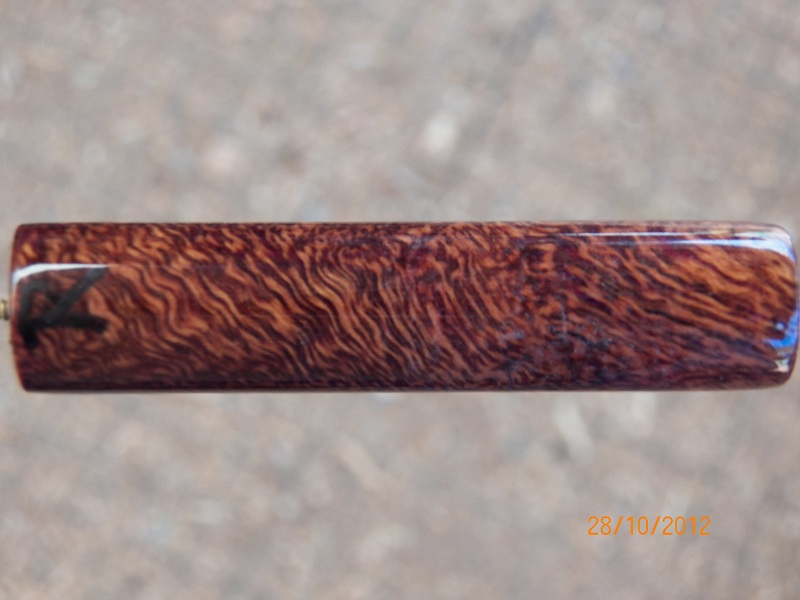

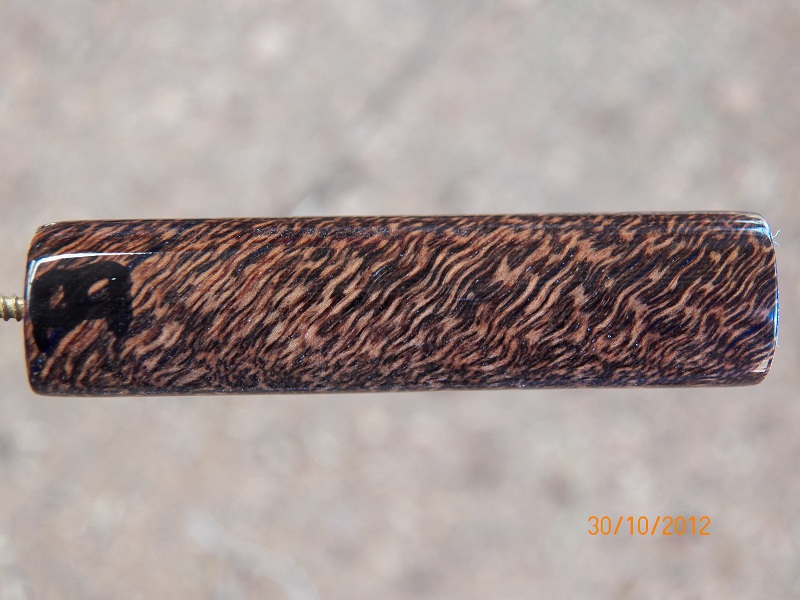

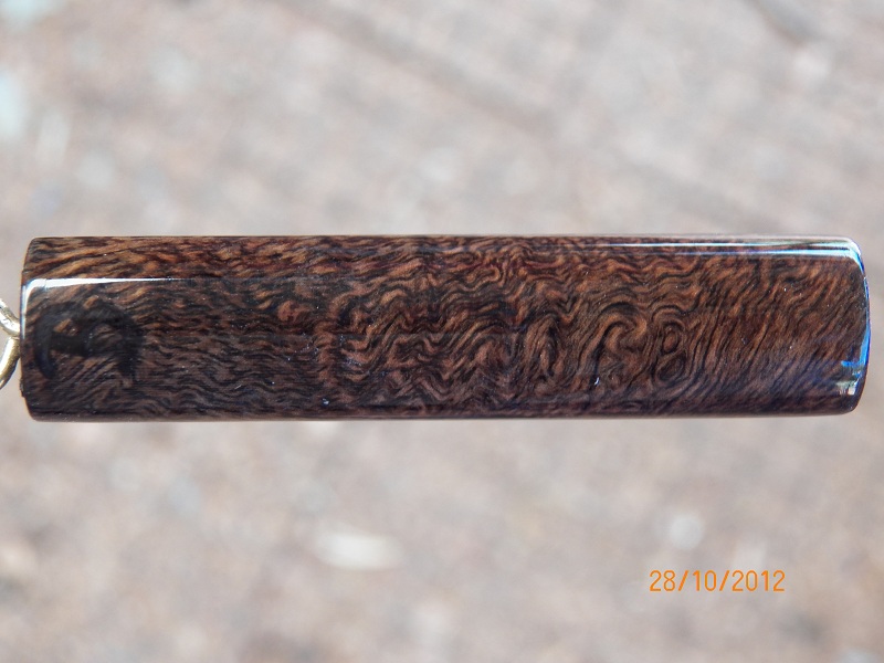

Talking about the "Devil", let me show you the same wood stabilised with 4 dye colours from Curtis, (black, blue, green and red), each blank as a letter in black at one end, that represents the "initial" of the correspondent colour, if isn't obvious, anyway. This was a test to see how much colours this dark wood would show, my suspicions were correct, don't show that much, reason why I used shorts for this test...!:wink:
Here we go...!

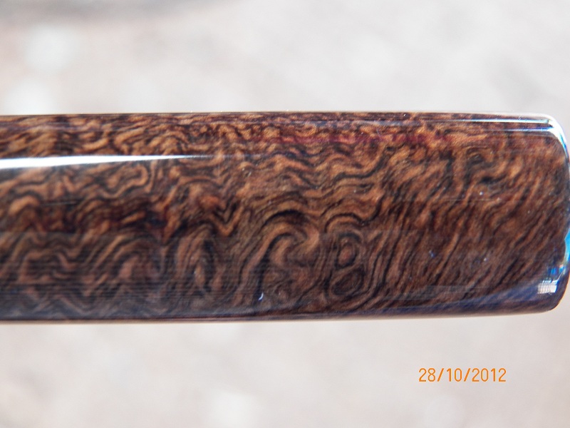

Now, I know that, cigars are not all the same colours and or texture however, with the raw Curly Gum Root wood that I shown here, some shorts bits were stabilised with colour added to see how much colour they would show. The wood been dark to start with, is not the best candidate to show colours but, on the individual samples/pics shown here, there are slight difference in between the 4 tests.
On the pics attached, I put the 4 samples together to allow a better comparative option to the differences resulting...!
What would be your favourite colour, including the raw/natural colour one, on the opening thread...???
