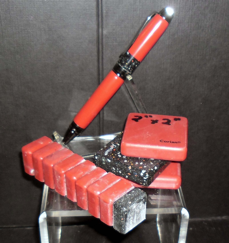

I made these completely out of 2x2's Each pen took 2 and a half 2x2's.

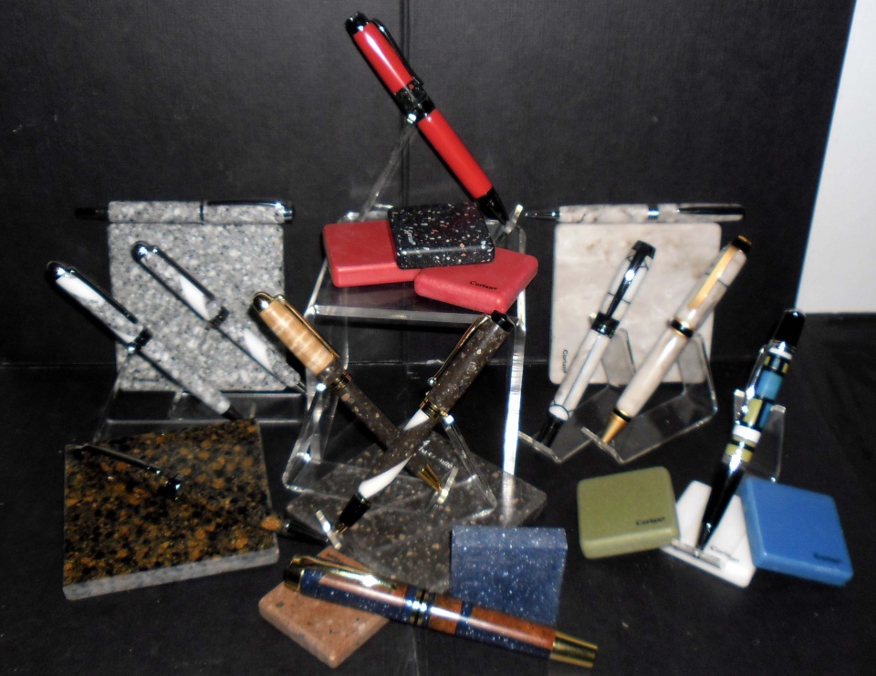

The other photo shows some other pens made with 2x2's and if I down load it correctly the third photo shows how I cut and glued up the pieces for the pens

Corian is 1/2" thick....I'm guessing the squares were cut down to 7/8"x7/8" (allowing for blade thickness loss in material) then glued together. That would give you 4 pieces out of one 2x2 which should be 2" thick now.
It takes one 2x2 for the top and one for the bottom and then one more 1/4" of a 2x2 usually in an accent piece. each piece is 1/2" thick.
Since the solid colors still have dye lots it is best to use all 4 pieces from one together for the top and all of the pieces from another from the bottom then the accent for the middle.
It is important especially for solid colors to have about a 600 g finish. any rougher and the seam will show up as white.
I stack the pieces front to back front to back etc...
The backs sometimes have a bumpy surface and this needs to be rubbed on a 600 g sand paper until totally smooth. The fronts sometimes are actually too slick and so I have been using 600g on the fronts also.
I then used denatured alcohol to clean the surfaces and medium CA glue with gloves on to glue the pieces together.
Glue 2 pieces at a time ONLY and use clamps. Then continue ONLY having ONE wet seam at a time.
I like to leave then dry overnight before using.
I use 5 minute epoxy to glue in the brass tubes. After turning the blanks, champher the inside of the brass tube. I use a counter sink I keep just for corian blanks.
This helps because like Tru Stone, Corian does not move and this help ease the pen parts together.
I hope I answered all your questions. Feel free to e-mail me if you have any other.

check out the last photo
The Blue one has an accent of Nocturne black corian and the last one has guitar pic material and an accent of Cirrus white corian

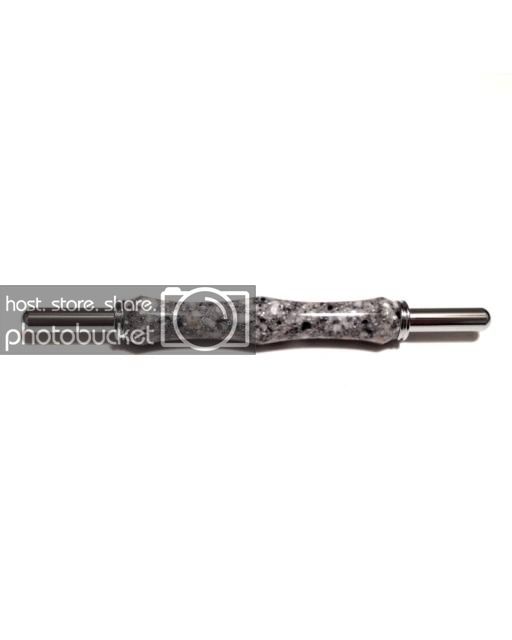

Thanks again for the info on how you do a seamless glue-up. I tried doing the glue-up the way you outlined and am very happy with the results. The shop I work in has been doing a lot of Corian lately so I was able to score some scraps. This piece is called Platinum and is 2-5"x1"x1/2" pieces glued together.
