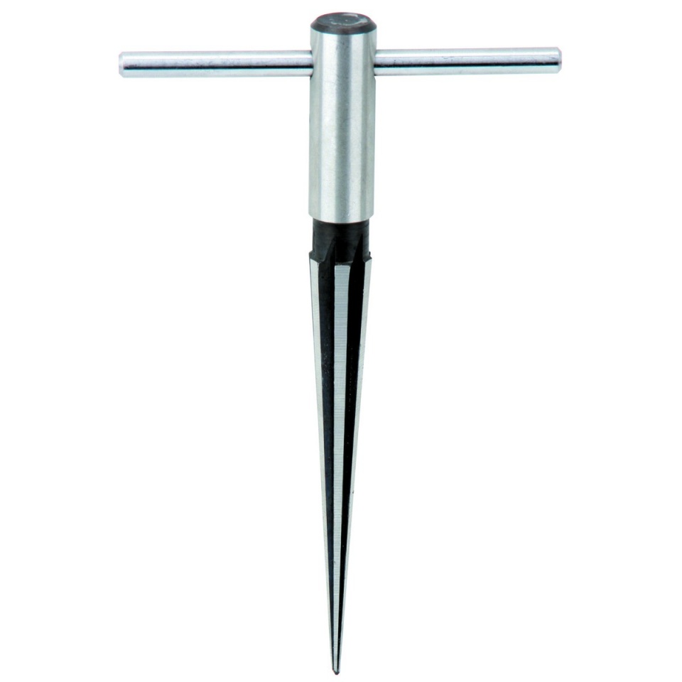

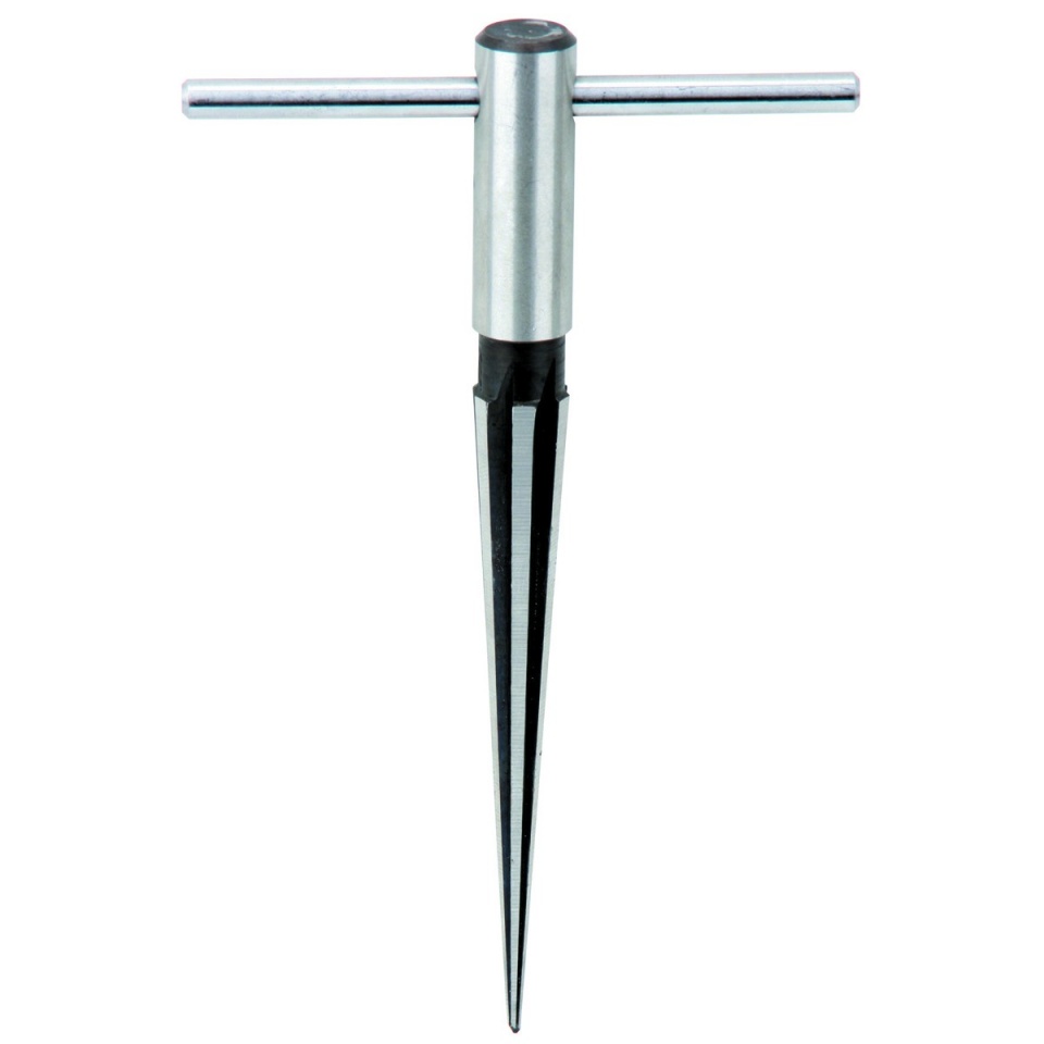

I've had similar a problem with Majestic Squires. My fix was to remove the transmission and take a long taper reamer and sooty out the place the transmission threads into the pen. After a couple twists of the reamer by hand, smooth as butter.
