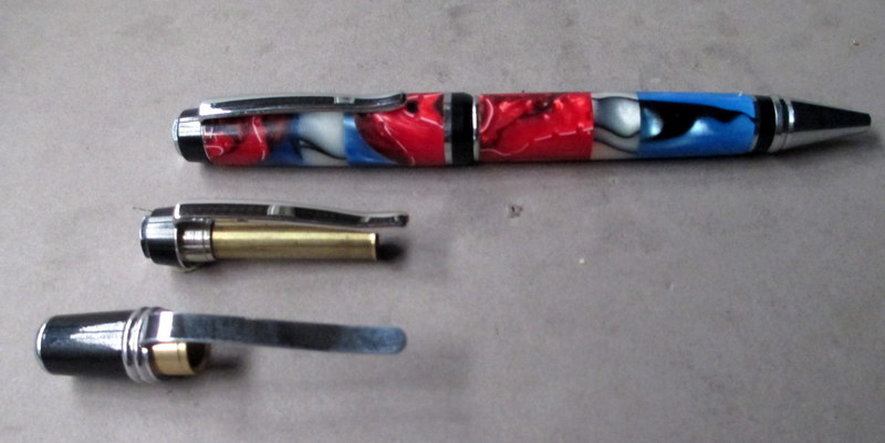

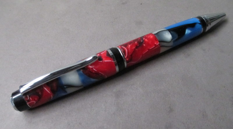

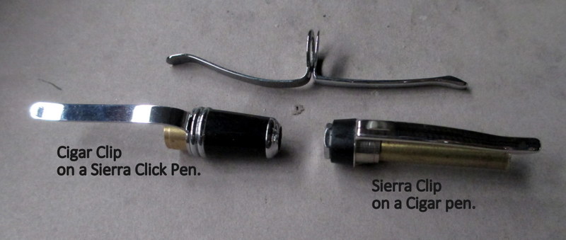

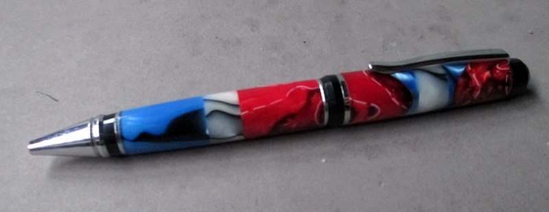

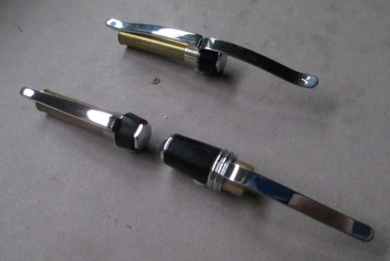

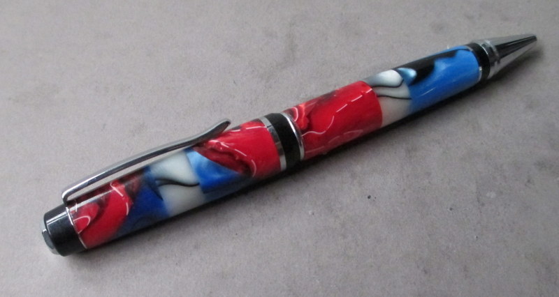

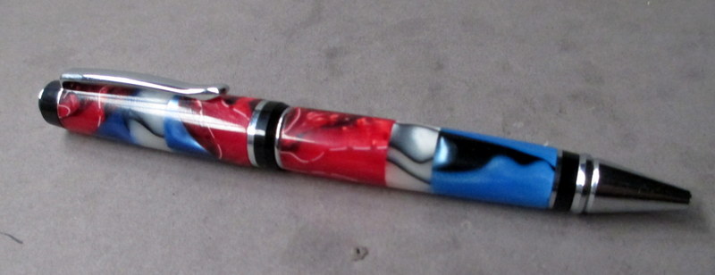

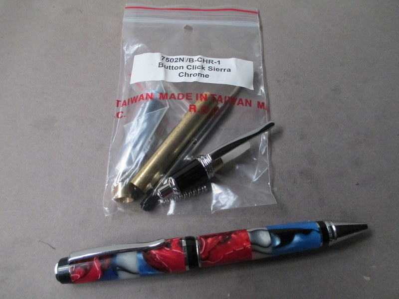

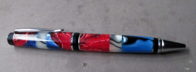

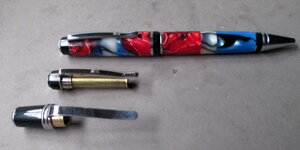

I went thru most of my clips today and found the Sierra click to be the better fit without any alterations,and it has no sharp edges! also you can swap over the Cigar clip and use it on the Sierra. here's some photos.

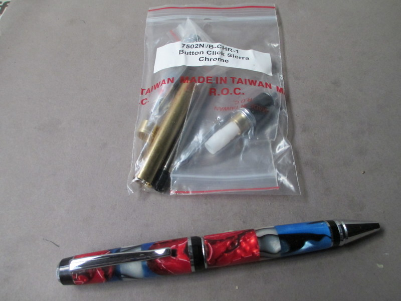

This is perfect...I'm glad I asked! I don't have any Magnum kits, but have plenty of Sierra Clicks. I think I'll offer him that option since I believe the Ultra-Cigar clip will look a little odd on a regular cigar kit.

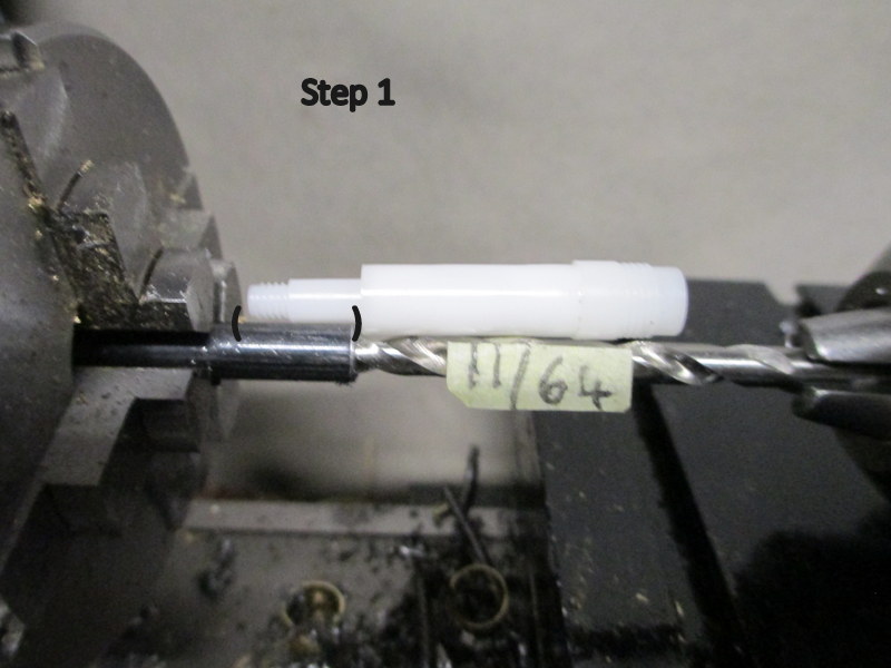

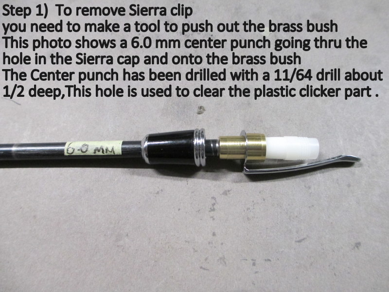

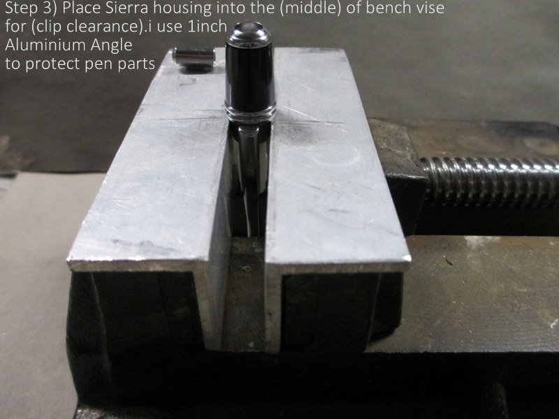

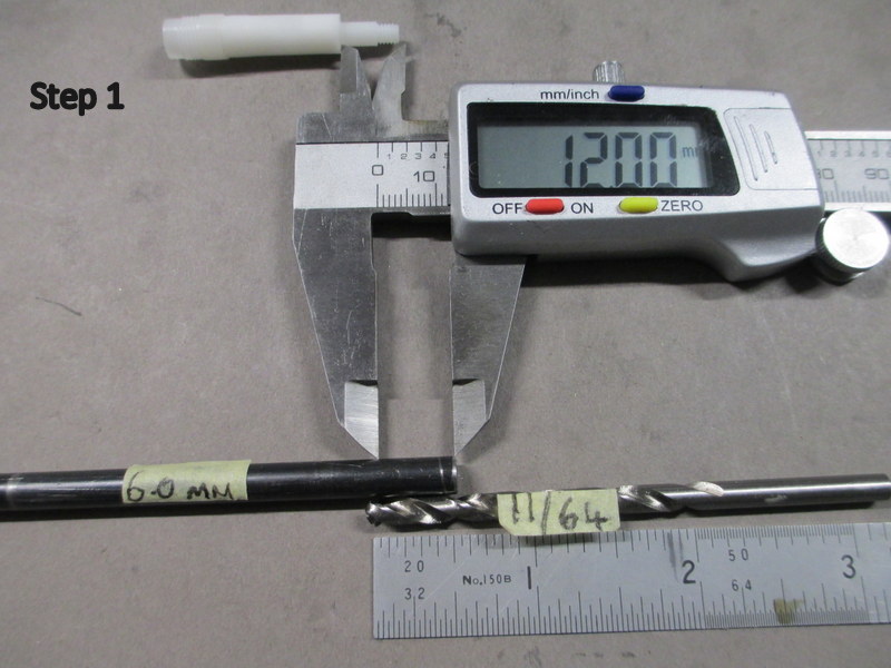

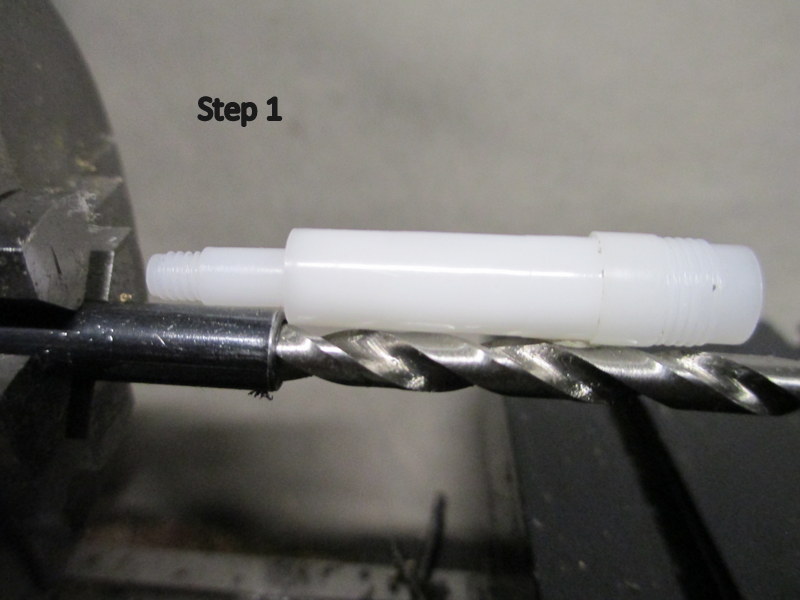

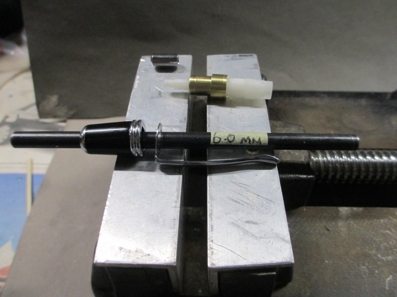

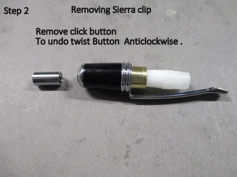

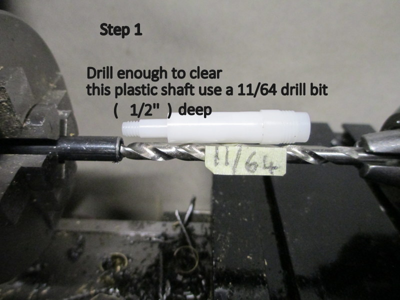

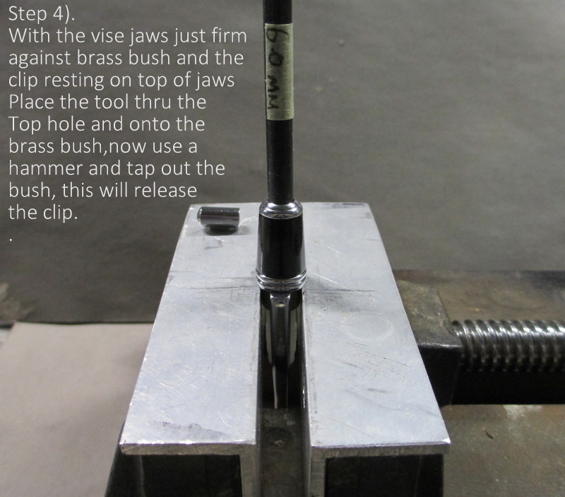

This is how to i remove the Sierra Clip using a 6.0mm Center punch i drilled the flat end of the center punch,the pointed end is hardened so stick to the flat end.in other posts ive used old pen trimming shaft's, this is another way to skin a cat.:biggrin:

I just got a chance to try John's clip removal process today. The plastic clicker part of my Sierra Button Click looked a little different than the one in john's photo...different venders??? Anyway, when I screwed of the brass cap the plastic clicker fell out on its own. So I did not need to go through the step of making the modified punch tool. I secured the cap with the clip in my wooden vice, and used the punch to tap out the brass bushing, and the clip came loose as John promised. Now on to making a new Corian stars & stripes pen and seeing if I can entice my customer into buying it.
