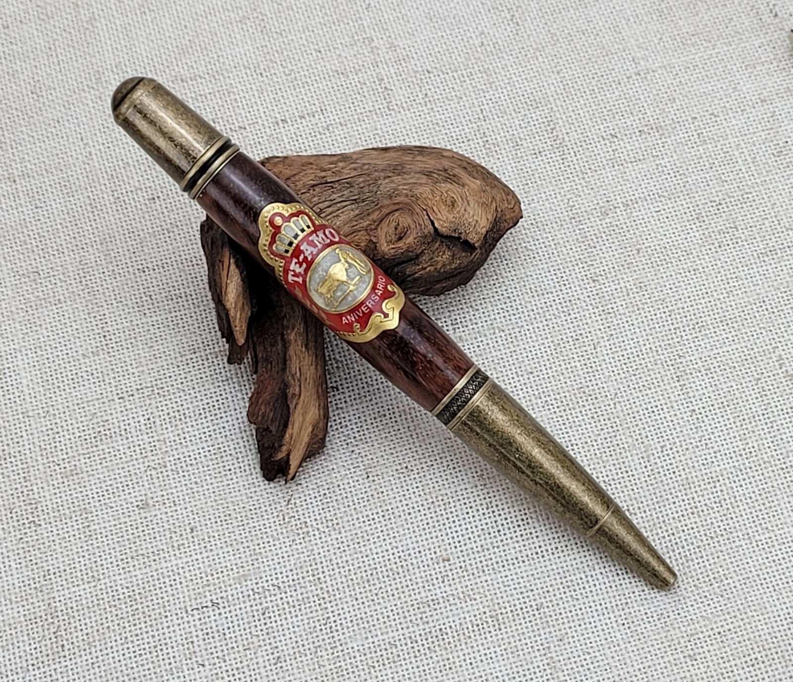

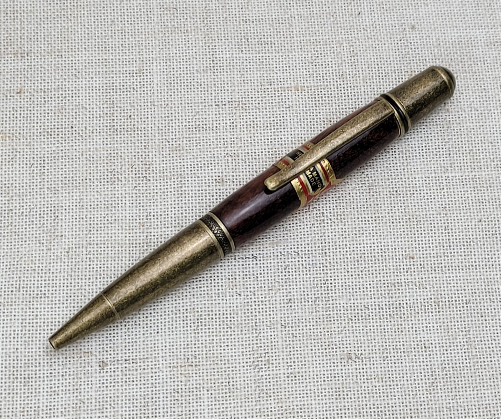

This is a new thing for me. A friend gave me a box of cigar labels so you will see more eventually, but this was the first. The label makes it a perfect anniversary gift for someone who enjoys cigars. I think I need to practice a bit with placing them to get the ends of the band to match up, though I forced this one to work pretty well. The pen is a monarch from Turner's Warehouse and the wood is Granadillo, so there's a little chatoyance (which, of course, you cannot see in the pictures). I left the finish au natural after losing count of how many layers of medium Glu-Boost I used, with a couple additional layers of thin over it. It leaves a nice tactile finish. I really didn't feel like putting that much CA on and then evening it out, and I rather like the feel of it as it is.

Really nice pen, Todd. I like the use of Granadillo - very 'cigar-like'. For the labels, what I do is dry-fit the entire label and then cut one end to ensure a tight fit. I wrap the cut end under the other to give it a finished look. I use 3M Super 77 to adhere the label to the wood.
That's basically what I did, but I used CA to glue the label on. I quickly learned that that is not a great way to affix it, so thanks for the tip. I'm glad that I started with a basic label rather than some of the really cool ones. Also, Granadillo is one of my favorite woods in general.

I've not done one like this before. Did you turn and finish the wood first, then CA/GluBoost from there?
Yes, that's exactly how I did it. So, the "under layer" of CA was polished, but the CA I put on after the label was glued on is just dried as is. I guess it looks more like a tobacco leaf when it's not perfectly smooth and flat. (That's how I'm justifying my laziness anyway ;) )

A funny thing about that... I made this for a Monarch Grande, but overturned the blank. I ended up just finishing it up and then ordering a regular sized Monarch with the next order to put it on because I wanted it on that exact plating.
