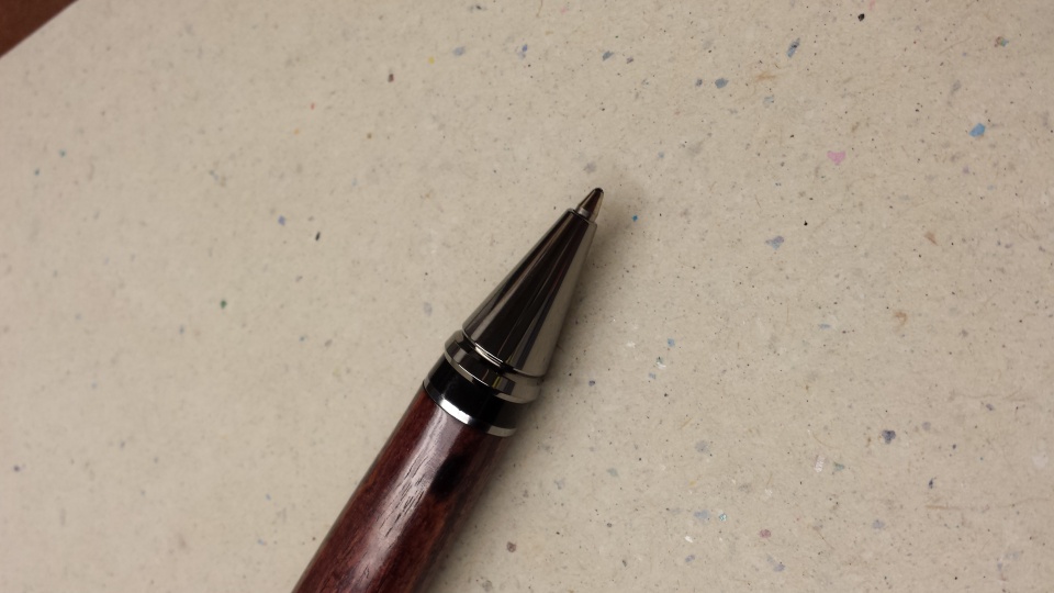

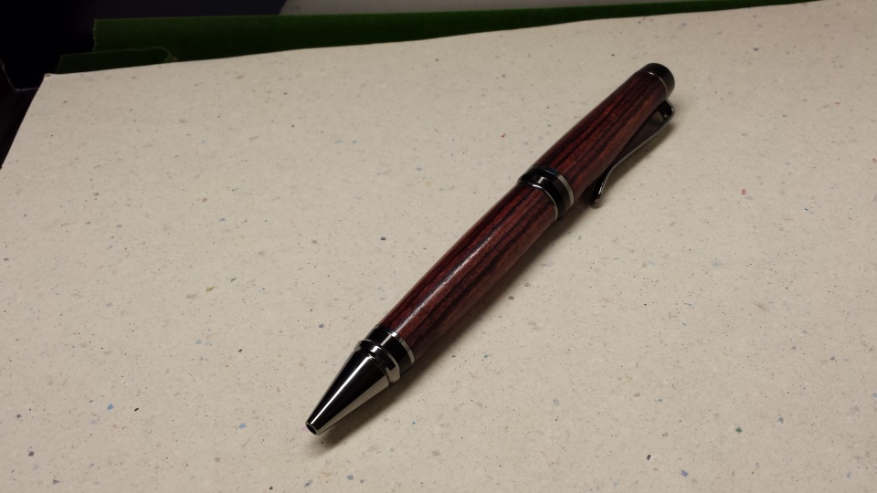

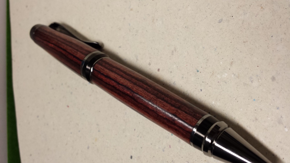

First of all I wanted to thank everyone who responded. I went ahead and finished the pen. It came out great and the tip of the ink is in good position.
This was my 6th pen and first commission and my client was thrilled with the result.
Thanks again and I cant wait to share my journey here. I have learned so much from everyone already!
