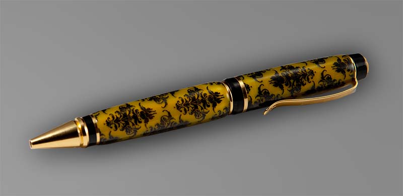

Here's a cigar with a cast carved core. Tubes cast in yellow resin, turned to 0.435 cylinders, carved, carved areas painted black, cast in clear resin, turned to final shape.
I wanted the carved area to appear to be floating in the pen, so I mixed the yellow resin to be very slightly translucent to pick up a shadow off the tube. Since the base resin was yellow, I didn't color the brass tubes. Next time I would probably paint the tubes white. It doesn't really show in the picture, but when looking at the pen while turning it you can see the shadow line moving around the carved areas. I think the floating illusion would have been even stronger if I had used a color other than black for the carved areas. The black shadows would have stood out much stronger around a red or turqouise carved area.
All comments (good or otherwise) and questions welcome.
Ed

That my friend, is some talent. I think the carved areas look really nice. You did a good job on casting and turning out a great pen. What did you use to carve with? Must have been a super thin blade, unless you used a dremel or something.

Hi Todd - I used to use a high speed air turbine rotary carver (350,000 rpm). It's a little like the drill a dentist uses. I would create the design on stencil film, apply it to the object and carve. These days I use a DOL (digital ornamental lathe) that I built for myself. It's like a very distant cousin of a cnc lathe. The bit I used on this pen has a 0.003" tip. At the depth I carve (0.005" to 0.01"), that makes the finest line I can cut about 0.007". The clear resin cast around the carved core acts as a weak magnifier, so it probably looks a little bigger.

Such a show off.... I did notice that you have the top section backwards.
Hi edicehouse - Good eye. Not only did I mount the clip end blank backwards when I was turning it to final shape, when I was carving it I used the pattern for the nib end so the pattern rep would have been off across the band even if I didn't turn it backwards. I was doing the carving at 3 in the morning so maybe I have an excuse for goofing there, but I have no excuse for mounting the blank backwards.
When I showed the pen to my wife the first thing she said was "Nice job"...the second thing was "too bad this part is backwards". I tried to make up some artsy fartsy explanation for why I did it that way, but she wasn't buying it.
I'll do better on the next one!! Thanks for the comment.
