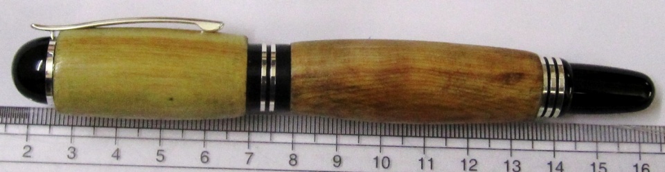

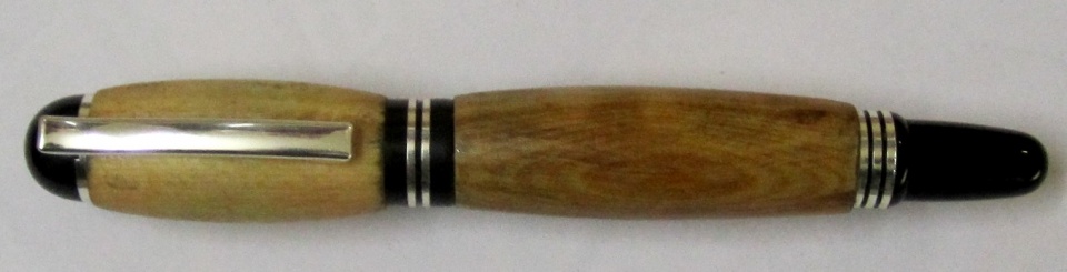

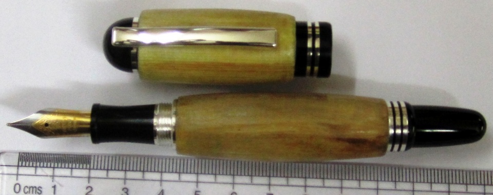

I like the wood.
Is there a reason why you left the wood so much bigger than the ends?
Even if you like the center fatter, it's generally best to fit the ends to the hardware.
Hi Dan,
The wood is pretty glamour-less packing wood, from machinery part crates. normally on ships we incinerate these woods away!
You are absolutely right. I left the ends wider than the hardware because I do not have a lathe at home now. I was not sure if I can make it uniform all around by hand. Later I will do the rounding.

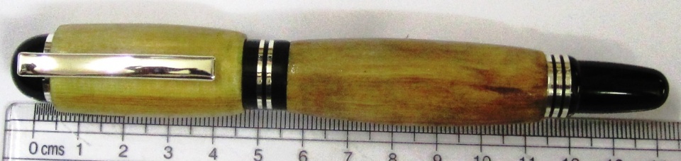

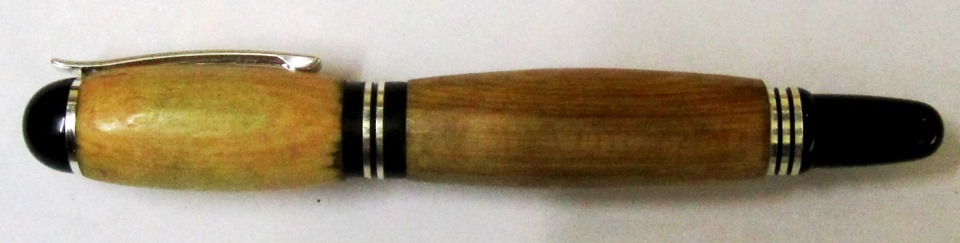

Taking the cue from your advise, I finally summoned up enough courage and dismantled the cap. Sanded the end into a hex shape , then two more hexes on top of that and finally rounded of by sanding. Thanks for your comment, I could do this without having a lathe machine. The barrel too requires a bit of similar treatment , will do that once I have some free time. here are some photos, sure it is closer to what you advised.
Warm regards
Soumitra
Hi Dan, Taking the cue from your advise, I finally summoned up enough courage and dismantled the cap. Sanded the end into a hex shape , then two more hexes on top of that and finally rounded of by sanding. Thanks for your comment, I could do this without having a lathe machine. The barrel too requires a bit of similar treatment , will do that once I have some free time. here are some photos, sure it is closer to what you advised. Warm regards Soumitra
More importantly, do you like it better? It doesn't matter as much what I think. You are the creator.
I like it
Sure I do. Actually have tried to re-do same on some earlier pens, the only problem is that of the ocassional chipped egdes repaired by CA and wood dust gives a colour mismatch problem. Have started to make the job in one step only for the new ones and generally trying to ignore 7 live with the older shortfalls!!
