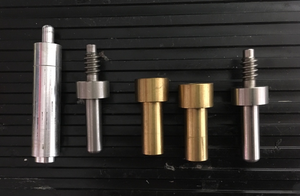

I'm using a Nova G3. What jaws do I order for chucking these drivers. Diameter is .625. Thanks

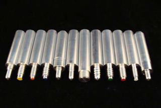

I gave wrong info. Need to chuck up to 5/8"
MY reference still holds, buy the beall er32 chuck, then go on ebay and buy an er32 collet set or you can get one from amazon.
