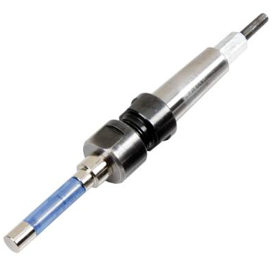

PSI offers the Big Grabber closed end/expanding mandrel.

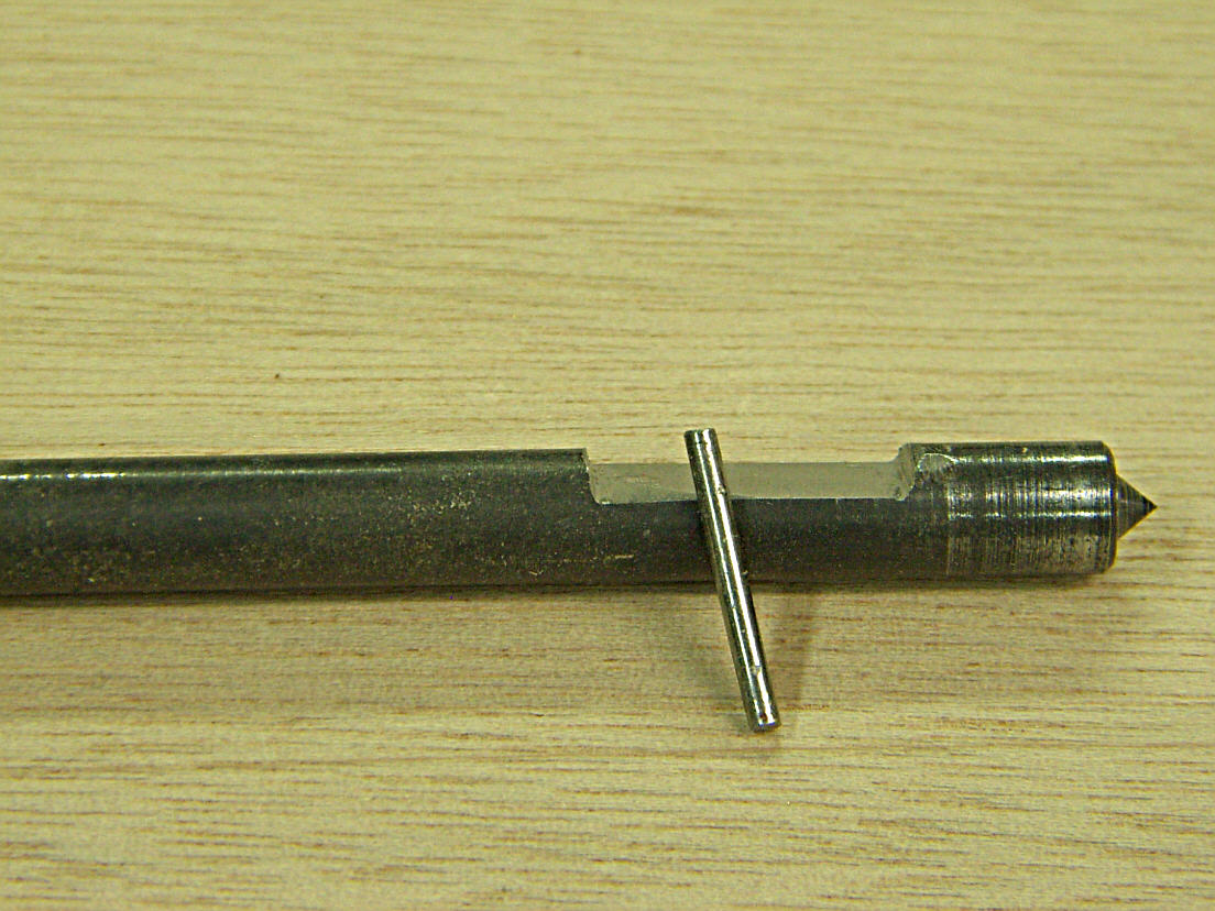

As to pin chucks - I made my own from a length of aluminum rod stock that I machined down to slip inside the tube of the pen I was making. You can machine aluminum on a wood lathe if you are patient and take your time. Carbide tools actually work better than HSS. After turning it to the proper diameter, file a flat on one side that is deep enough for the pin to fit between the flat and the outer diameter when it is placed at the center of the flat - that way, as the mandrel rotates, the pin will roll to the side and wedge between the surface of the flat and the inside of the pen tube, locking the pen blank to the mandrel. You can use a nail (cut off the head so that the diameter is uniform) or a length of coat-hanger wire for the pin - make several because they tend to get lost in the shavings under the lathe - DAMHIKT. Because it's merely a rod, you can mount it using either a scroll chuck or a collet chuck.

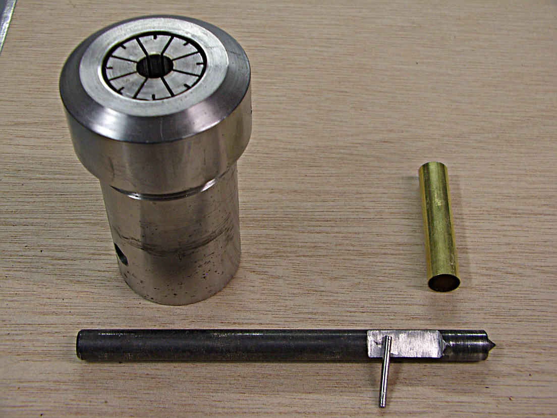

Pin chucks are easy to make. I make my own from transfer punches I buy from Harbor Freight. The set is so inexpensive I have about 3 or 4 sets around the shop for various reasons. Here is a photo of mine. The pin is a finishing nail with the head cut off. I can make any size I need.

Looking at this thread again and need to know what is the collet chuck in JohnT.'s last photo called...formal name.
It's called a collet chuck. The chuck in John's picture is different from the PSI and CSUSA version - on theirs, the collet nut is knurled, while John's is smooth. Otherwise, they are the same. Here's the picture from the PSI web site (less the 'tommy bars' used to tighten the retaining nut).
