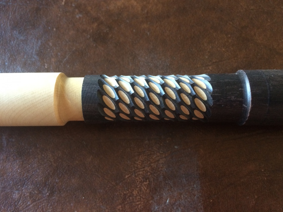

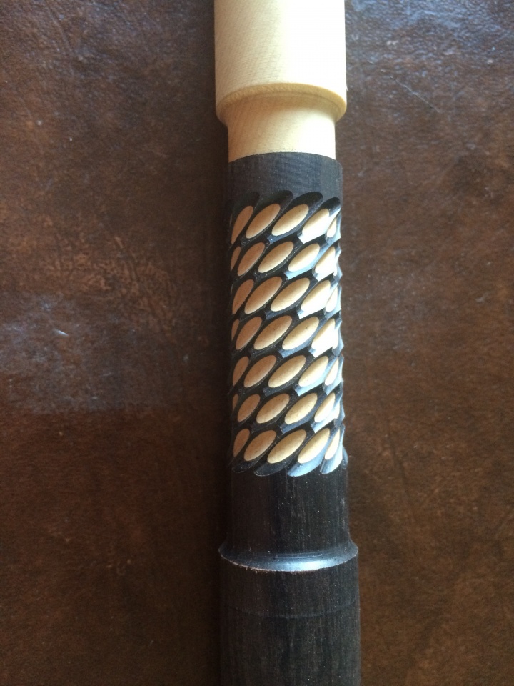

Oh, John, if you only knew :smile: ... take a look at some ornamental turning. There are wood lathes from 200 years ago that maintain runout and concentricity below .001" I know, I have one or two of them. Just as an example of what I'm doing in that realm is captured in the picture (the vertical picture). It's an experiment I did to see if I could make a barrel out of two different kinds of wood (boxwood and blackwood) where the "ornamental" cuts were precise enough to keep a perfectly (!) consistent pattern across and around the barrel. First of all, the two pieces had to be concentric to about .001 and then runout had to be around .001 and no more. These figures had to be attained because of the shallow cuts into both layers. Runout greater than .001 could get magnified ten-fold and that error became an easily visible departure from the uniform pattern I wanted. This piece is a reject because on the other side (the horizontal picture) you can see that the "holes" are different sized. This is all done on "wood" equipment, not metal lathes. This kind of precision decoration in wood is prevalent in the ornamental wood turning world.
Granted, the typical wood lathe that a lot of turners use is incapable of this kind of precision and repeatability but all I would say is that good machining practices and approaches will keep one's work product near the limits of what the machine can do instead of further afield. It's so easy to make the machine operate worse than designed and built.
