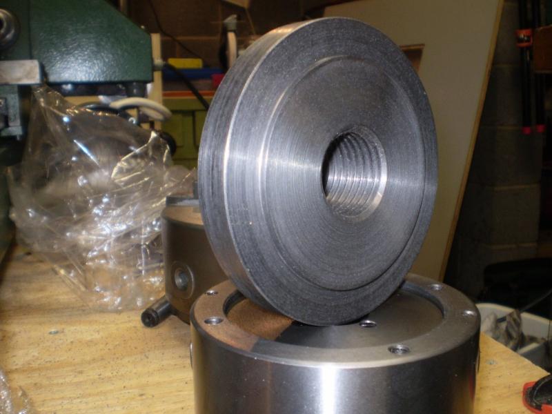

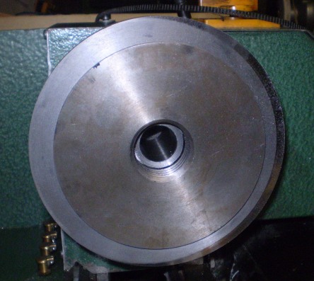

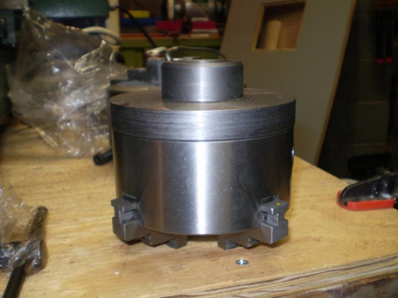

I finally got my metal lathe up and running. Turning square stock to round requires a 4 jaw chuck and the independent adjustable jaws was just too much work (later i found out it was busted.) So I bought a self centering 4jaw. I also had to buy an adapter plate. These are blanks, you have to turn and face to fit your new chuck. Well I generally consider myself a wood turner, now I have to turn metal...feel the adrenalin pump through my head. Lot of reading and questions with alot of help from members of this community, especially Joe S., I have succeded in turning this blank to fit my new chuck. Turning cast is a dirty job, there are no curls of metal, just smelly grit. The next big hurdle is to drill holes in blank to secure chuck.

Having done something similar, I know what you went through! Well done, looks like a great turning job. Now for those holes..........
Did you use HSS or carbide on the cast iron?
BTW, what size metal lathe do you have?
Paul,
Good to know about the ways, it would be like 30 grit sandpaper wouldn't it?

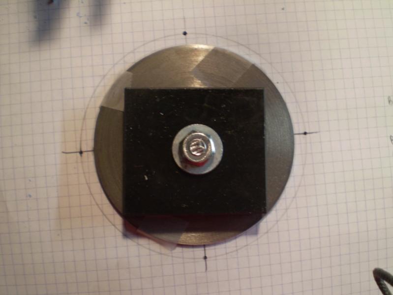

I tried this for the holes: draw cross (perpendicular lines) then draw 2 circles. one for registration boss and the next for the bolt diameter. Cut out inner circle and tape to adapter plate. Punch where cross meets circle and wallah!....too bad I used a drill bit that gave me no room to wiggle. Now I have to enlarge 2 holes, but not to bad for an amateur.

Thanks to all for the help and encouragement. One day i'll post a pen
