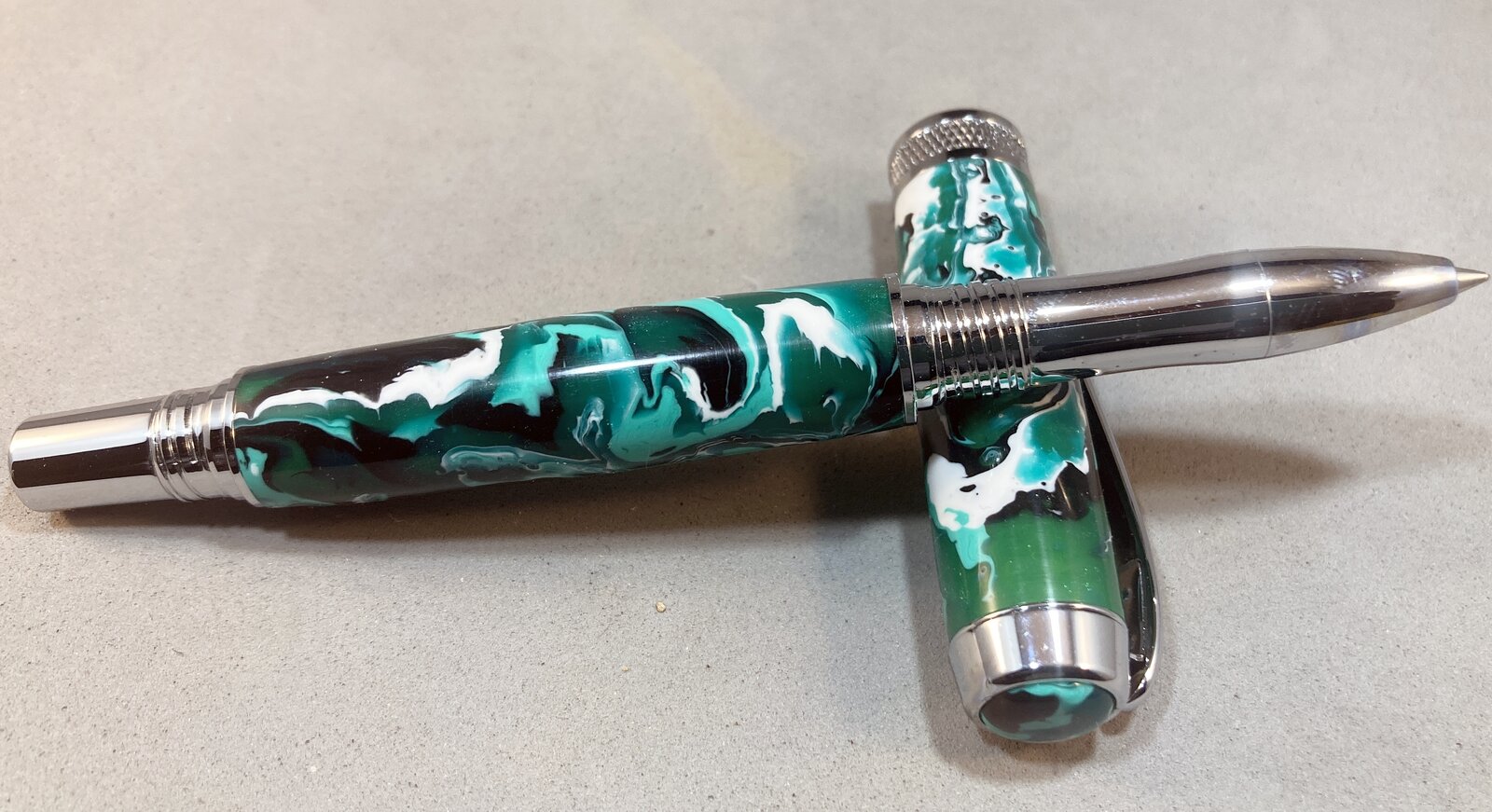

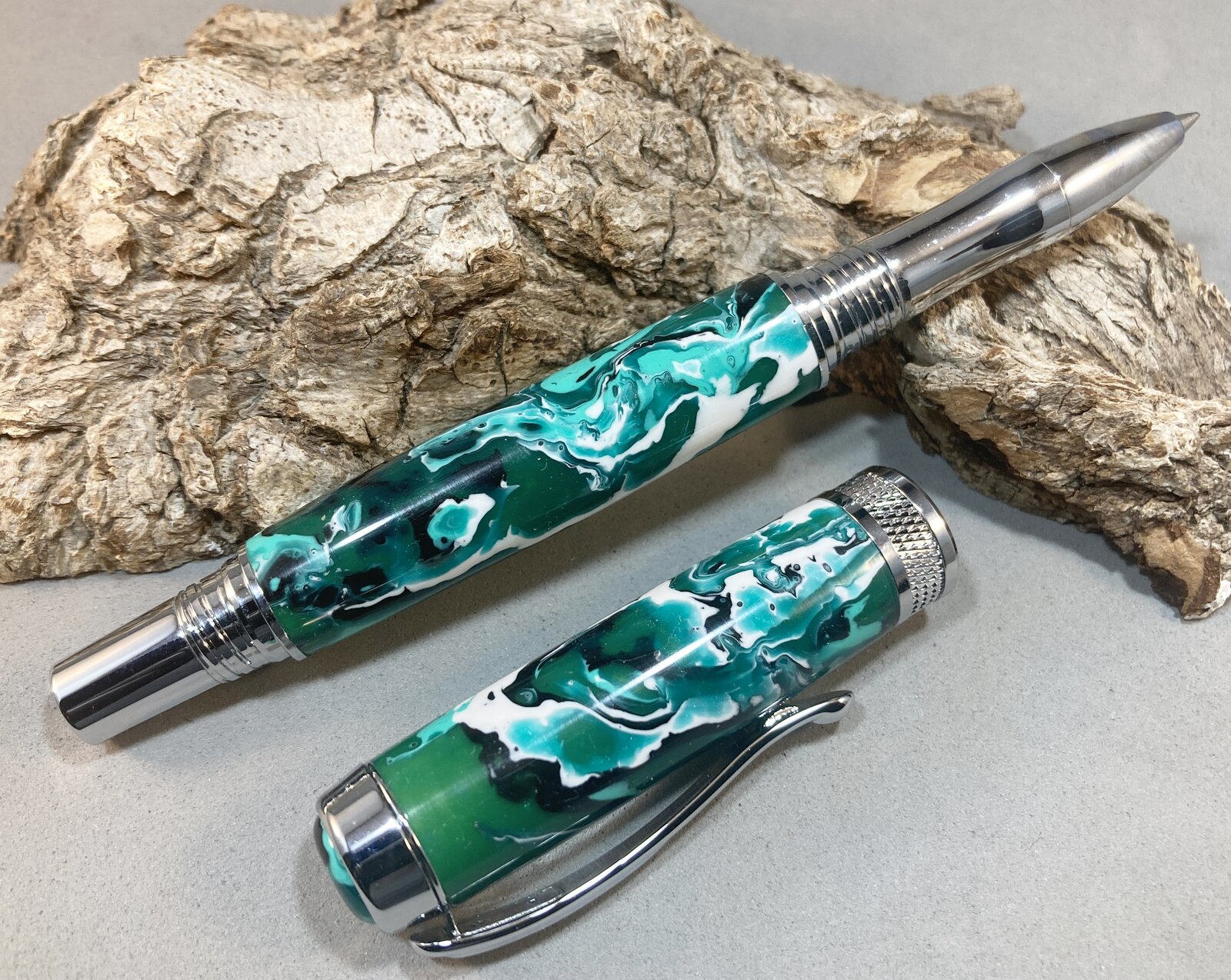

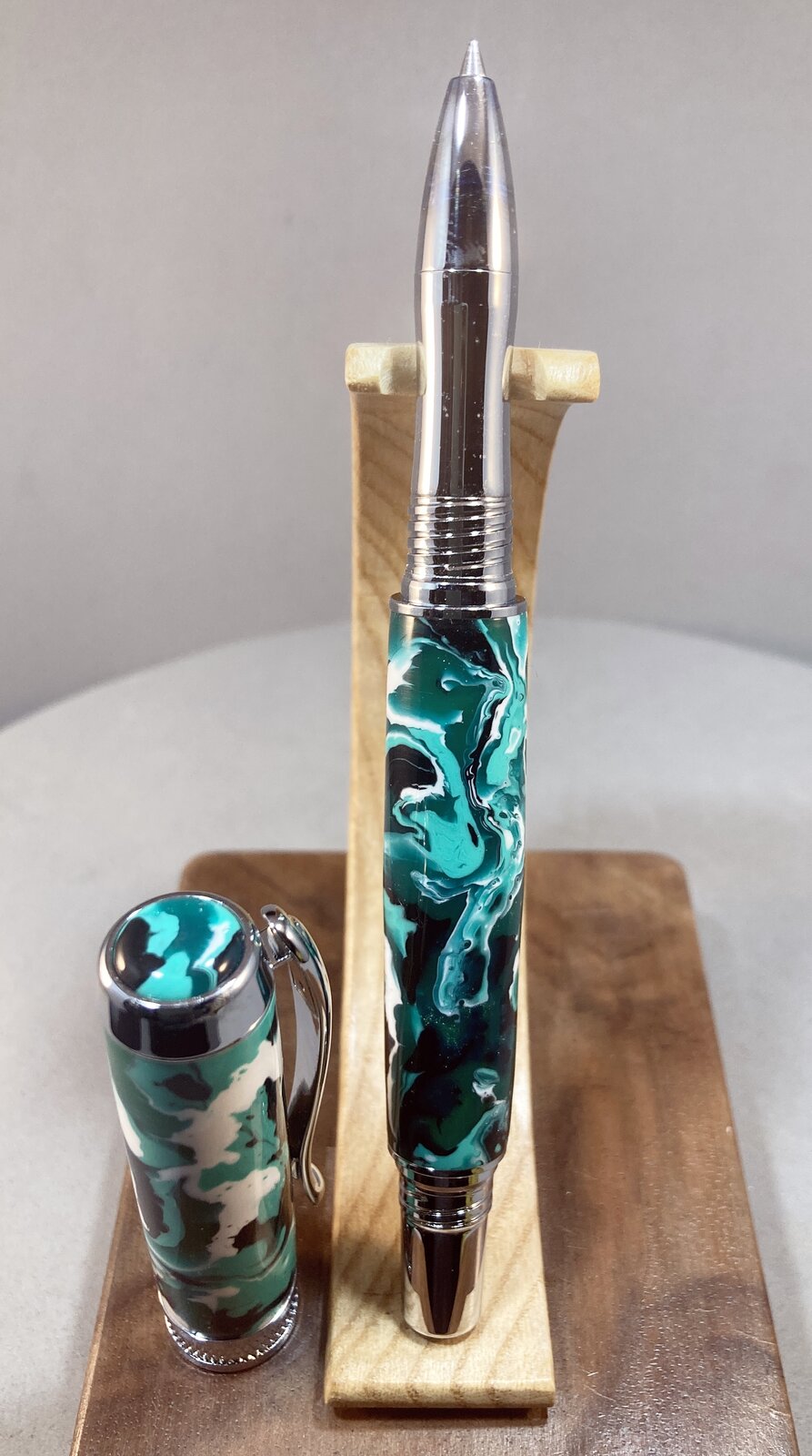

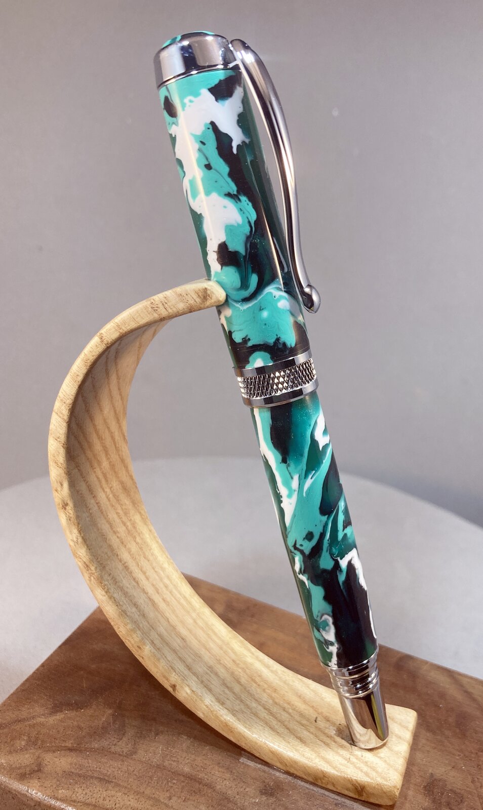

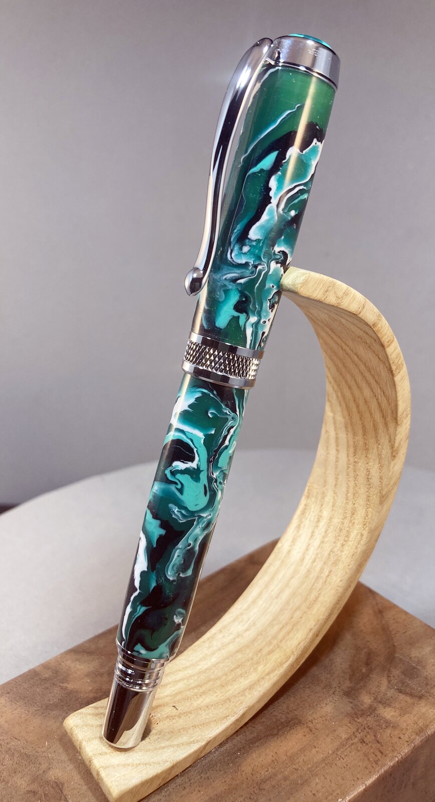

I haven't posted a pen in a while. With it so cold outside (-12F earlier today, with -35F wind chill), I am trying to get more shop time, although my basement workshop is a balmy 57degrees.
This is a Diamond Knurl Rollerball with a blank I cast in my new Pressure Pot.

Comments/critiques welcome.
Thanks!

Well now, that's a very cool blank. Nice looking pen too, I typically like all the knurled kits.

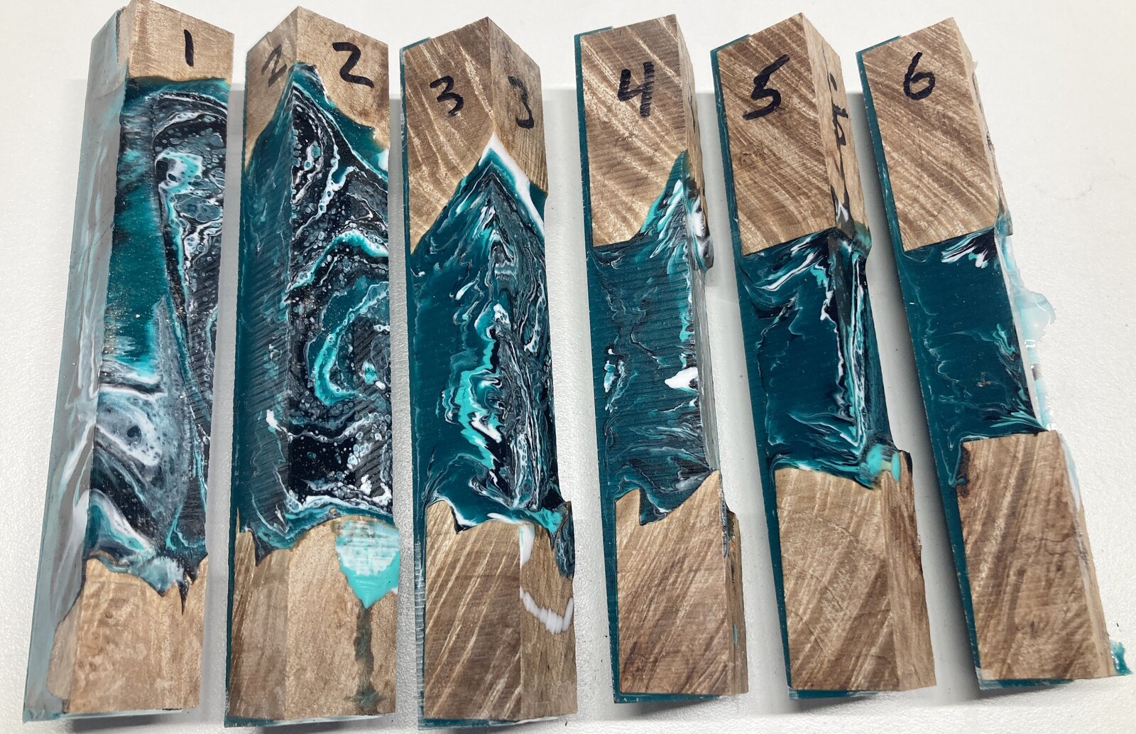

I don't really do anything special - this blank was part of a larger pour that I made for some hybrid blanks:
When I prep resin for the large block mold, I make a little extra of each color and pour a separate mold of individual blanks. I just alternate pouring of each color, and gently swirl the poured resin with a skewer stick to mix the colors. I do try to hold off pouring until the resin is about 100F to get good color separation.
Are you pouring in a block or individual stick molds? They look great, the colors are very nice!
I pour rods.
