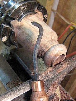

I made mine out of Hex keys also.
You will have to make a handle out of some scrap wood, and make a ferule out of some brass or copper pipe fittings.
I would also strongly advise putting a bend in it to create the swan neck. Heat it with a Mapp gas torch if you have one, otherwise you can use a propane torch, but it takes longer.
If you don't, the right angle tool that catches inside an ornament will have the mechanical advantage on you. I once had one catch and pinched my finger between the rest and the tool.
I leaked quite a bit before I put a bandage over it. :redface:

underdog
Sep 11, 2006
604
Watkinsville, Georgia
Here's what I use:

underdog
Sep 11, 2006
604
Here's what I use:
Looking at your lathe, that is exactly the way I was making mine. What finish do you use one the part that is left once you finish the parting cut?
I don't normally finish the globe/icicle type ornament on the lathe. I put the thing together first, then shoot it with some laquer.
I do, however, make a jam chuck, turn the thing around and sand the backside after parting off. The ornament you see here is the cap of an acorn style birdhouse.
