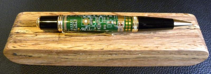

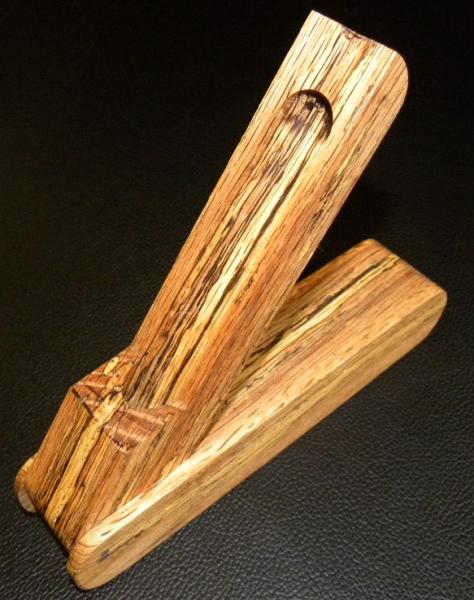

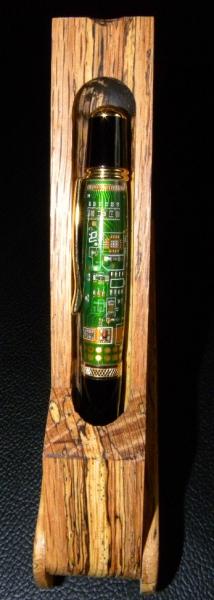

My B-I-L's brother works for IBM, so I thought he may like this as a gift. It was the first circuit board pen I made and was pleased with the way it turned. The box I made after seeing one on the net. It is spalted oak with just an oil finish on it.

When turning one of those (I have a couple still unturned) I assume you have to trust the bushings and the tool does not cut into the graphics?
bmac
Feb 5, 2004
603
Watson, Louisiana, USA.
Thanks for the replies, they are appreciated. It wasn't that bad to turn. I turned the ends down to the bushings and left the middle a lttle fatter. I did stop several times to check to make sure I wasn't getting too close to the circuit board. I bought the blank from Woodcraft but our very own Bruce119 also sells them. Check out the classified section.

Great! my dad is a computer guy, he would love one of those! how do you apply the graphic?
Its an actual circuit board bent around a tube and cast in clear resin. They are very nice to turn. Ive done both in vista and sierra with no problems. Had a lead (or whatever you call them) come through the resin once but touched it with some thin ca and it polished right up.
