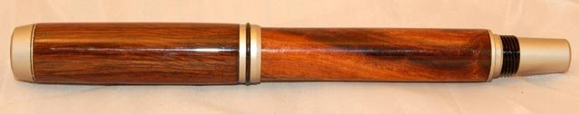

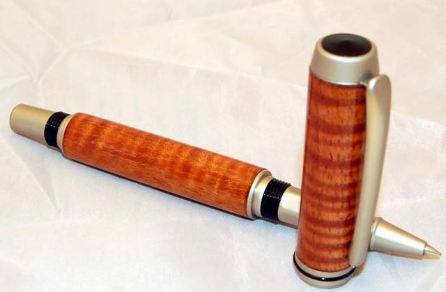

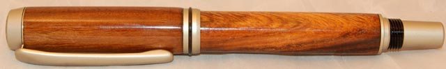

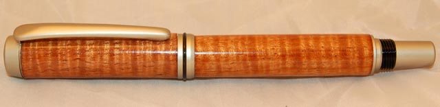

I asked for some Baron kits for Christmas and I got them YAY! I had never put one together before.
Here are a few pics
I have never use Koa before, I think I like it.
and one in Ironwood
Comments and suggestions appreciated

I think most of that on the barrel is CA. I still can't make it look like I want. I always end up with run over onto the bushings, and then end up having to seperate the bushings from the pen. Then I end up with what looks like unfinished ends of the pen. I have tried cleaning it up after, but end up taking off finish on the barrel as well as the end.
I'd just give up on the CA thing and go with friction polish again, but I want the finish to last a while.
Thanks for the suggestions.
