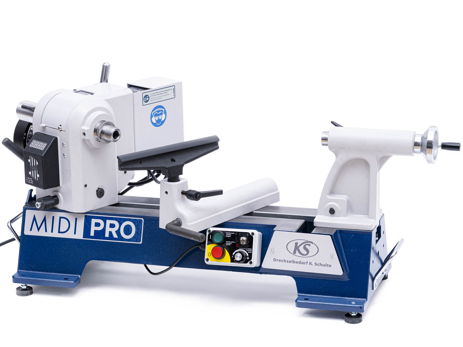

the Metal lathe is a 3.75 ton 600x1000mm VDF 3K beast made 1959. The biggest drawback is its 475 RPM Limit. For short time I can run it faster but with a 315mm chuck and Mk5 Tailstock I think a bit oversized for pen maling. However perfect to make whatever metal tools are needed. The wood lath is a "midi Pro". Here the Link to one German vendor.
I don't want to make any advertisment, only that you get an idea how it looks.

The wood lathe you have looks like a pretty nice one. One thing you could make for it with your metal lathe is a double ended #2 morse taper alignment tool. It will allow you to get the tailstock and headstock aligned especially after swivelling the headstock for larger work. Something like this one for Nova lathes. https://www.teknatool.com/product/nova-acruline-2mt-alignment-lathe-accessory/

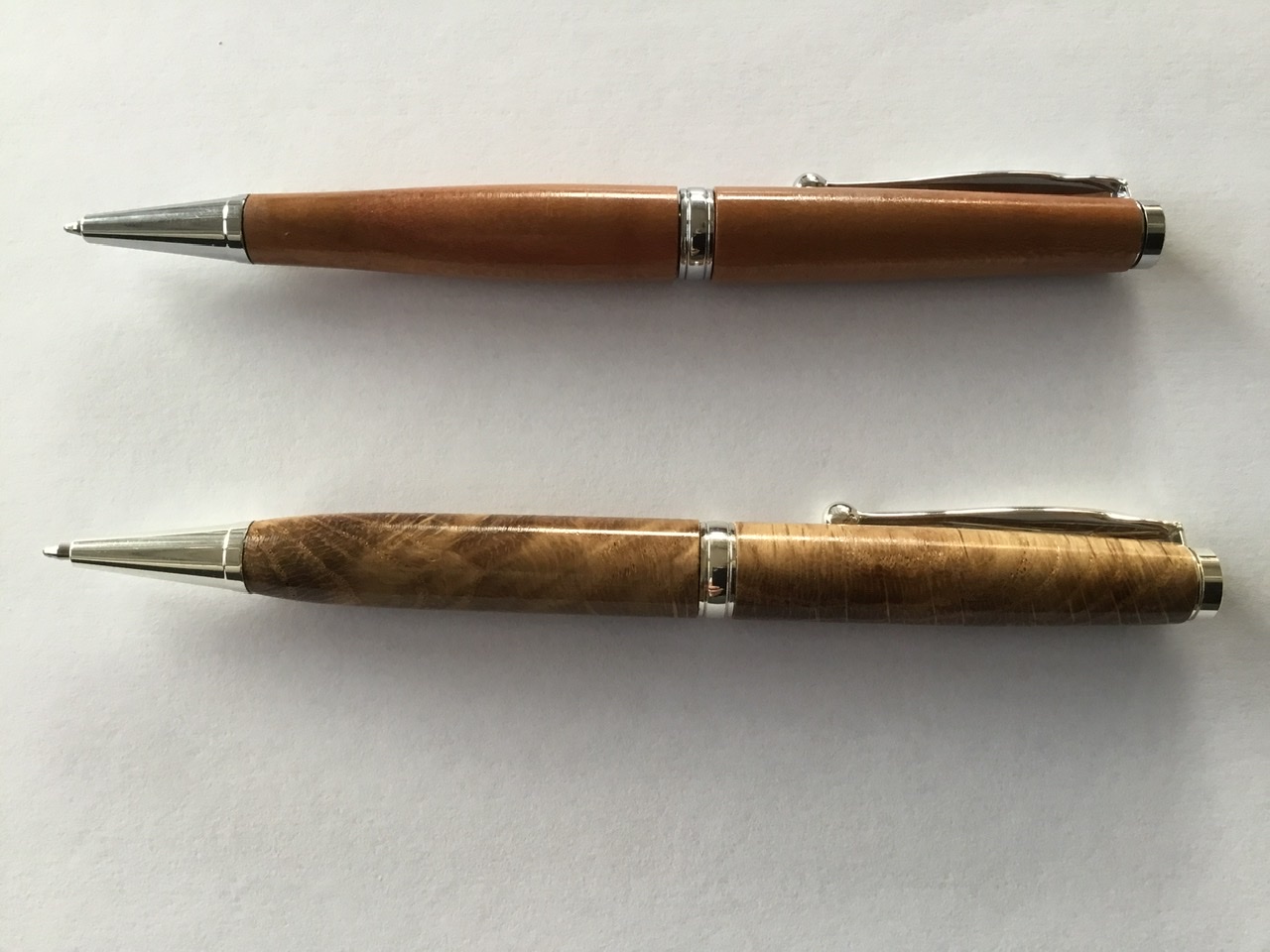

that are my pen #2 and #3 I made in my life. One is cherry and one is oak. TBC and my first CA finish. Any hints, help, critique welcome.

Very nice Christian
And welcome for the UK, now sadly outside of europe !
For the cherry pen perhaps you could taper the body towards the central band more as there looks to be a sharp edge there? It might be the photograph though.

chris_11
Dec 28, 2020
15
Luedinghausen
You are right. This was my #2 and I did measure with callipers turning TBC both parts individual. As a beginner it takes some time until you are comfortable to what dimension to turn.

howsitwork
Jul 9, 2016
2,315
Thirsk
It still looks " sehr gut" to me .

Yes I do the pens on the Midi Pro. But the VDF is nice if you make larger bowls and need to make the wood somehow round first. That is a lot safer than on the Midi with large heavy unbalanced turning pieces. I have still some thread milling project for multistart threads for kitless pens in mind where I plan to use the metal lath for milling the threads with a router motor in the support.
